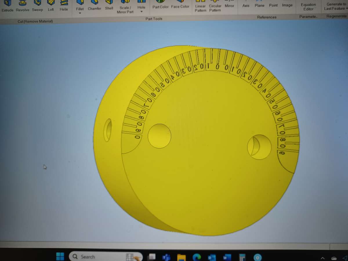

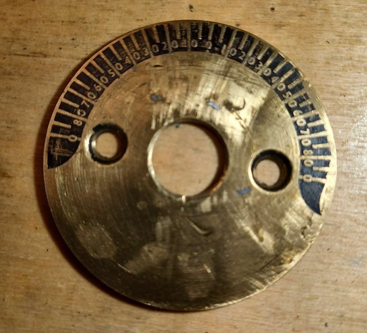

      I am in the process of making a press tool to emboss the numbers and lines in a brass disk which fitts onto an   M Type lathe. It shows the angle of the compound top slide. The part is a thin brass disk 2 inch diamiter and 0.015 inch thick. The press plate will press the area around the numbersand lines leaving them creating a well for black enamel so the characters stand out. the embossing tool only goes in 0.007 deep.
      20250909_080626
      I was going to make it from gauge plate o1 steel and get it hardened and tempered  but wondered if anyone has worked with press tooling and could suggest a diferent steel which may be more suitable.

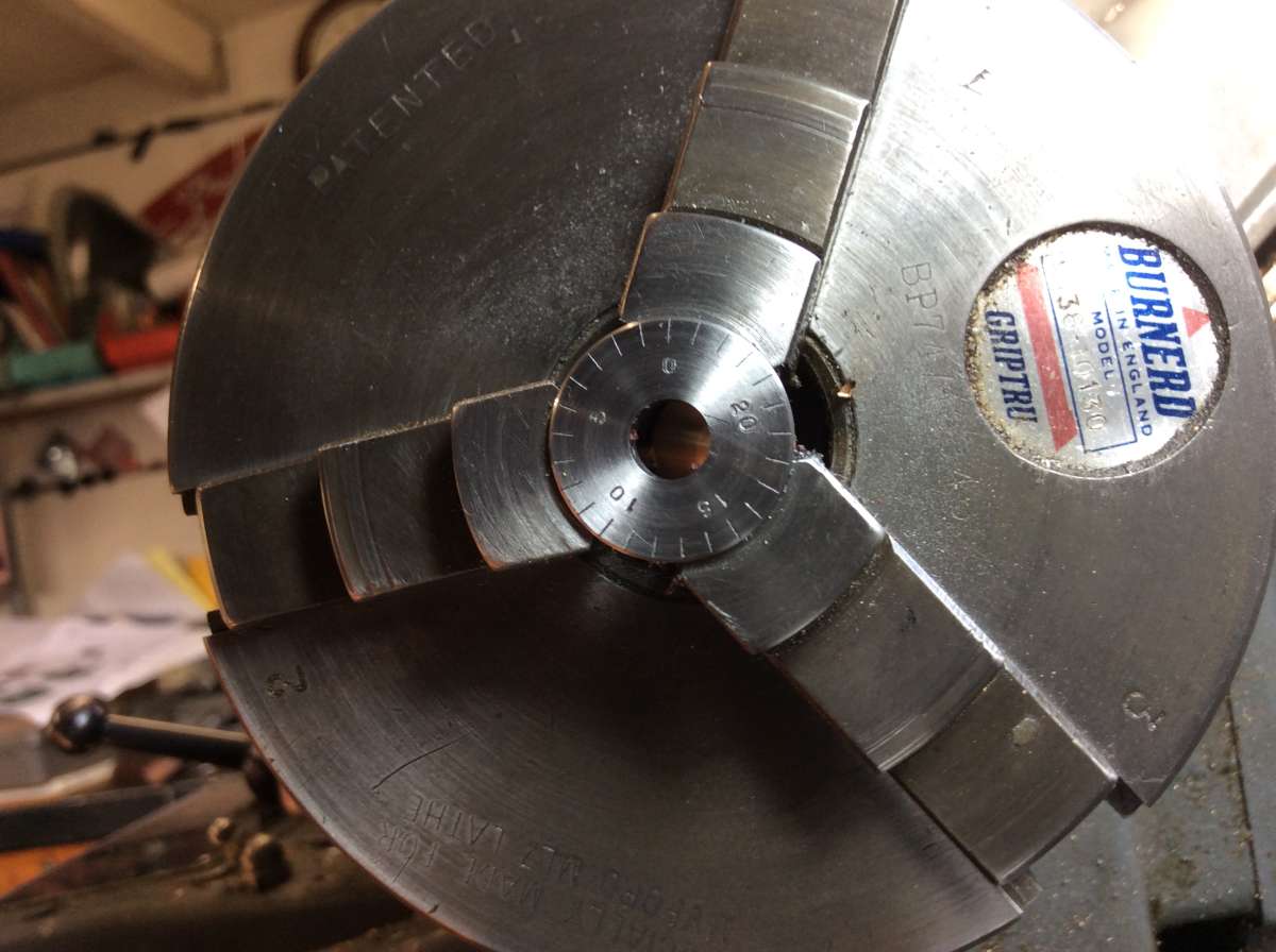

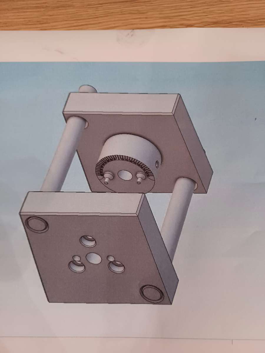

                          This is the piece which fits on to the compound top slide and this is the proposed tool to press them out.
                          20250807_154458b
                          20251021_073510
                          David
                          #820963
                          Tony Pratt 1
                            @tonypratt1
                            On David George 1 Said:
                            Tony Do you have any information on the hardness you used on 01 steel as I have started machining the blanks and arranged for laser cutting of the engaving but I dont want to make it too hard and have it crack or too soft and fail to emboss the brass disk. The die will at the same time cut the outside diamiter, punch the central hole and form two 45 degree pimples for location on countersunk screws.  This is to be used in a fly press.
                            David
                            David, 60 – 62 Rockwell ‘C’ was the usual specified hardness for press tools.
                            Tony

                                I’m not familiar with an ‘M’ type lathe but if the plan is to replicate or make an identical copy of the brass plate in your picture then I suggest creating the depression around the test and index lines by etching.
                                Etching was almost certainly the method by which the original was made.
                                Ian P

                                    #828832
                                    Mick Bailey
                                      @mickbailey28509
                                      I’m a little late to this thread, but  the disk is a good candidate for etching using the ‘toner transfer’ method that’s mainly used for etching PCBs. I’ve used it frequently for nameplates in brass where I want raised lettering and flood-fill the background with paint. The method has excellent repeatabiliy and the outlines are crisp without undercut.

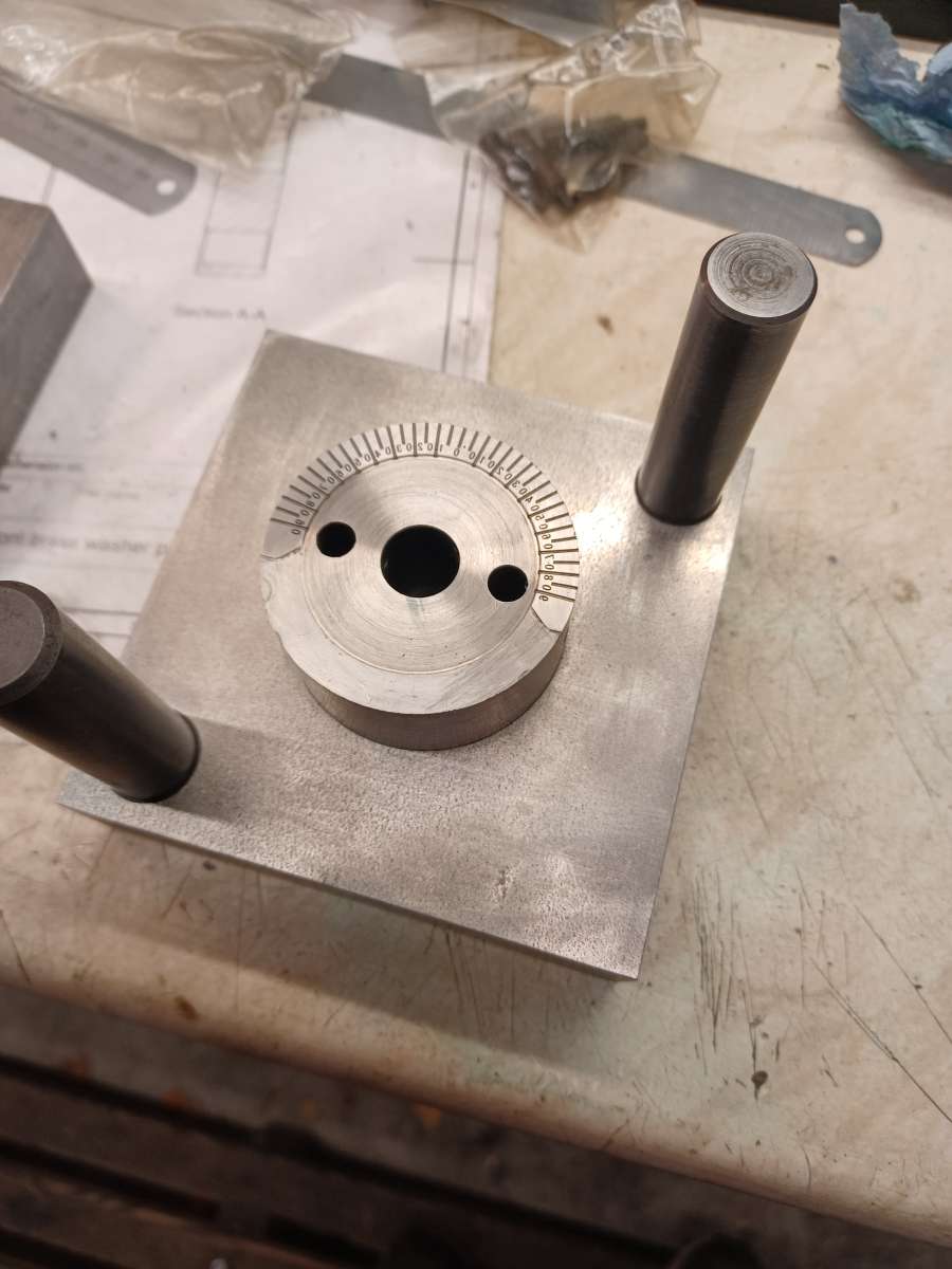

                                      David George 1
                                        @davidgeorge1
                                        Die back from hardening and 3D laser engraving.20251210_125345
                                        #828863
                                        Diogenes
                                          @diogenes
                                          What hardening process did you use in the end, David?
                                          #828935
                                          David George 1
                                            @davidgeorge1
                                            Hi I had it profesionaly hardened and tempered at CBS heat treatment Long Eaton. It was a bit iffy for me to harden as it could become a bit brittle. It was made 50RC which was sugested hard enough for bressing the brass.
                                            David
