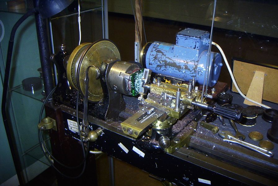

                                              Bazyle
                                                @bazyle
                                                The Ornamental Turners have been at MEX too but were sometimes hidden behind the stairs.
                                                This is an example from my album Sandown12
