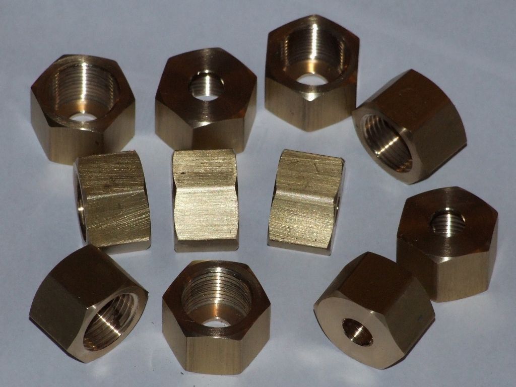

                          Admin this morning and ordering materials for a work job. Also set up a DD for my next payment to HMRC. sad
                          This afternoon I knocked out some brass gland nuts, as the last time I made a batch I unaccountably didn't make enough with a 5/16" through hole. All machining other than threading was done on the Britan:
                          Internal thread, into a blind hole, was done on the manual lathe, apposite to a recent thread on the forum as they're 3/8" BSP, ie, 19tpi. Less than 3 minutes each:
                          I've also recently made a batch of M6 studs and nuts to hold the clack valves onto the boilers, the boiler maker being metric, despite me settling on ¼" BSF for everything else.
                          Also this afternoon I thought I'd get a price for some tungsten alloy bar, as I had a thought of making the governor balls from tungsten as it is much denser than steel or brass. I asked for a quote for 300mm of 20mm diameter. They sent me a quote for 300mm of 25mm diameter, £689 I still haven't picked myself off the floor. I don't know what plan B is yet, but I'll be following it!
                          Andrew
