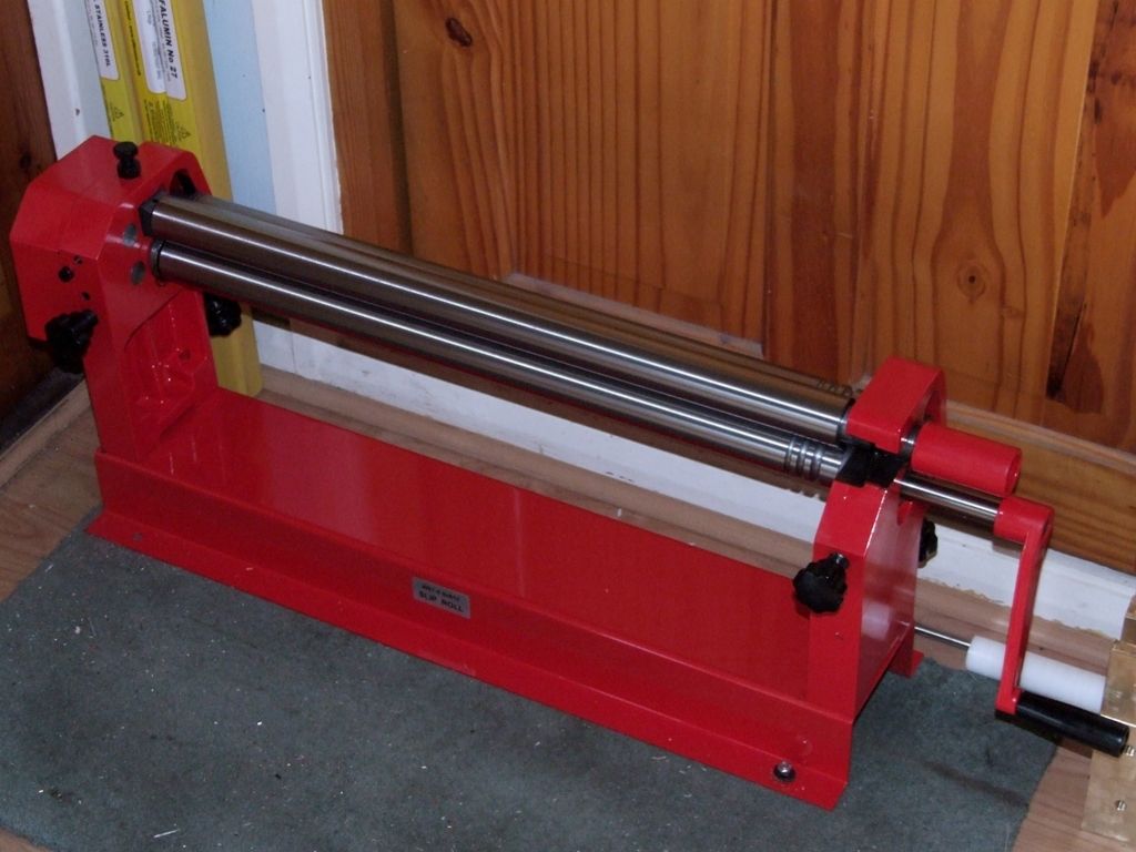

                          New toy day; bending rolls, ordered yesterday, delivered 9:30am today:
                          Rolls are 610mm long. I need them for work for rolling some perforated stainless steel sheet. But they will come in useful for the traction engine chimneys. wink 2
                          Andrew

                            Nice bending rolls Andrew. Are the roll(er)s made of any special hardened material to help keep them rigid?

                              Posted by Ed Duffner on 24/03/2017 18:44:17:
                              Ed.
                              rigidity (stiffness) is a function of Young's modulus, which is pretty much the same for all steels. Hardening would have no effect unless you were approaching the yield stress, and I doubt Andrew is going to get that enthusiastic.

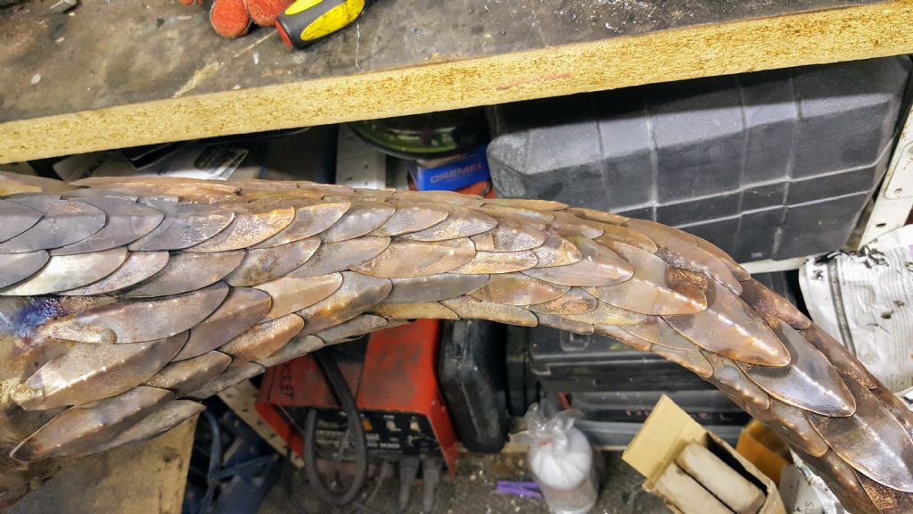

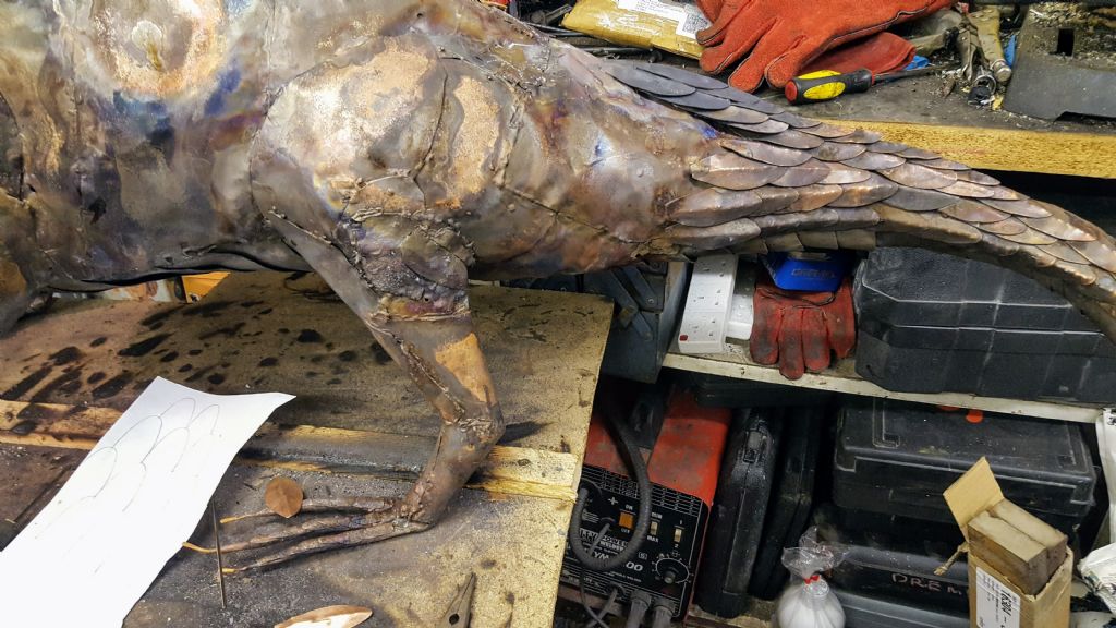

                                    Slowly adding the scales to the copper dragon that I am building. 200 scales so far, and barely any of the carcass covered yet. I shall be so glad when they are all on as the appeal of cutting them by hand soon evaporates. Once this is completed, though, I shall be able to move onto the clock that I want to make with a clear conscience of having finished something first
                                    I made myself another compressed air-propane torch a few weeks back. I spent time on a new design and this version is smaller, much, much more controllable, less ferocious, but just as effective for brazing the bulk of this thing.
                                    James

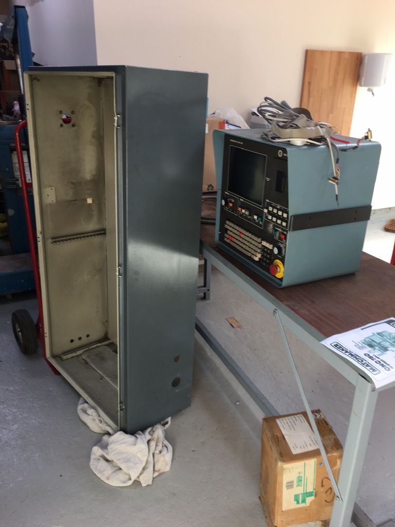

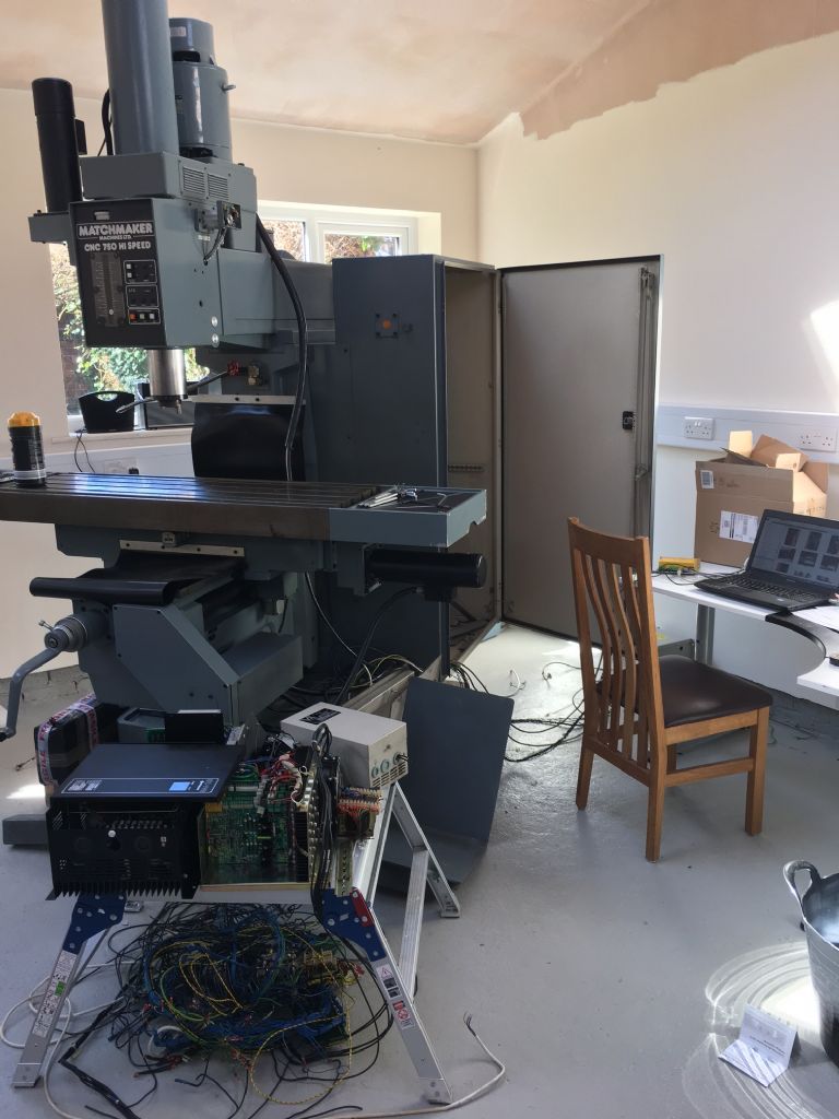

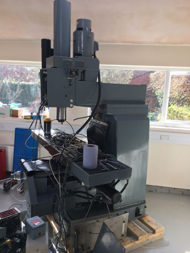

                                              Got busy today, ripping out all of the 1980s electronics from the control cabinet on the CNC mill. It was 99% still functional but annoyingly the display stubbornly stopped working during the week, so any further operation became impossible. Pity, as I'd hoped to do a bit more playing about with it before getting on with the retrofit.
                                              The cabinet is almost big enough to sling a hammock inside. Similarly the operator console / telly thing is very sizeable by today's standards. My cunning plan is to dispose of the cabinet and bung everything into the console unit. So now the cabinet is waiting for a trip to the dump and the machine is just a jumble of cables from the servo motors, spindle motor, limit switches, coolant and lube pumps, gear change solenoids, tool changer etc. There's no going back now. The stuff on and under the step is the antique electronics and there's another pile that came out of the console.
                                              Giant cabinet
                                              Cabinet and console
                                              Bare machine
                                              My new 4-axis Chinese (Newkye 990M) controller should fit nicely into the console box and the modern servo drives are minute compared to the originals. Even the new Yaskawa VFD is tiny. This approach should also enable me to remove the head / ram assembly next time I need to move it. We actually built the workshop around the machine and I can tell you that it won't fit out of the door as it stands.
                                              I connected up a CNCdrives servo drive to the X axis motor, a bench PSU and the configuration software on a laptop. I seem to have connected up the encoder, power supply and comms connections correctly, as it works rather nicely. I took the opportunity to do a sanity check on the backlash. I only have a Xmas cracker DTI (Chinese made, "Kurt" branded) with a resolution of 1''' per division. It seems to be better than the DTI will register when I traverse the table and return to the original position. It seems that would normally warrant a willy waving post on most of the US forums but I'd rather give it a representative (significant) load before getting too excited. Certainly it's considerably better than the Blidgeport and encouraging enough for the moment.
                                              Murray

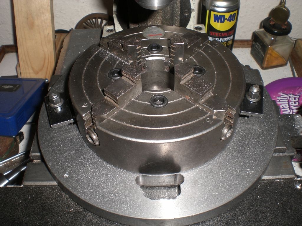

                                                Hi, yesterday I managed to find a little time to drill and tap my new backplate for my slim four jaw chuck, having received some cap head bolts off ebay.
                                                It's now sitting on my mini mill table to be lined up and drill the pilot holes for the holding down bolts. As it happens the T slots are the same distance apart as they are on my Chester Champion mill, so just need to get it central on the table and drill the holes on the PCD, using the DRO's to get the positions over the T slots.
                                                Regards Nick.

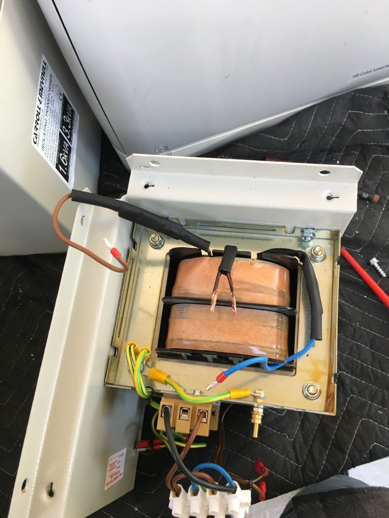

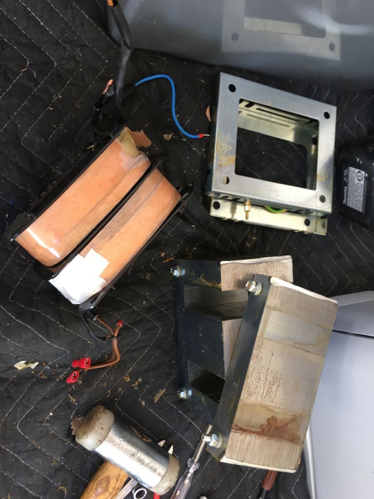

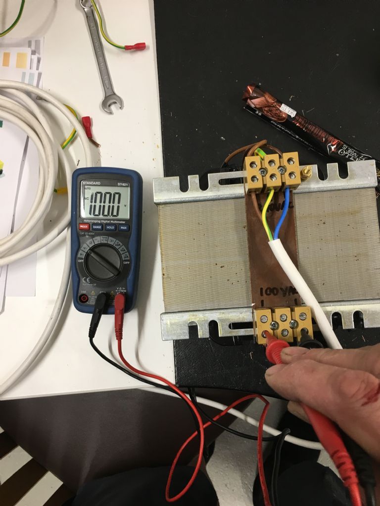

                                                  Yesterday actually. Dismantled a 3300kVA isolation transformer (110V CTE wall mounted) and removed some secondary turns to reduce the output to 100VAC. I need around 140VDC (no load) for my new servo drivers, so this would be about right.
                                                  3300kVA transformer
                                                  Unlike the yellow site transformers that are potted with black resin, the wall mounted ones are simple to dismantle and modify. Once down to the basic transformer, I used a cutting disk to grind out the welds holding the "I" laminations and pulled the winding assembly out. Seemed to have about 72 turns in total, so I removed 12 turns.
                                                  Winding removed
                                                  Bolted it all back together and the voltage seems to be where I want it. I haven't welded the laminations back (welders not yet recommissioned) but they are back where they started with a minimal gap and the bobbin is held in place with silicone elastomer (to keep the noise down!). This will be fine for now.Working again
                                                  Murray

                                                    I think the trfr in the pic is a wee bit small for 3300kva?
                                                    #290884
                                                    Muzzer
                                                      @muzzer
                                                      That's what it's sold as. In fact 3300kVA intermittent, 1700W continuous. It's a conventional site transformer. The ratings are determined by the allowable temperature rise of the windings and insulation system.
