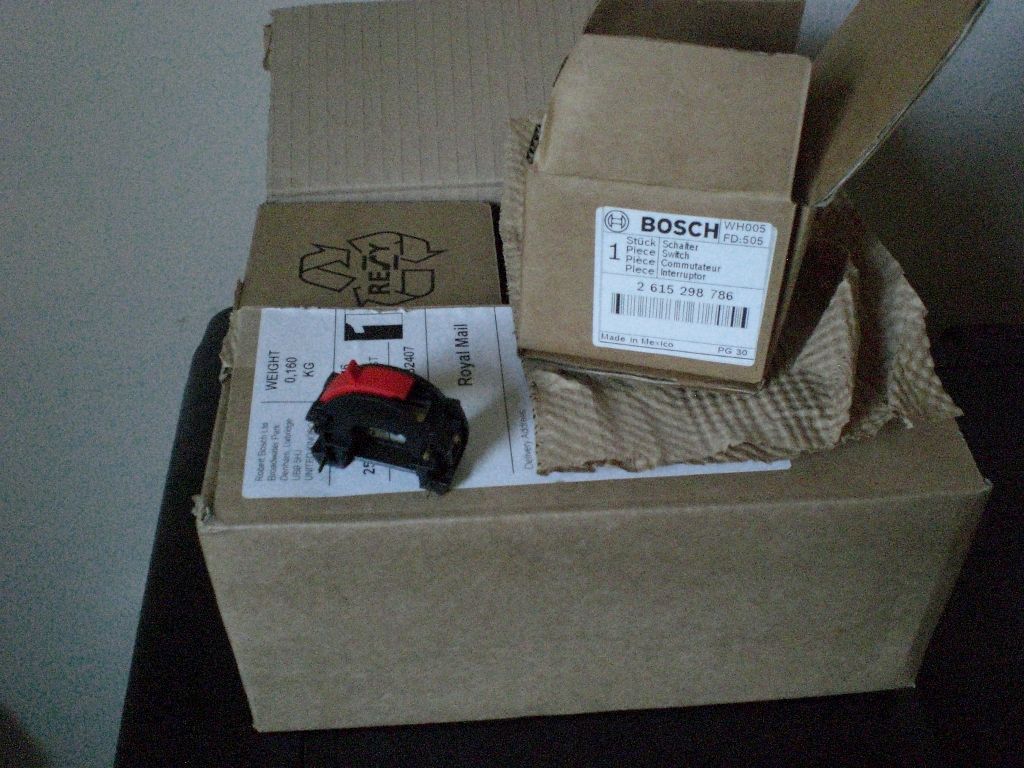

                            That aside today I fitted my new switch into my Dremel, which came in the post in a small box, which is on top of the bigger box that the small box came in. The switch is approx. 45mm x 35mm x 25mm overall, the bigger box is 235mm x 185mm x 100mm.
                            The Dremel is now up and running again.
                            Regards Nick.
