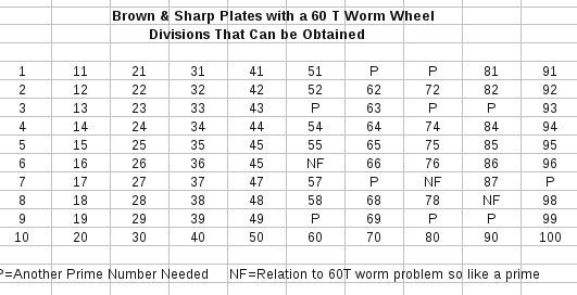

                                            Thanks Jason. I had wondered. My dividing head is the Dore Westbury design with 60T wheel but he used his own idea of hole counts on the 2 plates to go with it. 14 circles of holes and unusual primes so it misses a fair few tooth counts so I had a look at what happens if 60T is used with B&S plates which have been pretty popular and it comes out like this
                                            That's just up to 100 'cause I got fed up. Coverage is more important the lower the count anyway. winkIf I do one I think I will stick to 60T and fit a bigger handle.
                                            I was rather surprised by the hole counts on the vertex plates. As some primes aren't there they couldn't offer the same coverage.
                                            I'd guess the dividing heads I used at work were 40T so that the worm form was strong to allow them to be geared from the table on a miller. They had us make a 1" twist drill and mill some square threads.
                                            Edited By John W1 on 03/11/2015 23:27:37
