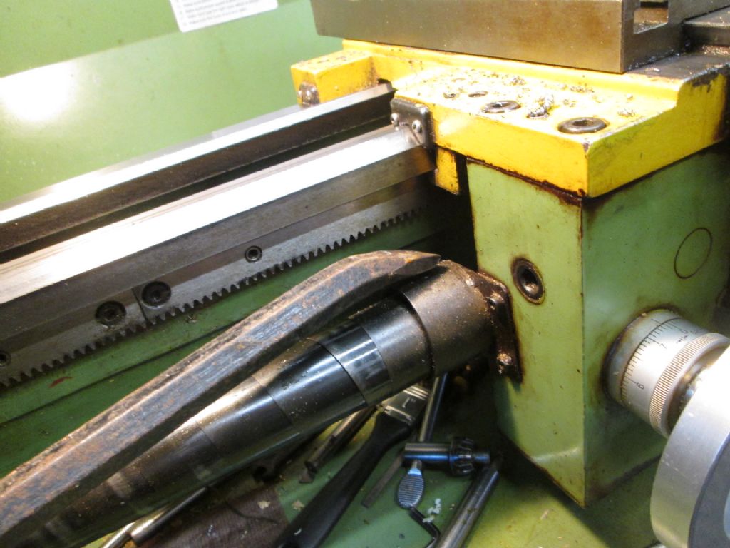

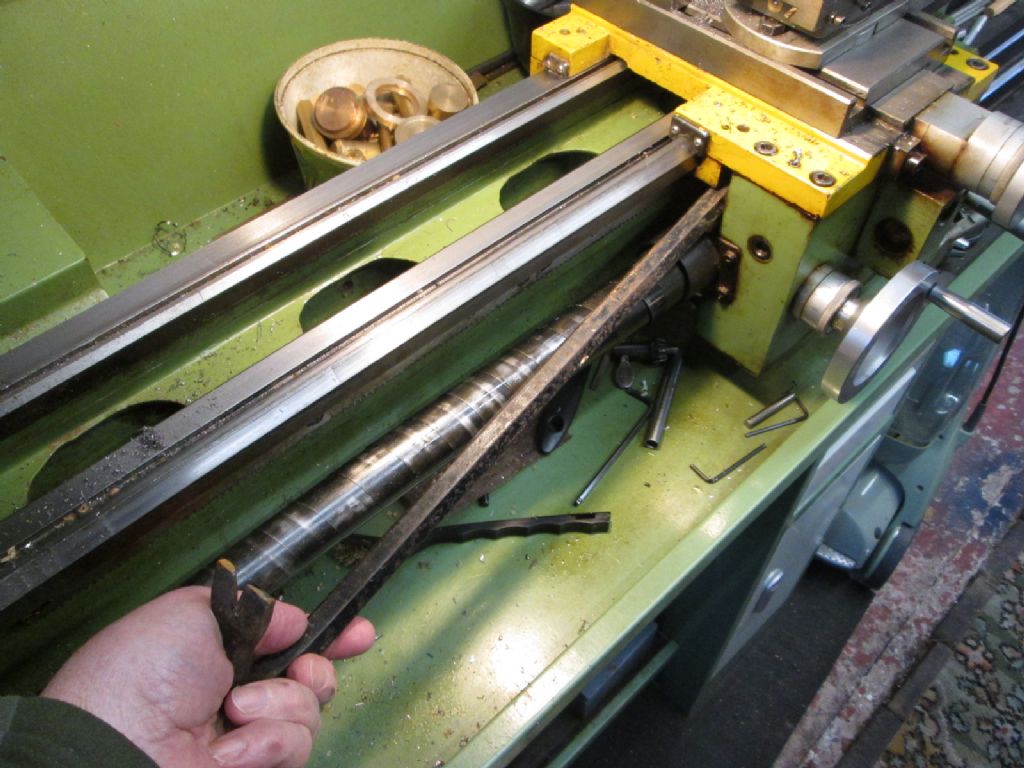

                      I have a WM250V. The sheer pin is brass 3mm dia. Problem is in my case that it does not shear. Through carelessness the other day l locked up the carriage against the stop. The pin did not shear and the result was the carriage pinion shaft bending. This has happened twice now.
                      Okay it's a quick fix (the second time!!) Remove the carriage gear box and hit pinnion shaft with a hammer. After the first time l decided to fit a plastic shear pin. Will definitely actually do it this time.

                        You don't need to take off the gearbox if you've got a standard crowbar with a shallow-bent toe end. You run the saddle to the tailstock end and find the tight spot – that's where the bend in the pinion shank's forcing it hard against the bed rack. Set the tiptoe of the crowbar against the top of the pinion shank with the top of the shallow bend against the corner-pad under the LH near side end of the saddle, then lever up. That bends the pinion shank downwards, away from the bed rack – solving the problem.
                        My shearpin didn't shear because it was silver steel or something like it. What did shear was one of the keyed bushes in the headstock geartrain, between two paired gears. The shearpin's now brass, but now that you've told me it's still too strong to save the carriage pinion, I think I'll weaken it further at some convenient time…

                                Here's the crowbar fix to the bent pinion. Pic 1 shows the end of the crowbar to use, pic 2 shows it in place with the chisel toe on top of the pinion shank and the fulcrum up under the saddle corner pad:-
                                You have to be able to get the saddle far enough from the headstock to get room for the crowbar, and get the highspot on the pinion at the top, ie. where it binds tightest against the rack, so a *very* severe bend might not be fixable this way. But if it's possible, it costs nothing but a minute or two's time – though to be fair, we got the crowbar for free because the previous house-owners left it in a cupboard…

                                  My pinion shaft was too badly bent to be tweaked back into position. The original material seemed to have more in common with plasticine than steel, having bent inside and outside the Apron. The lathe now runs with a mild steel pinion, Loctited and pinned, on a Silver Steel shaft, located by a brass sleeve. Seems to travel a bit more sweetly, so possibly reduced the backlash during the repair. It won't happen again, I hope, The pinion now disengage from the shortened rack just before Saddle / Headstock contact. So with hollow brass shear pins, and disengagement, there should be no more damaging collisions, unless I omit to open the half nuts at some future time!
