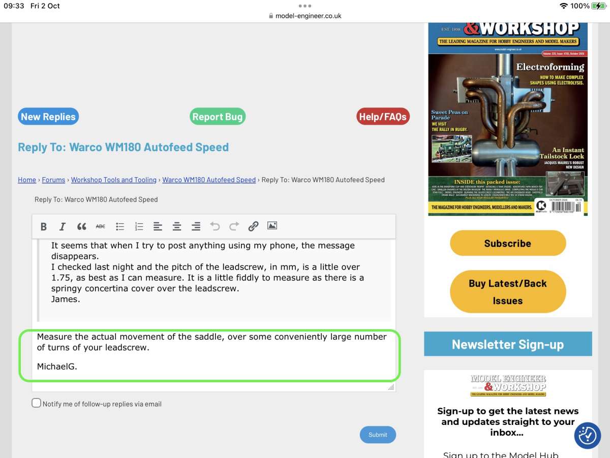

                                #867480
                                  On James A Said:
                                  It seems that when I try to post anything using my phone, the message disappears.
                                  I checked last night and the pitch of the leadscrew, in mm, is a little over 1.75, as best as I can measure. It is a little fiddly to measure as there is a springy concertina cover over the leadscrew.
                                  James.
                                  Measure the actual movement of the saddle, over some conveniently large number of turns of your leadscrew.
                                  #867484
                                    Posting problem persists … Grrr!!
                                    #867488
                                      I did let the back room boys know yesterday morning and they are working on it
                                      #867492
