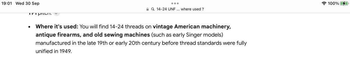

                          What wasn’t, until recently, was the existence (assuming it’s real) of a 14-24 UNF thread. Tracy Tools sell taps and dies in this size, but I can’t find it mentioned in my 1965 copy of Machinery’s Handbook.
                          The reason 14-24 UNF is problematic for me is to do with a forum thread I started on here in 2024 called “Whit Form Threads”. I had assumed that the screw I have an example of that prompted that forum thread was a Whit Form 1/4”x24. Given that its major diameter is in fact 6.15mm, I’m thinking it may actually be an example of 14-24 UNF. It’s very difficult to tell whether the threads are 55 or 60 degrees because the crests are quite rounded off, though this is clearly not a result of wear as the screw is a very good fit in its original female thread with almost no detectable wobble.
                          If anyone can shed light on the status of 14-24 UNF that would be marvellous. Is it perhaps a relic from the United States Standard or American National series that preceded Unified threads?
                          #867237
                            The mighty GoogleAI sayeth:
                            IMG_2103
                            … but of course it could be fibbing
