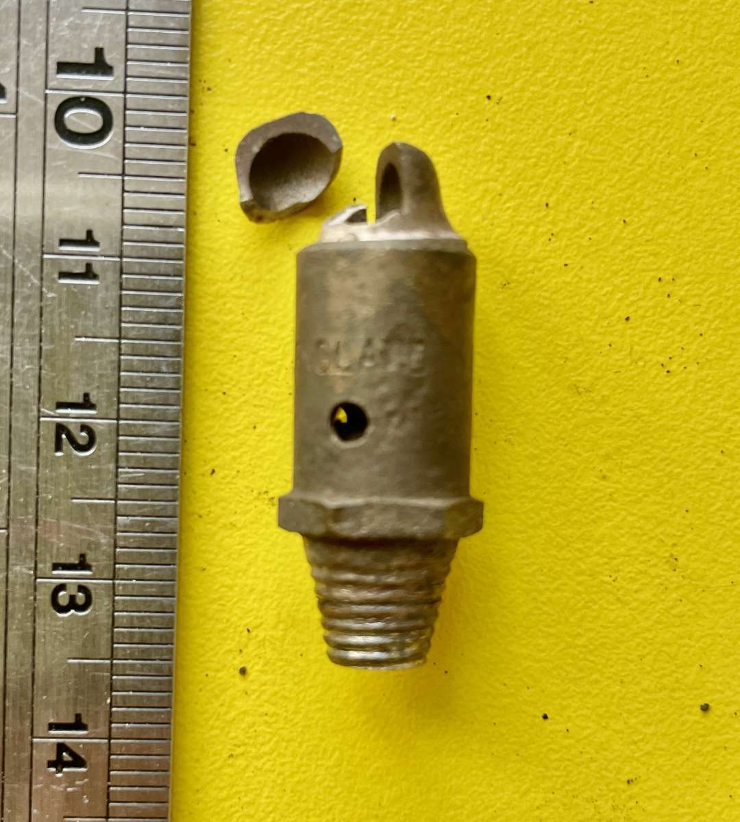

      Hi there, wondering if anyone here can help me find or possibly repair/machine an obscure 1950’s brass tapered ‘Bray 657A 25’ valve. I’ve attached a photo of the valve with the snapped cap which I’m trying to either get repaired or find a matching valve.
      The snap is very clean and the top ‘cup’ rotates so maybe removable. The brass around the snap is about 1mm thick and I don’t know if it is possible to braze or solder but guessing in use it would heat upto around maybe something under 250c?
      Any leads or steers VERY appreciated. This cooker has been in daily use for around 70 years and I’d really hate to have to scrap it.
      thanks again
      IMG_6735I believe these valves were used in gas, oil and maybe steam appliance in the 1950’s and this one is from a 1950’s New World ‘Rangette’ gas cooker which was in use everyday until now and I would really love to not scrap it.

        Hi jamiej, it would not be legal for a DIY repair, so you would have to find a specialist repairer to do such a job, or find someone who deals with second hand spares.
        Regards Nick.

          What does the valve do ? Is it a safety valve for a pressure cooker ? Does the top part unscrew from the hex base ? Is it used commercially ? Noel.

              I can’t see a reason why it couldn’t be silver soldered.
              The threads (assuming that’s what they are) look a little worse for wear.

                  What’s the legal bit? And I’d go for silver solder.

                        Hopefully, most Gas Safe Registered persons are either competent at silver soldering, or competent to determine whether a silver solder repair is fit for purpose, or still able, unlike non-Gas Safe Registered persons, to source parts for 70 year-old New World Rangette cookers.
                        Is there any info in the link that might help?
                        https://www.salvoweb.com/salvonews/18429-repair-and-servicing-an-old-new-world-rangette-gas-cooker
