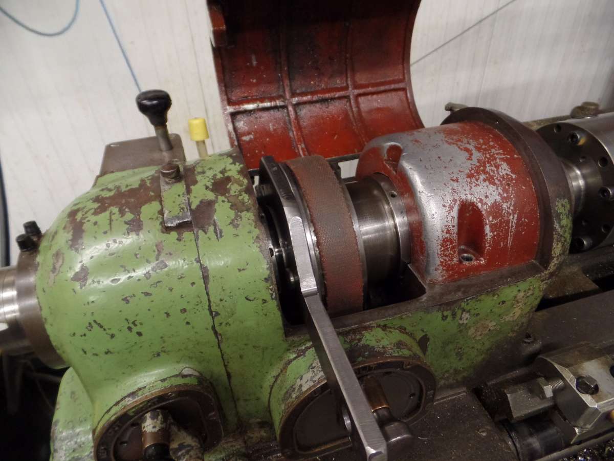

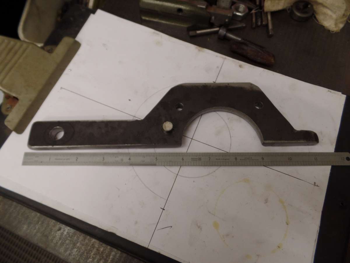

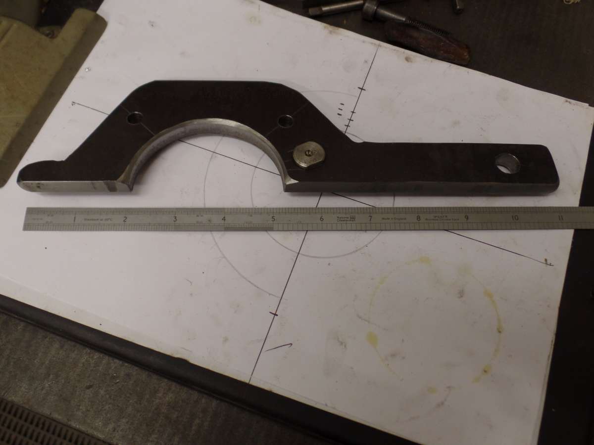

                          It would not be hard to make a device to hold the pulleys while unscrewing the chucks. Also for both the Atlas 12 x 24 and the tiny Emco SL1000 I made riser blocks under the headstock end which allows adjustable bolts at the tailstock end for “levelling”, the Emco did need that done, but your Portass S looks to have a pretty stiff bed and would not need adjustment. Only test cuts would tell.

                                I made a special spanner to fit a hole in the side of the pulley on the museum’s Smart & Brown model A to lock the spindle for unscrewing chucks, it has a pin on its side and it rests on the headstock casting when in use, if you take yours apart for cleaning it might be food for thought.SAM_1227SAM_1229SAM_1230
