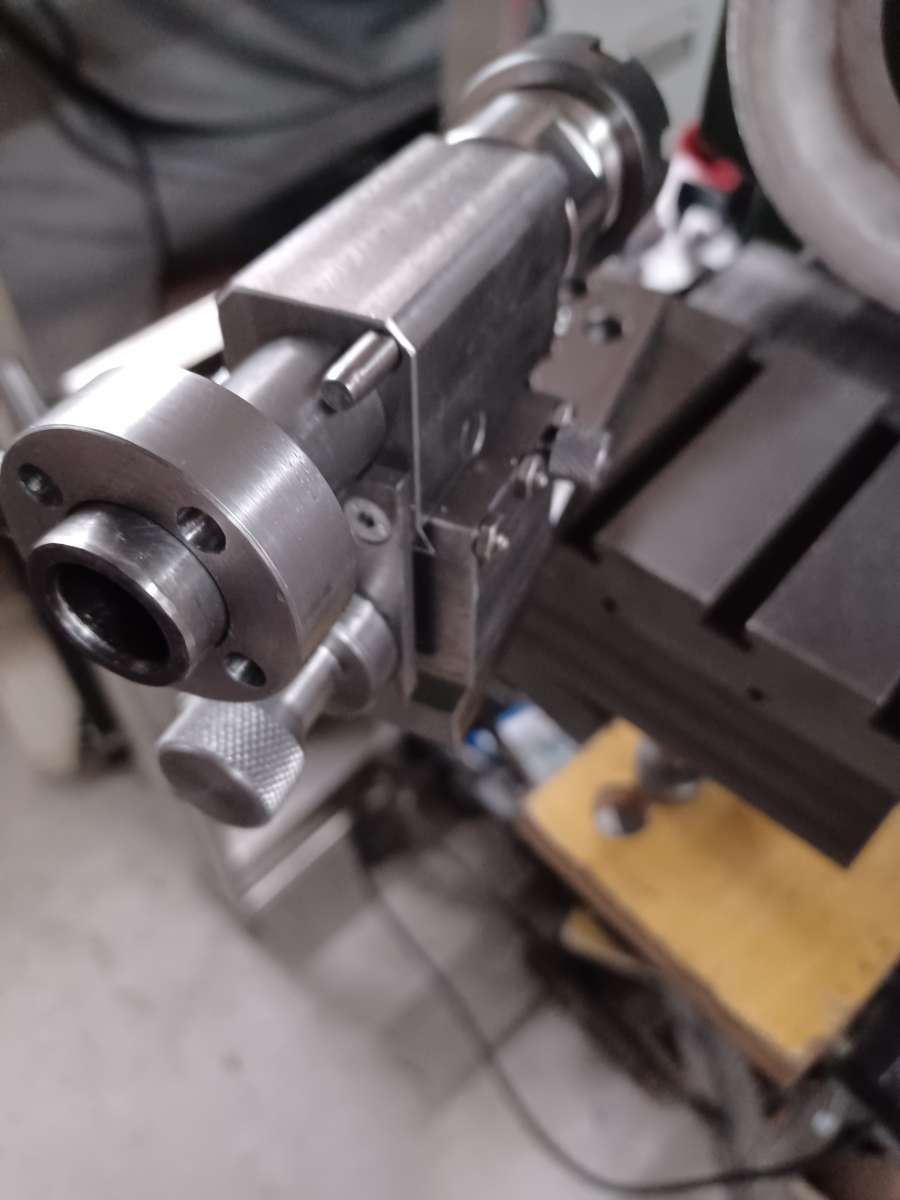

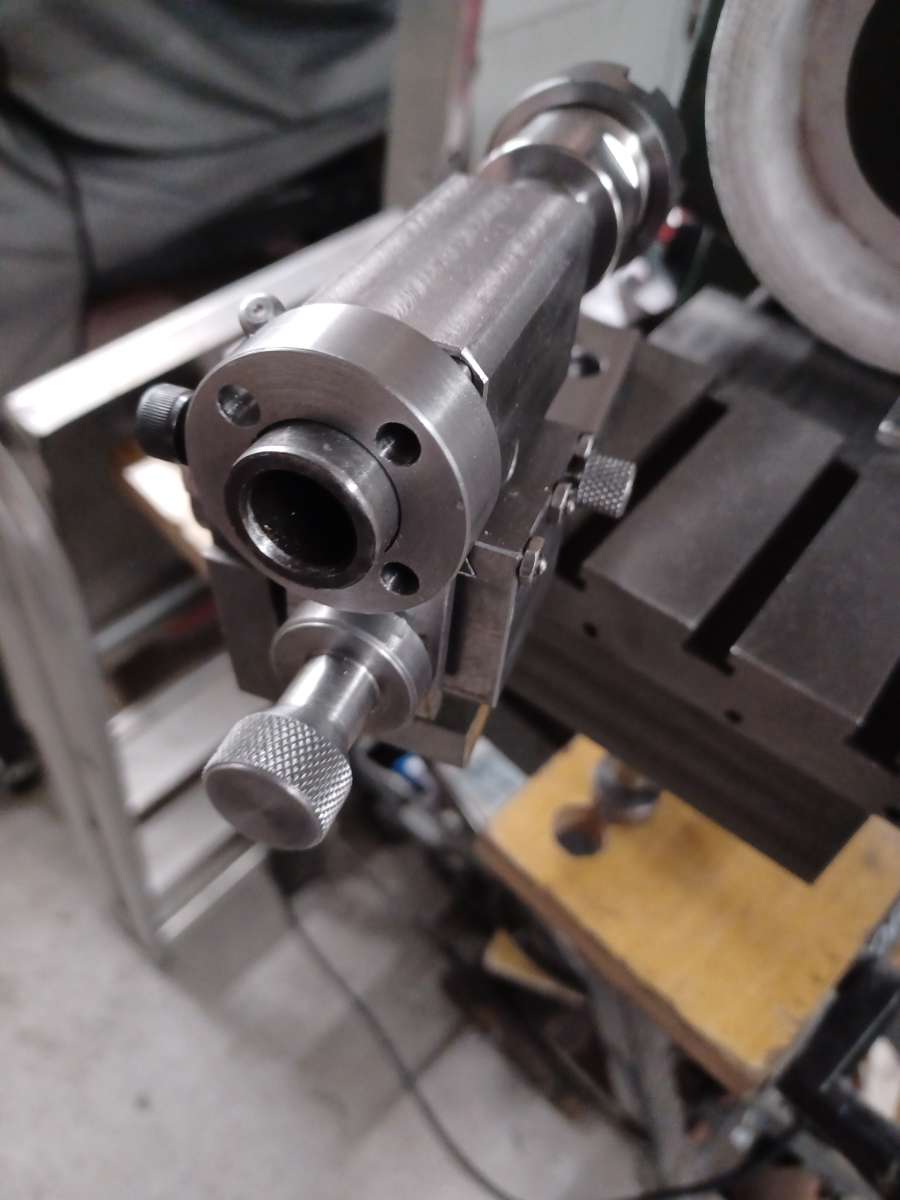

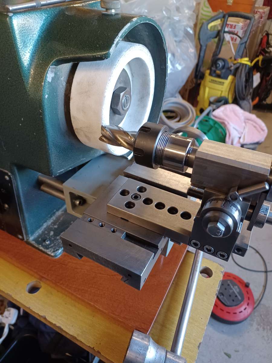

          David George 1
            @davidgeorge1
            Hi Martin I have put a collar with four equal distant holes in with a grub screw to clamp it in place. These holes locate on a pin in the top slide so I can release  the side clamp lever slide the collet holder back then rotate to opposite hole, slide the collet holder forward to stop and re-clamp and grind the second edge. I can do either two or four for end mills as well and will make a collar for some three flute countersinks I would like to sharpen.

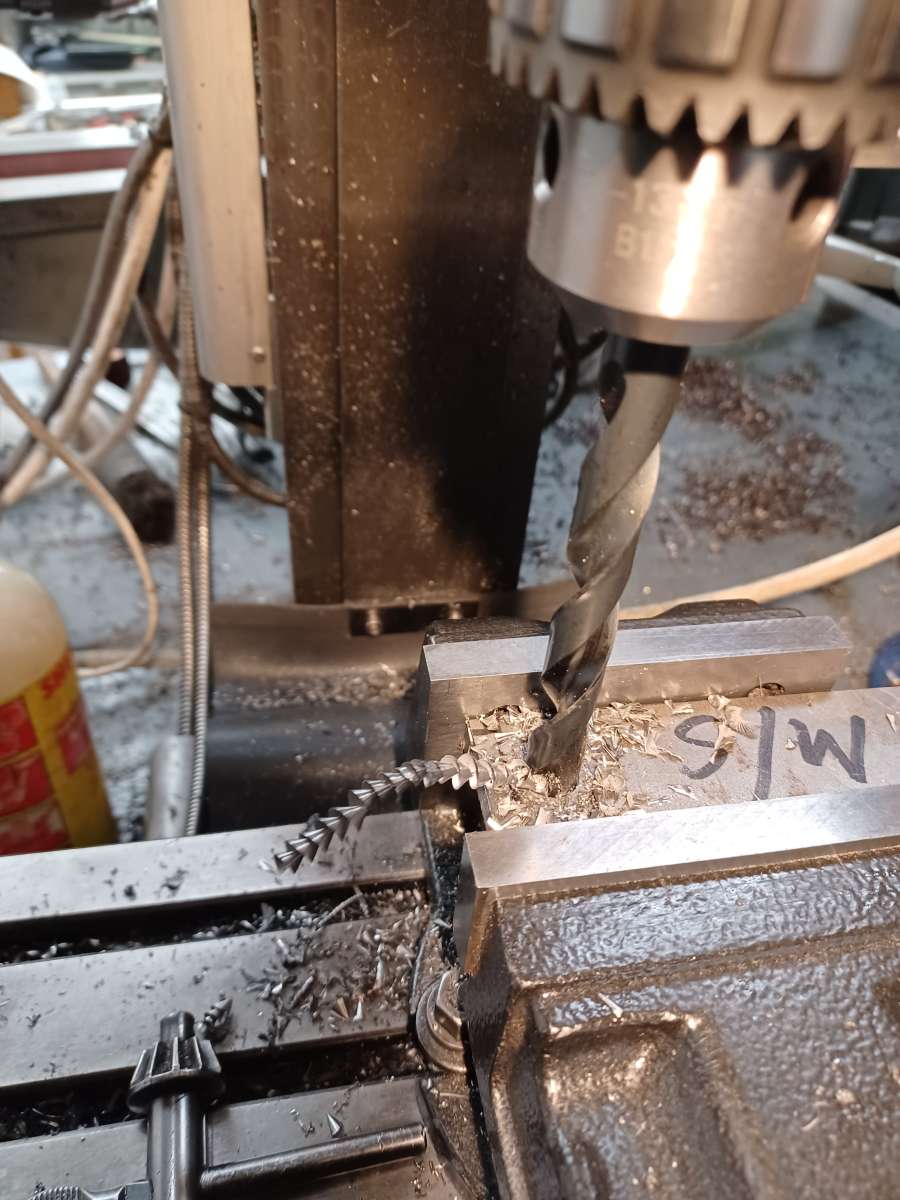

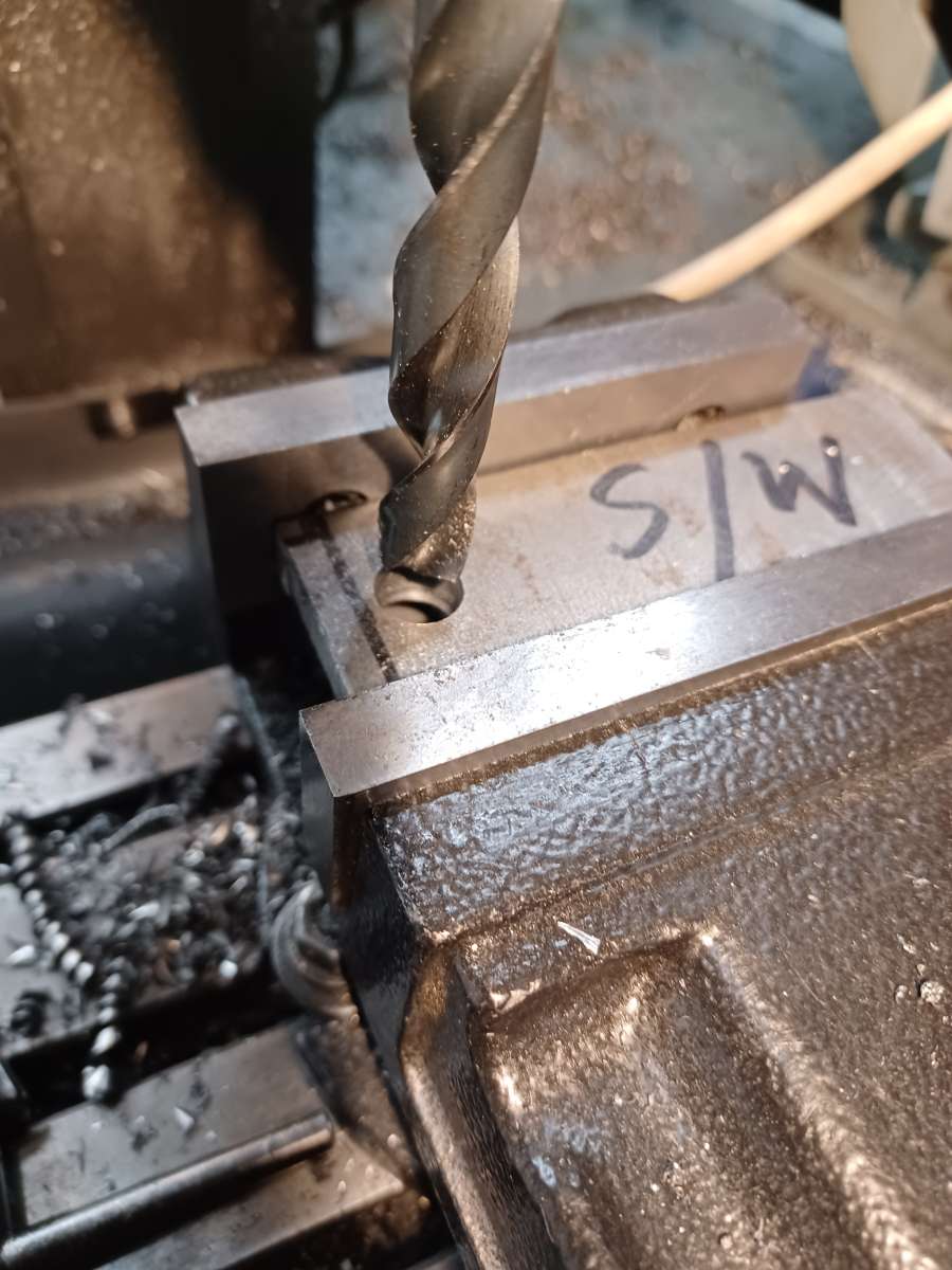

            David George 1
              @davidgeorge1
              I decided to try drilling with the drill which I have just sharpened and it worked perfectly. I didnt even spot or center the hole  and it cut perfectly.
              20250212_170951
              20250212_171044
              20250212_171201
              David

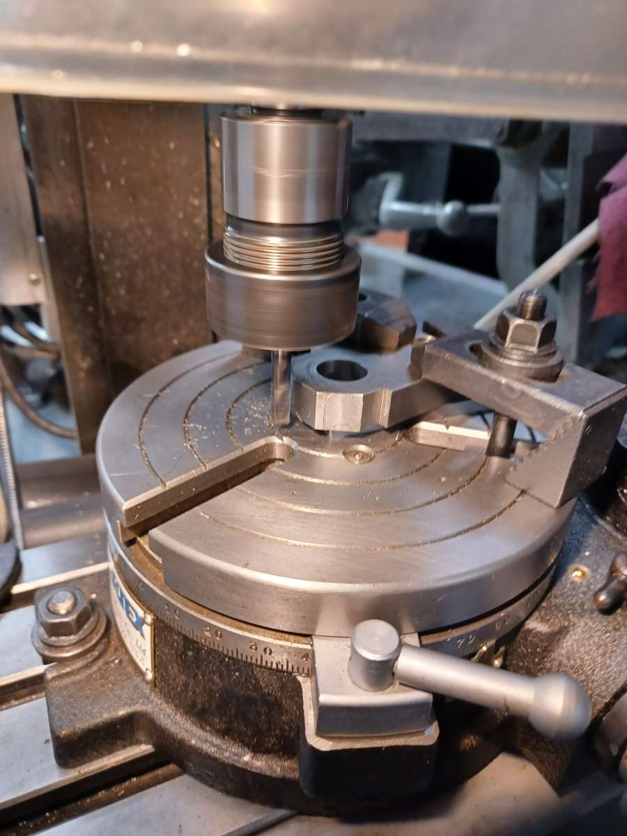

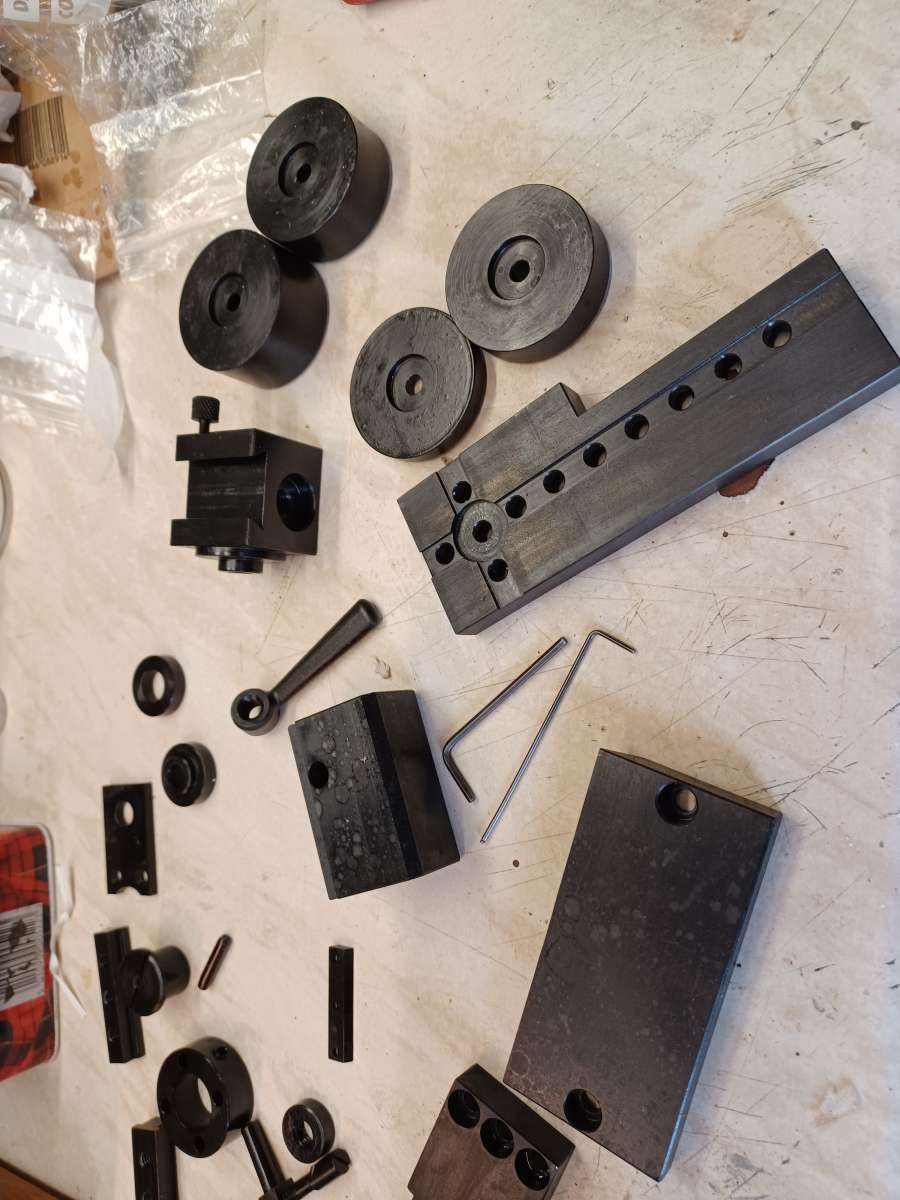

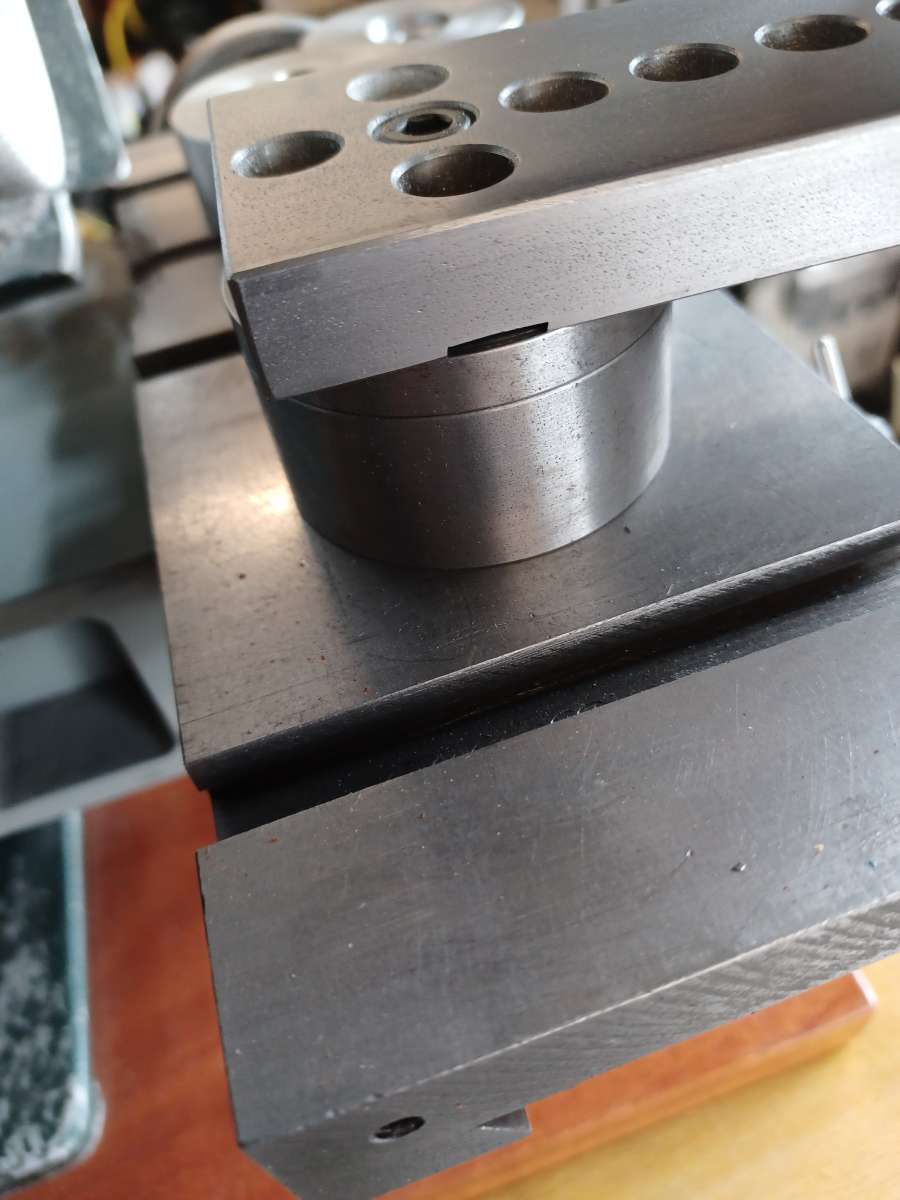

              #785267
              David George 1
                @davidgeorge1

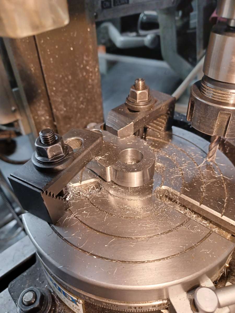

                I managed to do some work on the parts for the tool holder jig. I had to machine a half circular end to the angle bracket so it can be engraved with the angle scale.
                20250223_164309
                20250223_165642
                20250223_190729
                I used arotary table and a 6mm carbide end mill.
                David

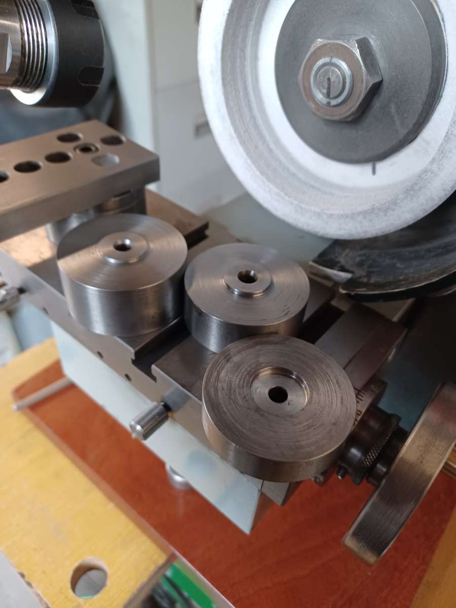

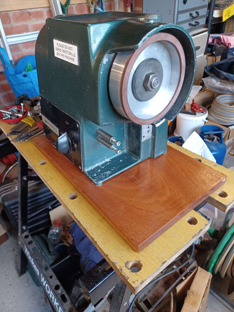

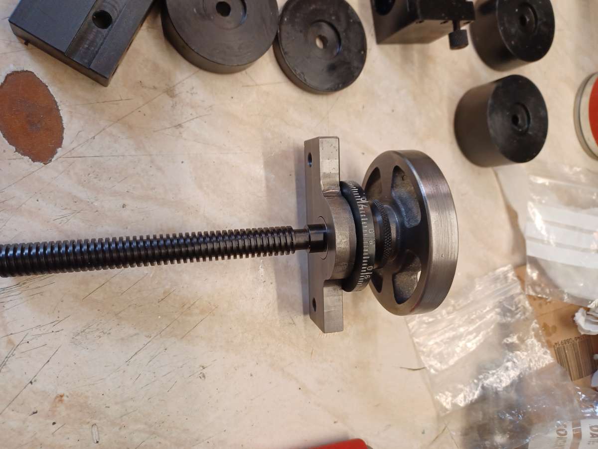

                #802919
                David George 1
                  @davidgeorge1

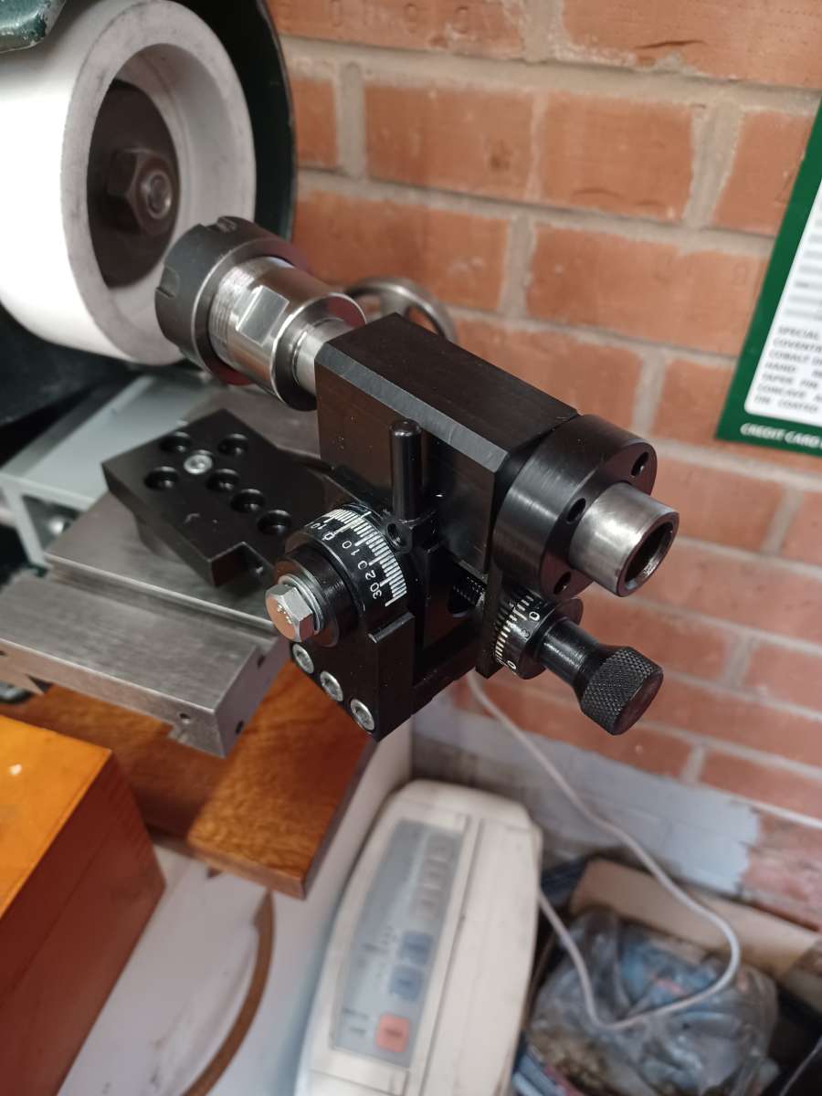

                  I Have got round to continuing with the cutter grinder mod and have made an adjustable table so I can grind flat tooling like turning tools tips etc.
                  20250613_091304
                  Also I have engraved the dials so I can use them for seting and amount grinding angles etc. I have also started making base for the grinder as it is a bit light and wobbly.
                  20250614_161935
                  20250614_161853
                  David

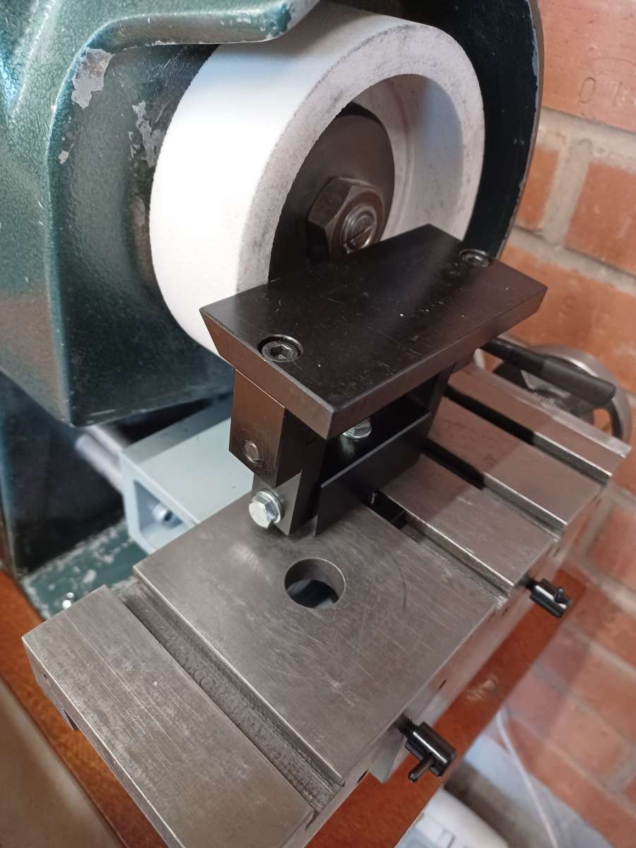

                  #806524
                  David George 1
                    @davidgeorge1

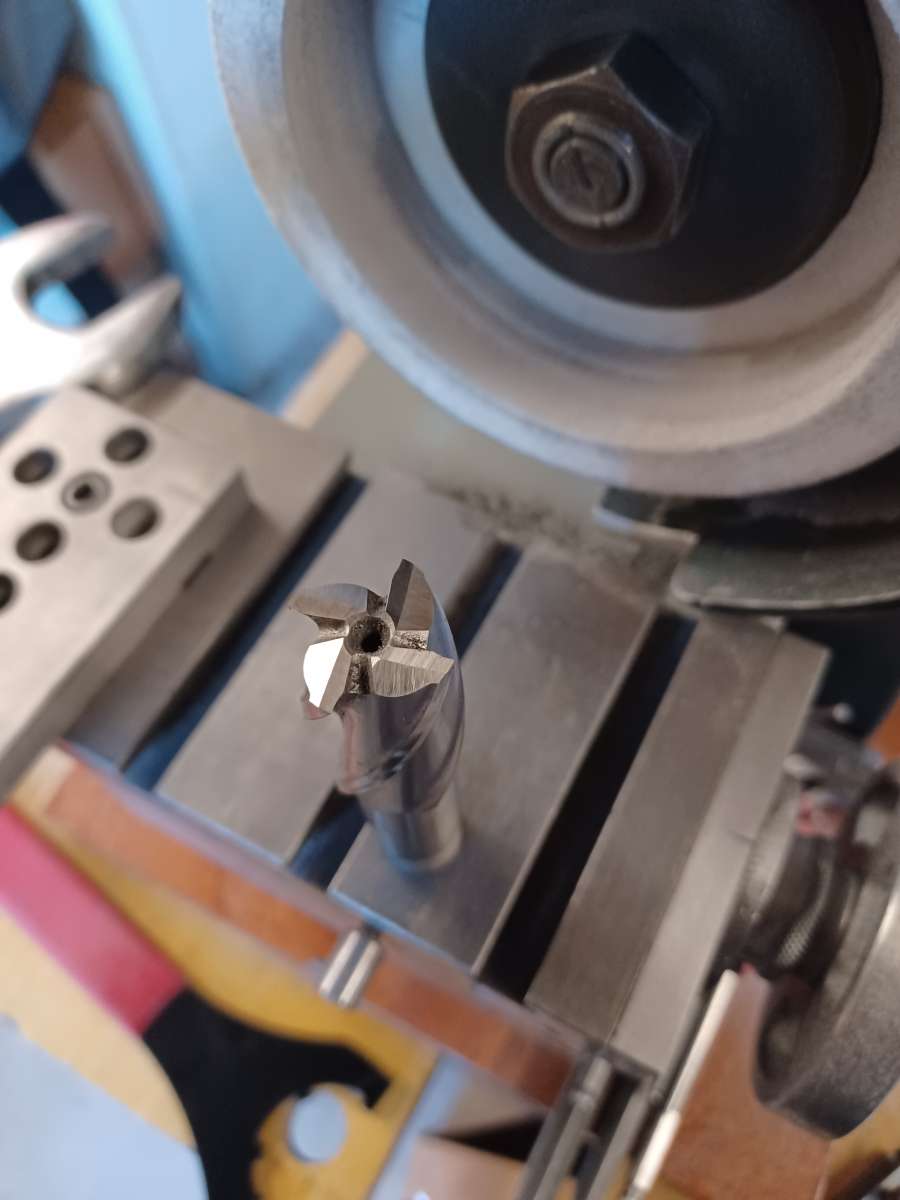

                    I have mostly finnished the mods to the grinder I intend when finnished to have it chemicaly blacked and the engraving filled whith white paint to show up the lines and digits. I  thought I would actualy sharpen an end mill and after changing the adiamond wheel for a white Aloxite 100 grit wheel and stet up and easily sharpened the 20mm cutter.

                        I have got round to the vertical height adjustment with a serice of interlocking spacers of various thickness.  For most flat jobs the centerline is the same as the center of the grinding wheel but for some end mill cutters etc the angle needs height adjustment and I have a series to adjust that.
                        20250719_172938
                        20250719_172953
                        The spacers interlock with the bed location and the base of the angle plate holder so the radial angle can be set to suit the end of the cutter etc.

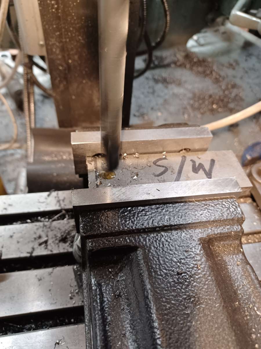

                                #866623
                                Colin Teasdale
                                  @colinteasdale
                                  Hallo David,
                                  Apologies for resurrecting this thread, no matter how interesting!

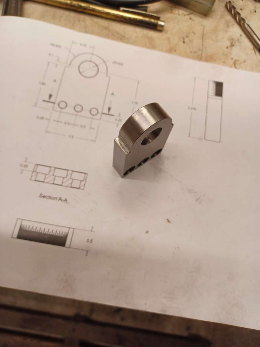

                                  When you came to machine the dovetails, I noticed that you milled a slot and then cut the dovetails – did you cut each side in a single pass, or did you take multiple passes each with a relatively shallow depth of cut?
                                  If the former, did you have to cut both sides at once, or did you take multiple passes using different sizes of dovetail cutter until you reached the desired width?
                                  Reason for asking is that I have a Hemingway retracting tool holder getting to the top of the ‘projects to do’ list but I can’t work out how to actually cut the dovetails!
                                  Thanks in advance,
                                  Colin T
                                  #866624
                                  bernard towers
                                    @bernardtowers37738
                                    for me its usual to cut a straight slot first then use dovetail cutter to run down one side in one cut and the same the other side.
                                    #866625
                                    Andrew Crow
                                      @andrewcrow91475
                                      It is normal practice to cut a central slot first prior to cutting a dovetail, then cut one side then the other. Cutting straight through with the dovetail cutter puts lot of pressure on the cutter plus a lot of swarf to clear, high risk of breakage.
                                      Andy
                                      #866631
                                      Mark Rand
                                        @markrand96270
                                        Basically, try to use mostly or only one face of the cutter at a time, to reduce the load on the delicate corner of the cutter.
                                        An example:- have the cutter 10 or 20 thou above the desired ‘flat’ height. Take cuts on the taper until the calculated width is reached, reduce the height to the correct level and take a final cut.
                                        In a perfect world, use a narrow slotting drill or (better) a slotting saw to cut a slot just past where the corner of the dovetail will be (depending on what tools and work holding are available), then cut the dovetail. This gives a clearance at the corner of the dovetail and makes it easier if you need to use a scraper to achieve a perfect finish.
                                        #866762
                                        David George 1
                                          @davidgeorge1
                                          Hi as Andy says cut a slot first to depth and then cut the angle after using a roller against the angle face as I have a drawing with the dimention to the roller to the outside face of the slide or base. II also leave aa small flat on the edge of the dovetail so you dont have a sharp edge.
                                          David
