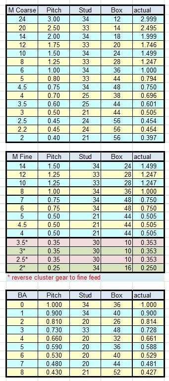

      Hi, novice here. I have a Myford Super 7 with a quick change gearbox, circa 1976. I also have a 34 tooth and 33 tooth stud gears which I believe can be used to cut ‘metric threads’, albeit with some small errors. I have the ‘standard’ quadrant, as supplied with the QC gearbox. I have the excel spreadsheet that indicates which stud gear to use in place of the standard 24t one but, when I remove the 24t stud gear I cannot install either of the 33t or 34t gears! I have loosened the quadrant but I cannot get enough movement to install the replacement gear! I wish to cut a 16mm x 1.5 metric thread so, as per the spreadsheet, I’m trying to install the 34t gear but, have failed miserably! Am I missing something or am I doing something wrong? Any help would be greatly appreciated!

        No, you’re not missing anything, don’t worry.
        I had the same issue, so I extended the curved slot in the banjo/quadrant slightly with a round file.
        In my case it was on a Warco 720 Super 7B clone, but I’ve read of others having a similar problem with the genuine Myford.
        Once you’ve done the job, it makes cutting the threads easy.

            I had to tweak the quadrant on my S7 as well.

              So did I.

                I have just one copy of the bulletin/table/spreadsheet of the threads, gears for metric and other threads etc.
                Any idea where I can download one from? – thanks in advance

                  I have this one;
                  Myford metric threads via gearbox

                      If you go to my gallery, there is a copy of the above photo, from John’s original, as well as a spreadsheet for the metric ones by Mal Vickers; copyright remains with Mal, I’ve no idea where I found it.
