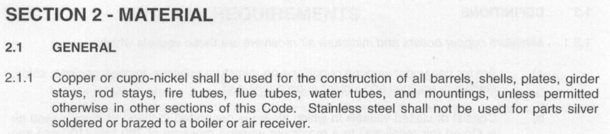

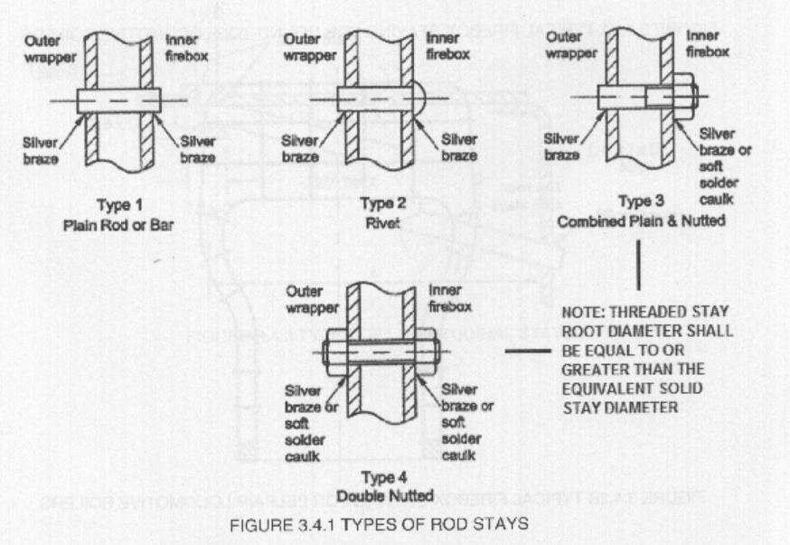

          This is a copy of the types of stays that are allowable in the Australian AMBSC code for copper boilers.  I would query the use of using brass nuts because boiler water can de-zincify brass fittings.

            I think we need a metalurgist to give a definitive answer, but I think you need liquid water in contact with the brass to get dezincification.  I suppose liquid could work its way down the threads.
            #867657
              Plenty of Minnie traction engines running around with Mason’s specified brass nuts inside the firebox on bronze or GM stays. As the whole lot is silver soldered you should not get any water contact with the nuts if the solder flows into the gap between stay and boiler plate.
              Though the commercially made one tend to just have a copper rivit with head on the inside and all soldered in without nuts.

                Looking at Paul’s illustration from the Australian boiler code, why is silver soldering stainless steel to a boiler not allowed?

                  Despite its name, stainless steel will corrode when exposed to hot tap water and in contact with copper. There is also the problem of corrosion of silver-soldered joints in stainless steel in these conditions. There was an article in ME  about why silver solder and stainless are not best friends by Graham Astbury, in September and October 2023.
                  #867709
                  Paul Lousick
                    @paullousick59116
                    Stainless steel is not recommended for boilers because high temperatures combined with even low levels of chlorides can break down stainless steel’s passive chromium oxide layer, causing sudden, brittle, and cracking.

                      I’m not sure why you’d bother with nuts on the inside if you’re going to silver solder stays.
