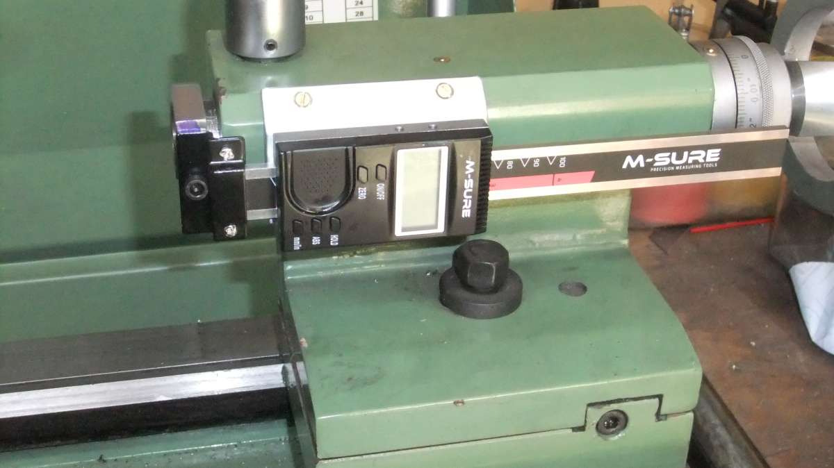

          Dalboy
            @dalboy
            If possible make a gauge up like this. Always handy for future projects I got the gauge from Machine DRO and some small pieces of Ali plate from my stockpile.

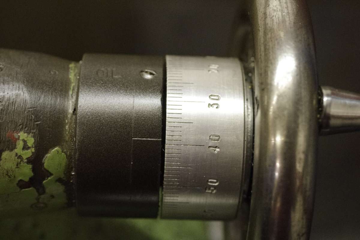

                          Although not ever-so-accurate, I count tailstock handwheel turns. With a 1/8″ lead barrel screw, a 1/4 turn gives 1/32″ advance.
                          Adjusting the method according to depth being to drill point or full diameter, I start the hole, stop the lathe, bring the handle to bottom or top dead-centre (judged by eye) then move the whole tailstock to bring the drill end to the required datum point. Then count turns each time I wind the drill back in after withdrawing it to brush the chips off and the cutting-oil on.
                          The obvious corollary is to make a simple handwheel dial if (like mine) your lathe does not already have one.

                            Good morning Bob, me try this post again.
                            I did something similar to Dalboy’s post on my WM250 with a DRO scale from Warco, and it works a treat (I wish I’d done it years ago).  If you don’t fancy making your own, have a look at LINN Tools (not the HiFi Linn).  Also, Blondihack’s made one for her lathe a while ago.

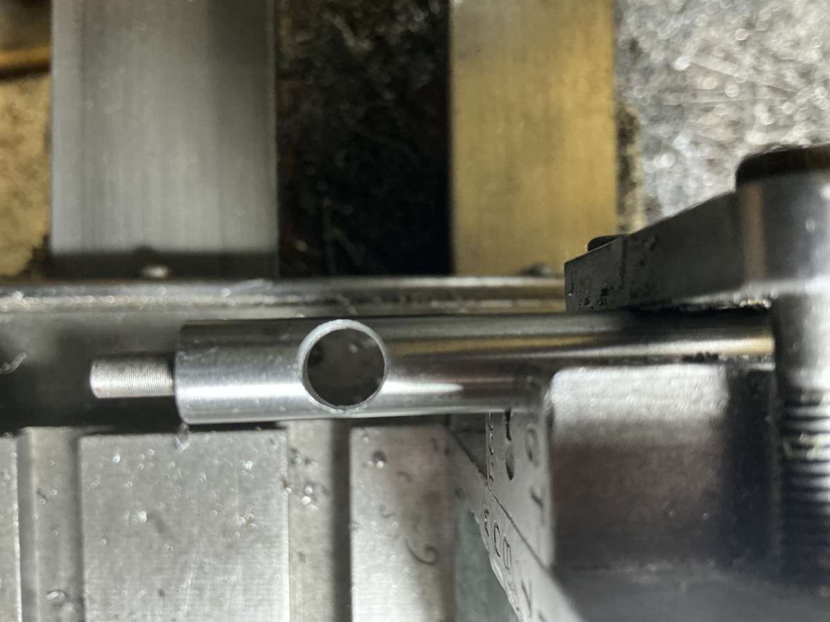

                              Bob Sillitoe
                                @bobsillitoe83708
                                Thanks for all your suggestions. In the end I went for using a bit of steel in the toolpost to act as a stop. I used the end of the tailstock barrel to butt the stop up against – worked well.
                                In answer to the question what lathe do I have it is a Southbend 9C, manufactured in 1942 and shipped directly to the UK to support the war effort. It has been linked to my family ever since. It was pretty worn but during lockdown I stripped it down to nearly the last nut and bolt and gave it a through going over, including replacing the cross slide feed screw and nut. It is now pretty accurate for an 84 year old machine. Knowing what I know now I would have put a 3ph motor and VFD on it but at the time I didn’t know such things existed.
                                Next job for today is to drill a 1/16″ cross hole in a 1/8″ dia mild steel bar. – I wonder how many attempts that will require!

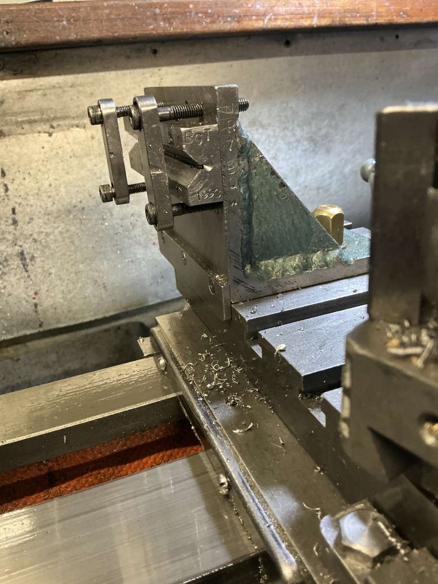

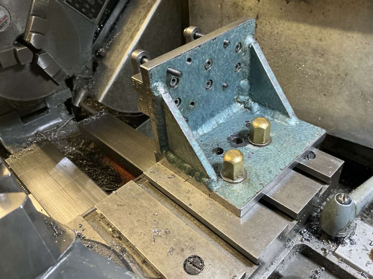

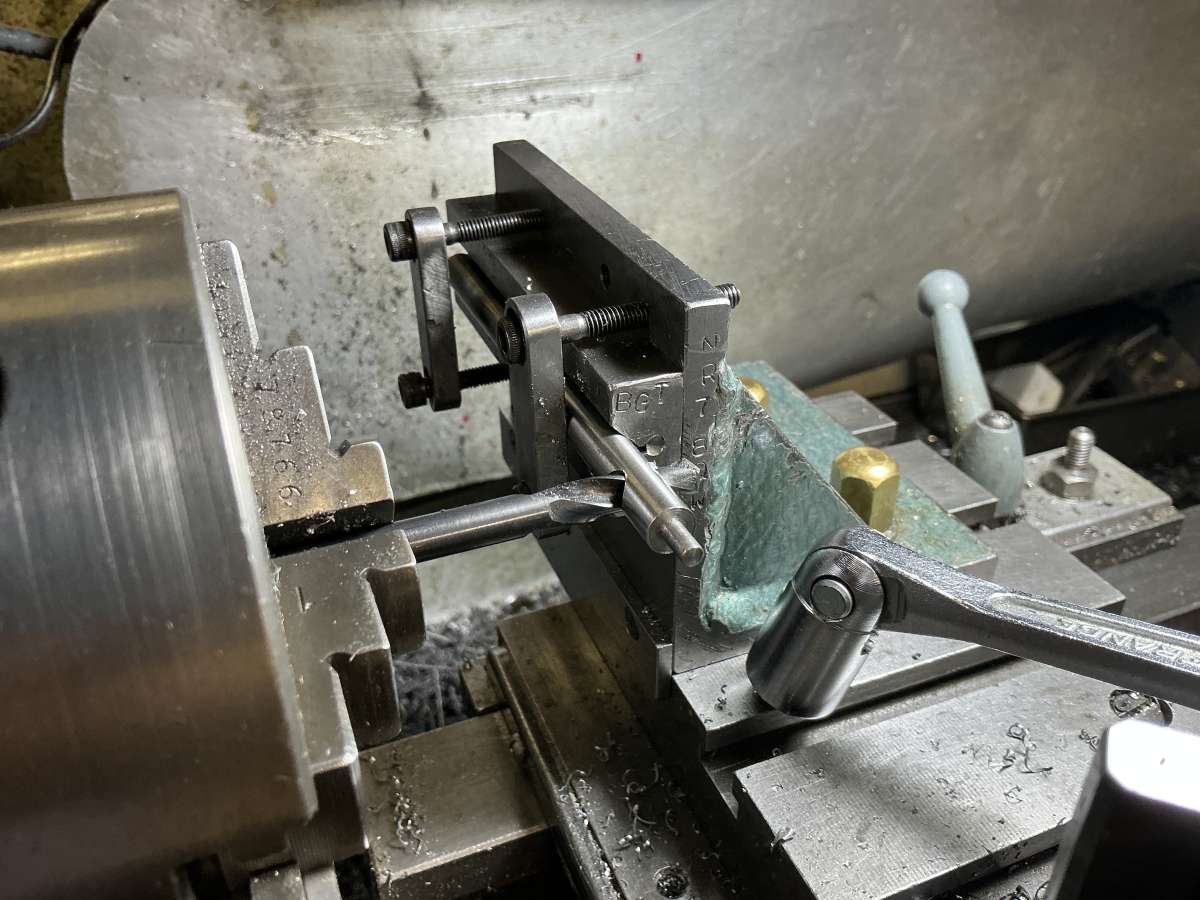

                                        #867405
                                        bernard towers
                                          @bernardtowers37738
                                          Regardless of what lathe you have a cross drilling jig is a must have. Zero setting up and perfect job every time. can be used for a lot of jobs like screw slotting, square and hex facing you are only limited by your imagination. dont understand why everyone doesn’t have one. I think original came from early MEW

                                                #867611
                                                bernard towers
                                                  @bernardtowers37738
                                                  The cross drilling jig I mentioned earlier can be fitted in less than 30 seconds! And it’s set and ready to go no faffing around with edge finders etc. I fitted it today and drilled the hole  in 8 mm bar in less than 3 mins and on measuring the material left on either side it was less than a thou out (with my measuring gear). It’s been in use since 1993.IMG_4178IMG_4176IMG_4179IMG_4180
                                                  #867616
                                                    Don’t think the OP’s Southbend has a slotted cross slide so not so simple to fit in seconds.
                                                    #867619
                                                    bernard towers
                                                      @bernardtowers37738
                                                      Maybe its time to get a bit creative?
