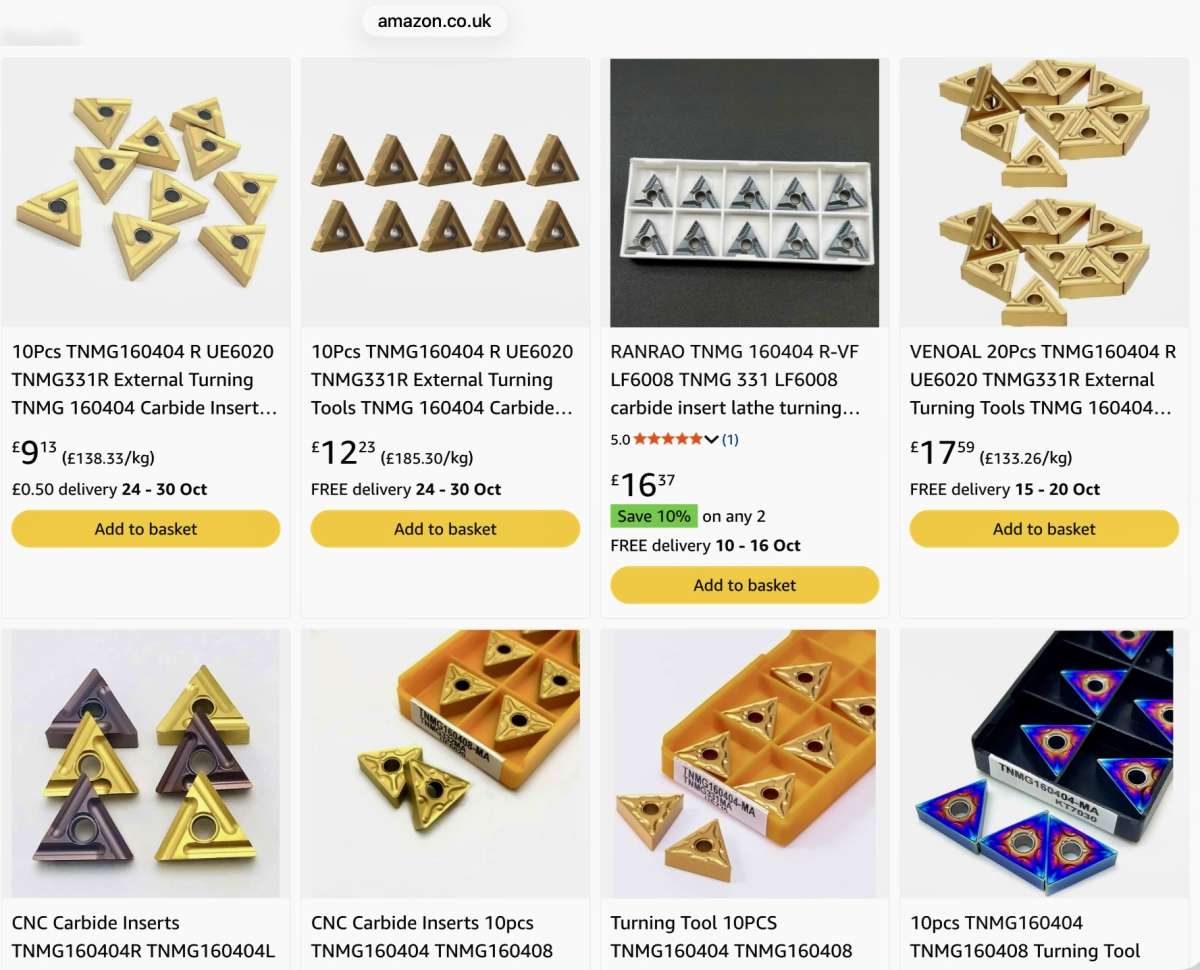

                  @vic
                  I use standard TNMG 160404 inserts on my little 8 1/2” x 14” lathe. Having six cutting tips and costing a similar price to CCMT inserts they work out at 1/3 the price and work very well. Being a fairly standard insert they are available in a huge range of different types. I use them on steel, stainless steel and aluminium alloy. The only issue is that I had to trim the tool holder down to fit my four way tool post. Easily done with a carbide end mill.
                  I got my last lot of Aluminium cutting inserts on Amazon but there are even cheaper places.
                  IMG_3939
                  Edit: I also use the same style TNMG 160404 inserts on my milling machine and get a great finish.

                    I would not use TNMG16 inserts in holders less than 16mm square. The WNMG 06 and WNGT06 are small enough to fit well into 12mm square holders and share the 6 cutting edges with the TNMG type. These are all neutral inserts with square edges which must fit in holders that tip the cutting edge down 7 degrees. Smaller lathes would probably do better with Bernard Towers recommendations although they only have two edges per insert.
                    The Warco set is of rather primitive design, sets are available that are better.
