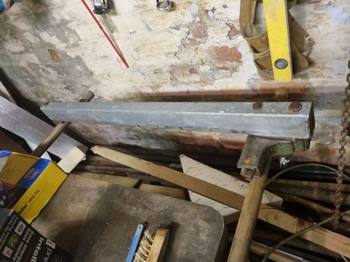

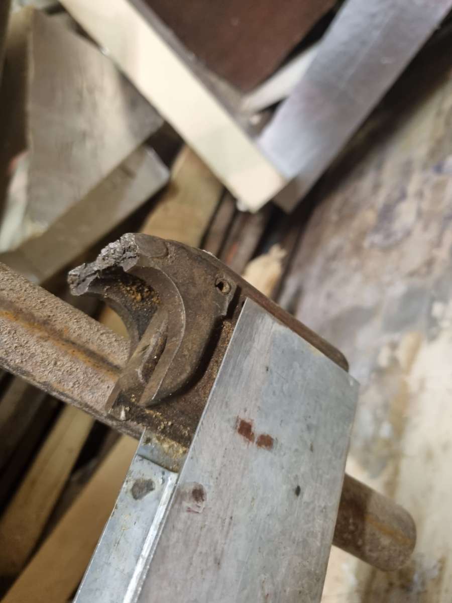

      Hi all
      I have inherited my Father’s workshop, and although he had everything he needed, most of it is rough and needs TLC.
      The Wadkin AGS10 is rough, and a lack of extraction hasn’t helped.
      I got a new V-belt and it’s cutting OK – so I will spend some time getting it cleaned up and safe before spending money on a new Blade and getting the extraction/vac hose fitted.
      Firstly, the Fence is broken. It’s been fixed/messed-with previously, and I want to get that resolved.
      It is the back clamp piece that is broken, and I’m hoping that I can either find a replacement part or else repair it properly. The business-end (Clamp) seems to work fine, but it just doesn’t have enough meat/grip on the back fence slide bar to make it square. So it can actually be like 1/4″ out and needs to be squared up manually.
      IMG-20251115-WA0001IMG-20251115-WA0002
      Does anyone have a spare part I can buy at a reasonable price, OR could anyone send me a few pics and details of the part so I can determine how far that hook needs to be and any other details that I would need to add?
      If I can get it right, I will buy some nylon for the fence and get it perfectly square and running smooth.
      Cheers

        That looks very similar, if not identical to the fence clamping arrangement on my Startrite saw bench.  Have you tried contacting any of the big woodworking machinery dealers to ask about spares?  Scott & Sargeant in Horsham come to mind and I’m pretty sure there is someone specialising in Wadkin stuff up around Amersham way.  To be honest I think you will be lucky to find a spare but I suspect it would be a fairly simple to have laser cut and welded together.
        If I remember tomorrow I’ll grab some pics of my fence clamp for you.

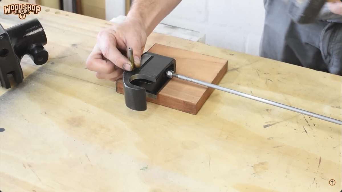

              Not used one for a long time but this video shows the end is a complete U shape. Squaring up should be taken care of at the user end and the far end just pulls the fence down when clamped. You may have play or the far end is dragging.

                Thanks Jason
                Yep looks like semi-circle and a straight. duplicate of the opposite.
                Also looks liek there is nothing else to complicate. I will watch the clip and do more searching tomorrow.
                Screenshot 2025-11-15 at 20-53-02 (2) I Was Given A Fence! - Can I Get It Looking And Working Like New - YouTube

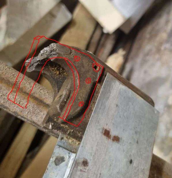

                                    I think I would be inclined to mill each side down to about half thickness and tap for some screws. Two 5mm steel plates with the “U” shaped cutout and matching holes would not take long to make.
                                    Does not really need the gap between the plates filling in at the bottom as you will have the two plate edges to clamp the bottom of the bar, certainly enough for hobby use.
                                    saw

                                      My instinct (I think like SOD’s) is to get a lump of steel (45x60x45long) and 4-jaw in lathe to Drill it. drill/mill the bottom (2 deep slots), then band saw and belt sander. Then mill or grind the part to 50% to semi circle. Possibly pin it and have it brazed.
                                      Jason – as always, you have arrived as a much simpler and damn good solution, and I’m gonna draw it up tomorrow.
                                      BUT I wonder if I could make it out of Square section Tube – so that I can remove one face and have that bottom filled and more strength. Else get a piece welded for same.

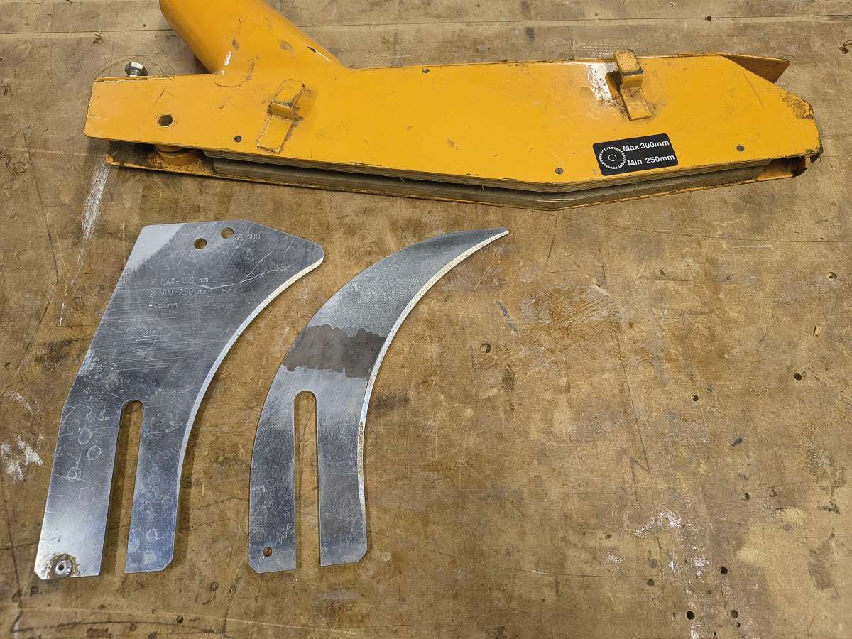

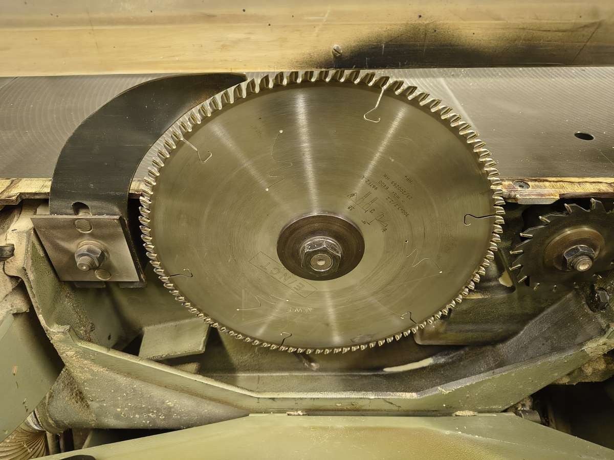

                                        Danni, the inner radius of your riving knife only needs to be slightly greater than the sawblade radius, it also needs to be slightly thicker than the blade and the leading edge is usually slightly chamfered. The outer profile can be any shape, threr is usually a slot to attach it to the saw bench, and some holes at the top to attach the crown guard.
                                        These are from an SCM panel saw.
                                        IMG_20251118_171254752_HDRIMG_20251118_171538840_HDR
                                        Mark.

                                          If not clear from Mark’s photo the knife on the left is for a knife mounted crown guard the one on the right if it has overhead support.

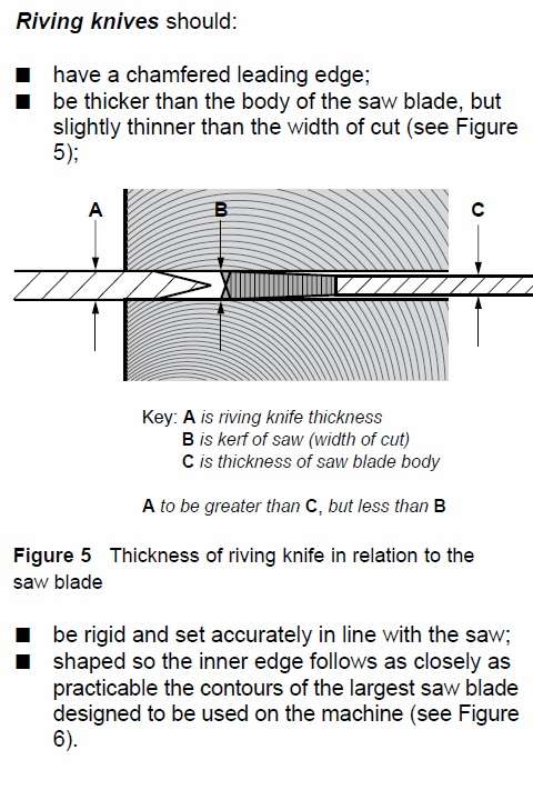

                                          Knife should be thicker than the disc of the blade but thinner than the overall kerf left by the blade.

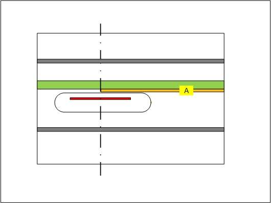

                                                  Hi Mark, and thanks for the pic and link. The HSE doc answers some of my questions. I could certainly draw/make a smaller Riving knife now. I think I had in mind a larger one where I could attach a crown guard to aid with extraction; however, I will probably scrap that idea (not wanting to pay silly money for parts), and will find another way of clamping an extraction hose nearby (top-side). The underneath extraction is going to be another problem.
                                                  I didn’t fully understand the full fence discussion. Jason, by ‘Short subfence mounted to the full length one’ are you saying that a fence is safer from the front of the table to 50% of the saw blade (so the material is not sandwiched and wants to lift/fly)? See below ‘A’:
                                                  Jason half fence
                                                  That should be easy enough to do with a nylon strip, or better, a snug C-channel that can cover the fence and be removed easily.
                                                  NOTE that the saw blade is depicted in Red for danger for any of our colour-challenged readers.

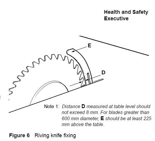

                                                  Also, below is the pertinent info from Mark’s HSE attachment, re. Riving knives.
                                                  Fig5
                                                  Fig6

                                                    Around that sort of position, mainly so the strip of wood can’t get pushed into the rear of the blade which can pick it up and then as the top of the blade is moving towards the operator it gets thrown backwards.
                                                    That is another reason the knife mounted crown guards are quite good as they can prevent work lifting too far off the table. If you have acces sto a 3D printer I expect one could be printed complete with dust hose port
                                                    You could have slots in your nylon face so the position can be altered or just make a couple of different lengths.
                                                    I do prefer a full length fence when working with sheet material as it is easier to feed an 8ft length straight when there is more fence for support but don’t lock the far end. My sliding table is quite small so can’t use that to guide large sheet material.
