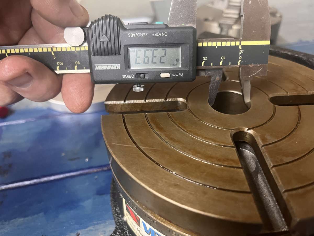

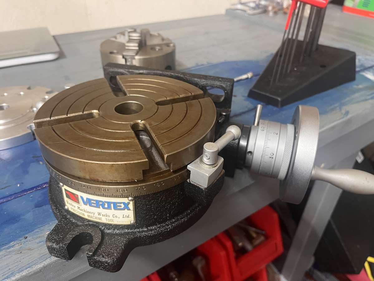

      Good evening guys
      I have a Vertex 150mm rotary table and I’m a little baffled, according to the manual and certificate that came with my RT the center bore taper should be MT2.
      however weak I measure the top diameter, being the widest it’s reading 23.8mm this should be MT3 at this dimension. I’m wanting to make a taper to help with alignment instead of using a coaxial indicator each time I mount it on my mill.
      can anyone help
      Martin IMG_4789IMG_4787IMG_4788

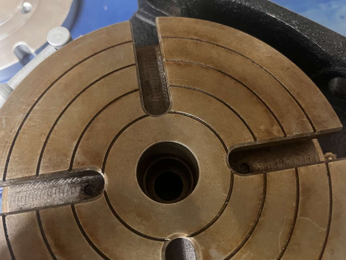

          Thanks for the reply to my to my post. I have a MT3 dead center but it’s too long to drop down inside. It looks to me that the center bore is stepped, perhaps the MT2 taper stated in the manual is at the very bottom of the bore.
          if you look at the pics you can see what I think is a step inside the bore…

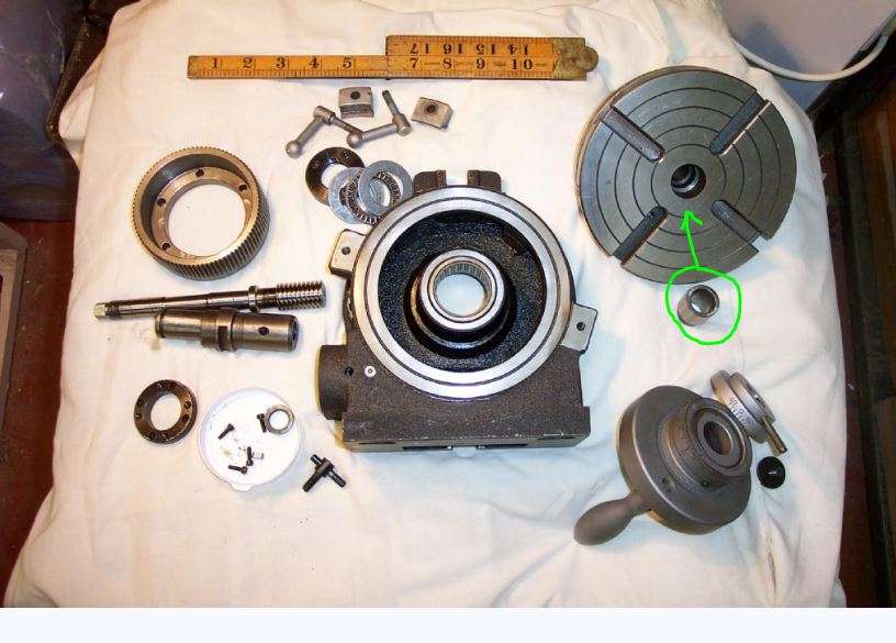

                    Not unusual for these and the far eastern ones to have a bush with the MT2 internal taper, maybe your bush has been lost. You can also see the step that the bush fits up against which is probably the step you mention stopping the MT3 going in.
                    bush
                    #823148
                    Diogenes
                      @diogenes
                      Jason got there first, much of this probably redundant..
                      “Okay – my older three-slot Vertex has a plain full-length MT2 socket that extends to the table’s surface, it is 17.XXmm at the gauge line / mouth.
                      It looks like yours has a ?24mm ?parallel socket – arguably a better system anyway.

                                So tonight I broke out my snap gauges and measured the bore in the RT, from the top to the step half way down the bore it measured a parallel 24mm exactly.
                                So as Jason suggested this may have been lost at some point in the past.
                                Knowing that the bore is parallel and not tapered, I’ll machine a spigot to help with lining up on the mill and to assist with mounting my 4 jaw chuck on the table..
                                Once again thank you all for your help, it’s very much appreciated indeed!!

                                  The Soba rotary table that I bought for the museum is a clone of the Vertex and works well enough, and that has what looks like a MT2 sleeve in the centre of the table. What I mean is that it is MT2, but until seeing this thread, I had not suspected that it may be removable. Is the larger bore parallel or a MT3?
                                  If the bore is the same as Martin Currie’s one it might be possible to get a MT2 sleeve with a parallel OD and use carbide inserts to reduce the diameter of the end to 24mm, or there may be enough wall thickness in the top of the table to increase the bore to match a sleeve. I’m not back at the museum till Saturday, so cannot measure one of our MT2 sleeves until then. A sleeve could be cut carefully with an angle grinder to make an adaptor.
