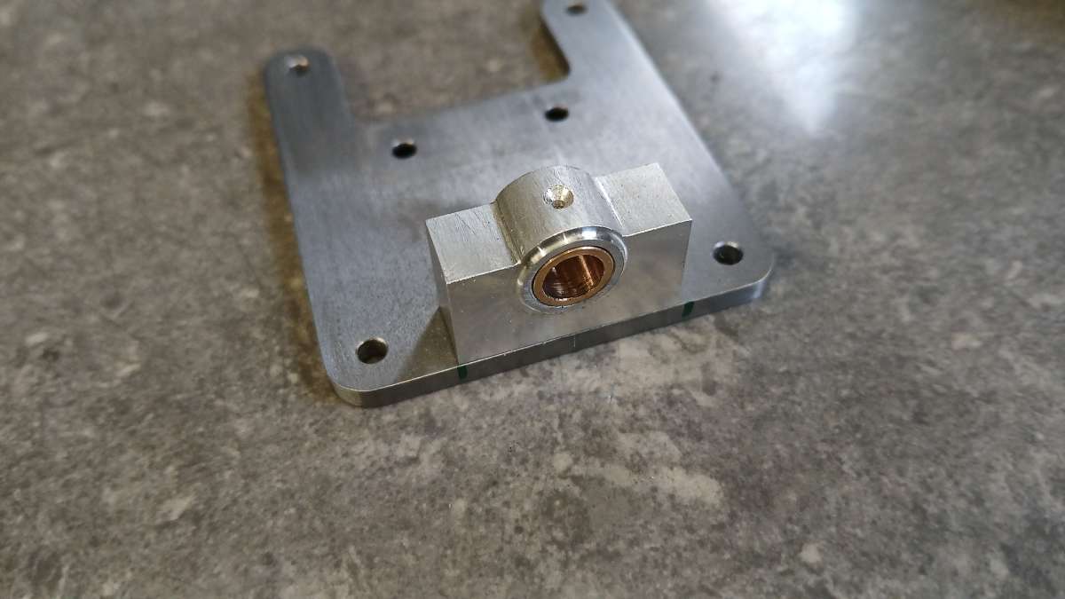

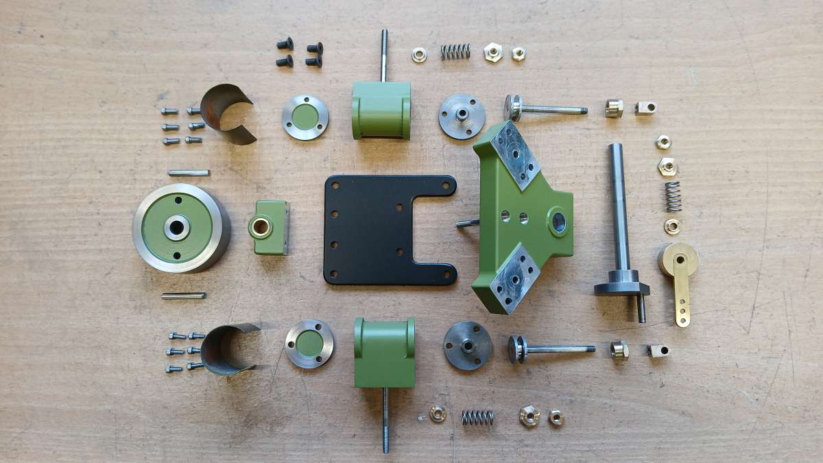

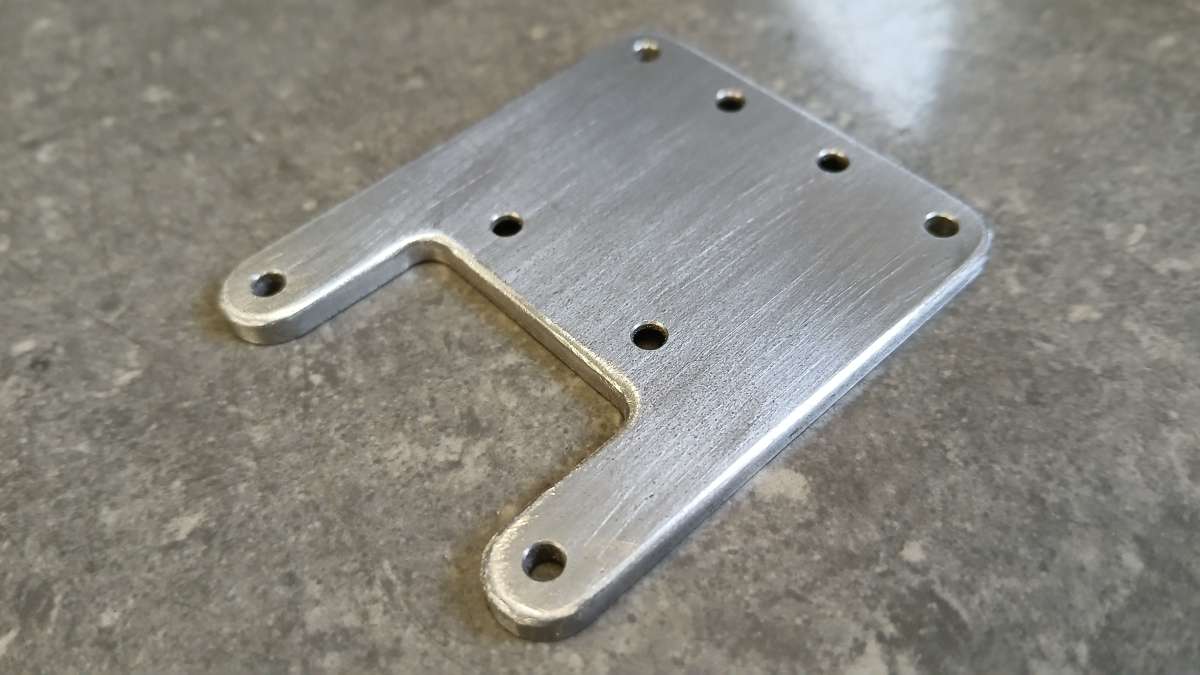

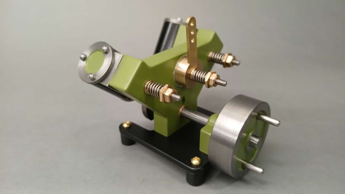

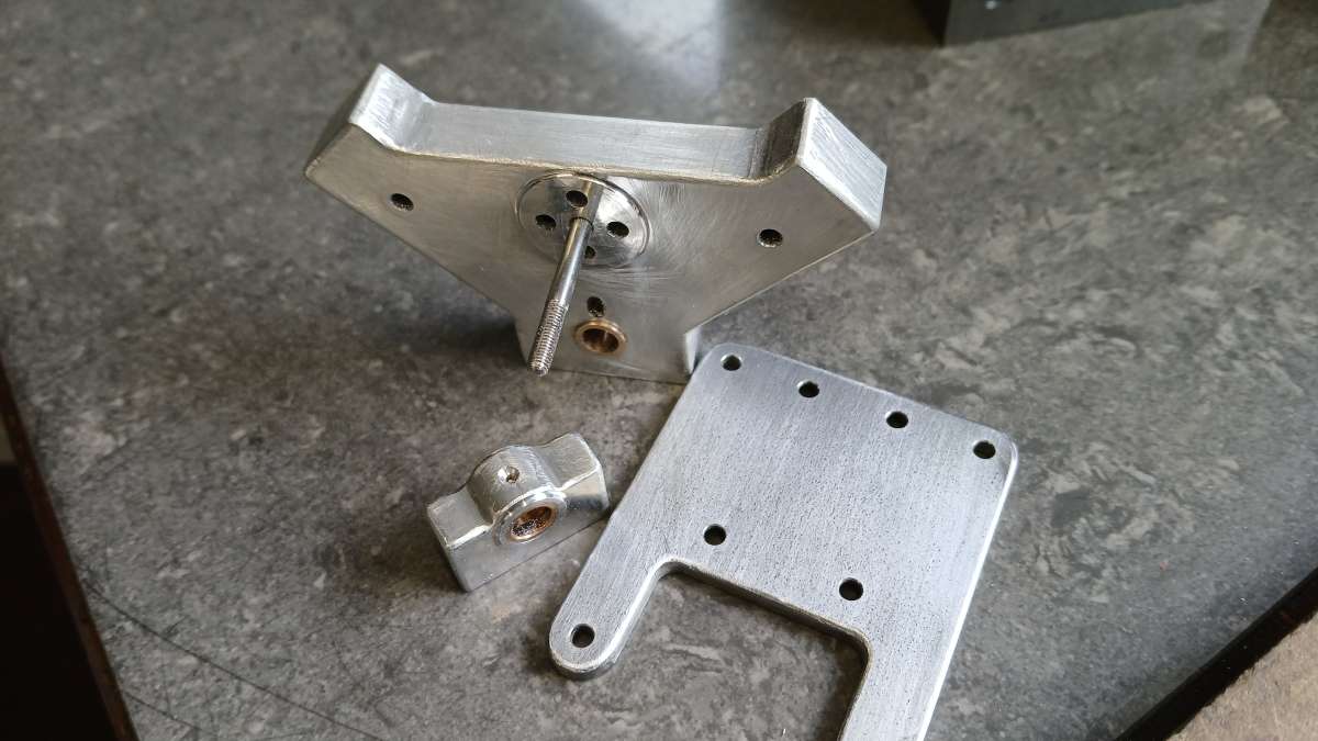

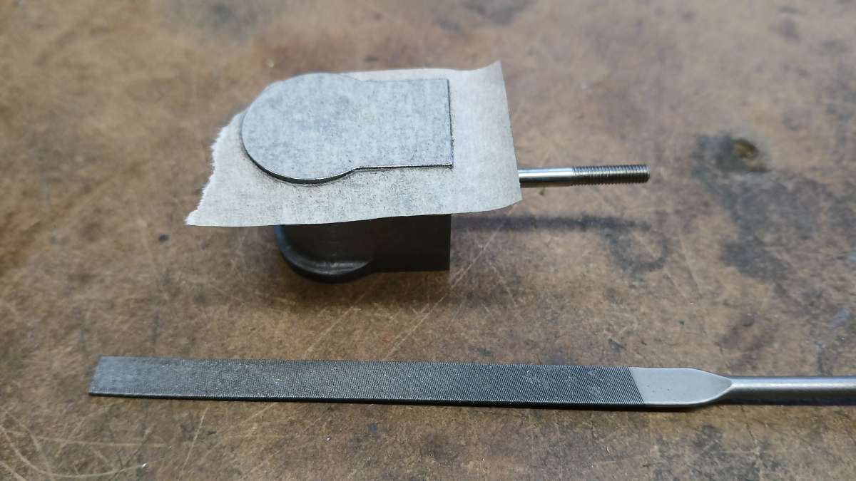

          With the engine tested one of the last jobs that can be done is to soften the “barstock” parts so it looks a bit more like a cast engine.
          If you left the standard and bearing block at their full thickness then they wil be flush with the edge of the base so mark the edges where the are flush as they want to remain square.
          20251128_113530
          If like me you recessed the flat areas they will actually be sitting back from the bases edge so the whole edge can be rounded over. Although round over cutters can be bought they leave a very regular radius so I prefer to knock off the corners with a file, here the whole of the base has been done.
          20251128_114221
          The same can be done to the standard and bearing block. Leave the bottoms square as well as the edges to the port faces but everything else can be done.
          20251128_120142

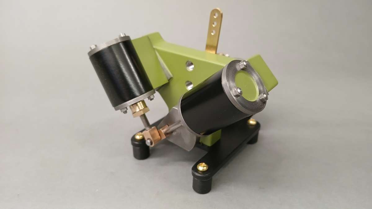

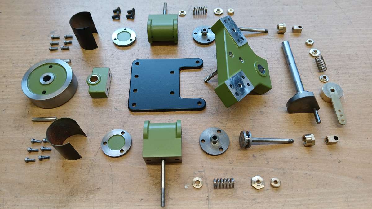

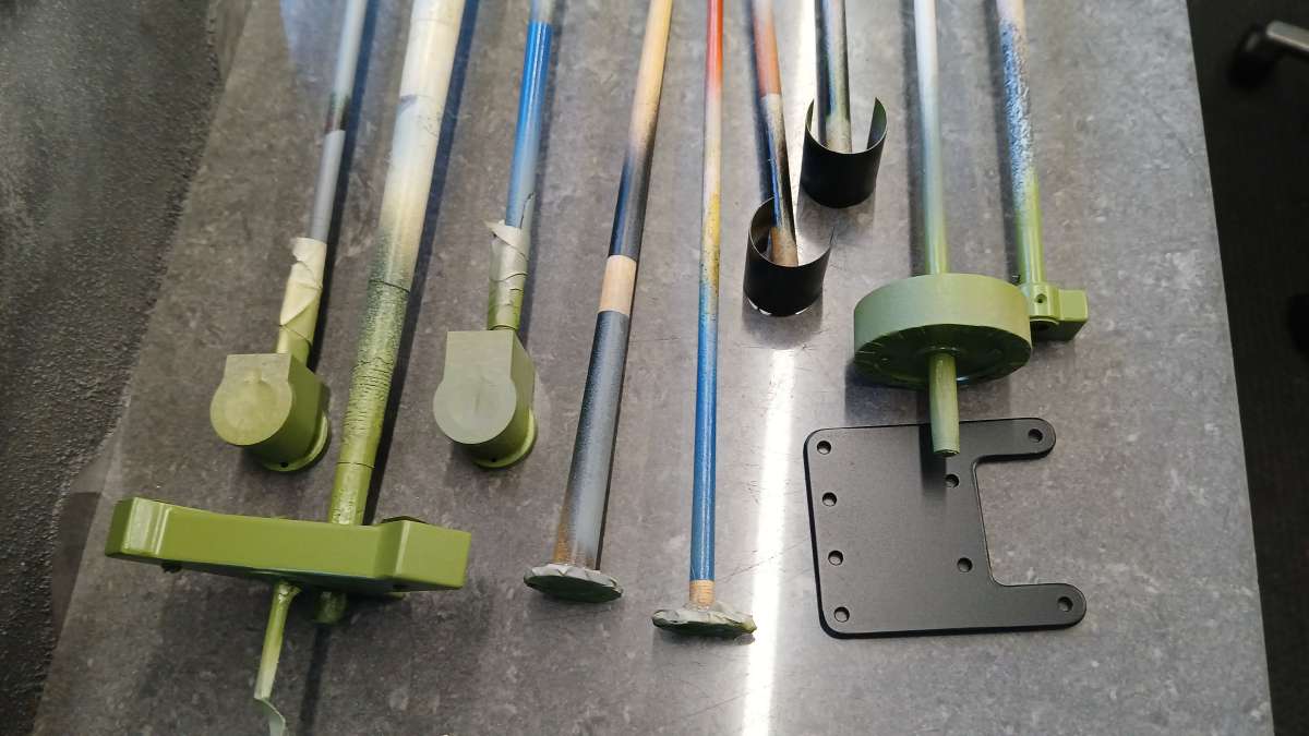

          The last thing to do is paint the engine, so after a clean with thinners mask of any of the machined faces where paint is not wanted. For flat surfaces the masking tape can easily be trimmed to shape by lightly dragging an old needle file backwards over the corners with the file at approx 45degrees to the surface.
          20251129_090046
          To hold the individual parts I use some old paint brush handles as the taper can be pushed onto hole sin the parts, for items that don’t have suitable holes the end of the handle can be stuck with hot melt glue which easily peels off afterwards.
          The non ferrous metals should first be given a light coat of “etch primer”, then use a standard primer of the correct colour to suit your top coat. The steel and iron parts can also be primed with this. When dry apply the colour, I went with a mix of satin black and a matt apple green.
          20251130_084701
          20251130_092445
          20251130_092511
          20251130_092519
          #828329

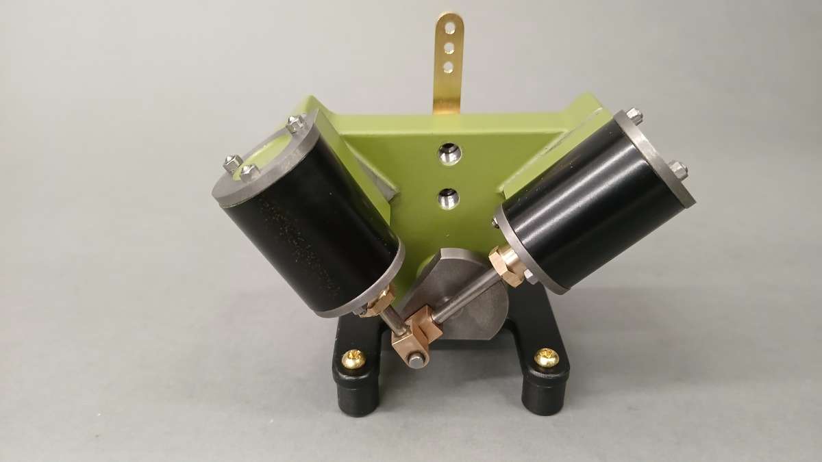

            Although screws could be used to hold the cylinder covers on a mor etraditional look i sto use studs and nuts. As the covers are only 2mm thick there is not much point in trying to make studs with an unthreaded middle section a sit woul dbe so short. So I just threaded a length of 2mm rod M2, cut into lengths and lightly domed one end by rolling a file over it while rotating in the lathe. A good dodge to get the same amount of thread sticking up above each nut is ti loctite the nut sinto position first which turns then into a hex head screw as you can see in the images above.
            The engine can now be put back together oiling te hmoving parts and adding gland packing and O rings if you want. I did not bother. Not being a fan of traditional gaskets on these small models I applied a very sparing amount of clear liquid gasket to the endcover to cylinder joints.
            As the engine was intended for boat us ethe flywheel hangs below the bottom of teh base which helps with the propellor shaft angle so if just running for display the engine will need raising up. You could machine up a couple of wooden bearers or turn and tap some short spacers that can be held on with screws which is what I opted for.
            20251201_133752
            20251201_133809
            20251201_133841
            20251201_133858
            All that is left now is to connect up with your chosen power source and enjoy. I look forward to seeing a few more of these over the coming weeks and months. Any questions just ask. Drawings have been updated throughout the time I have been writing this build thread and now show all the parts.

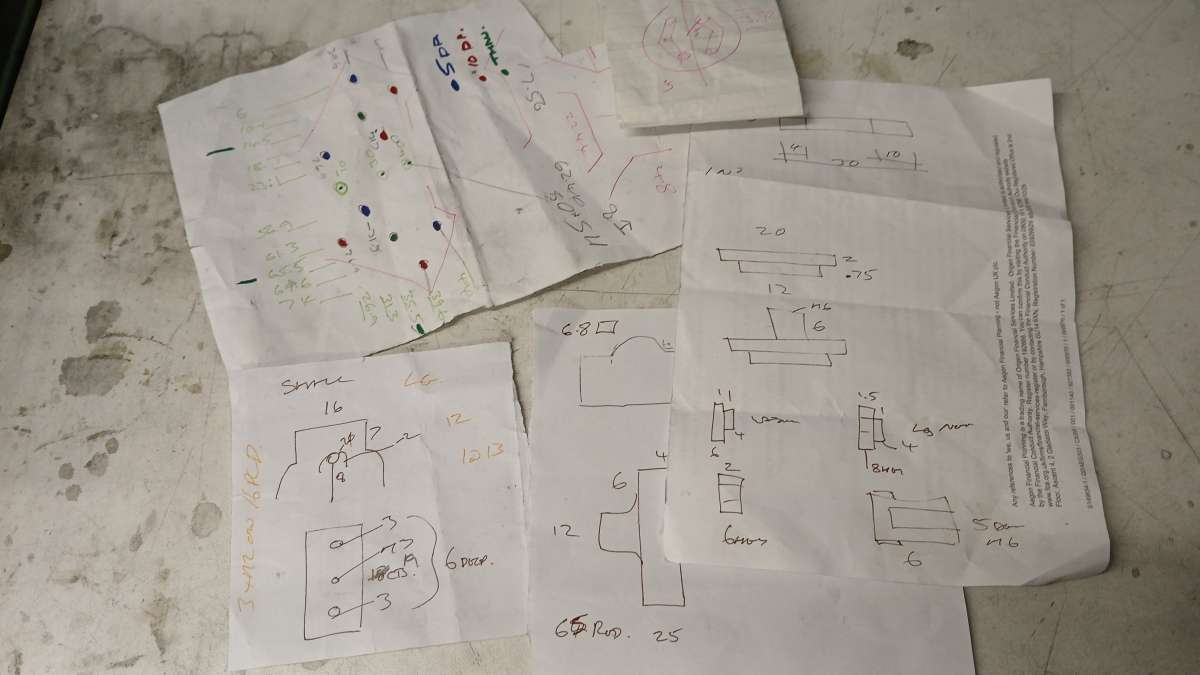

                I think it took longer to write up than to make! Also as you know I tend to just take my working sizes off the 3D model and don’t do a full set of 2D drawings for my own use so that added to the time spent getting it here. Though I suppose I could have just photographed my “working drawings” 😊

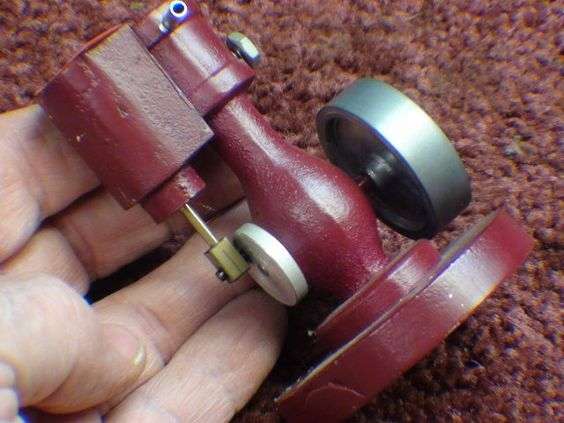

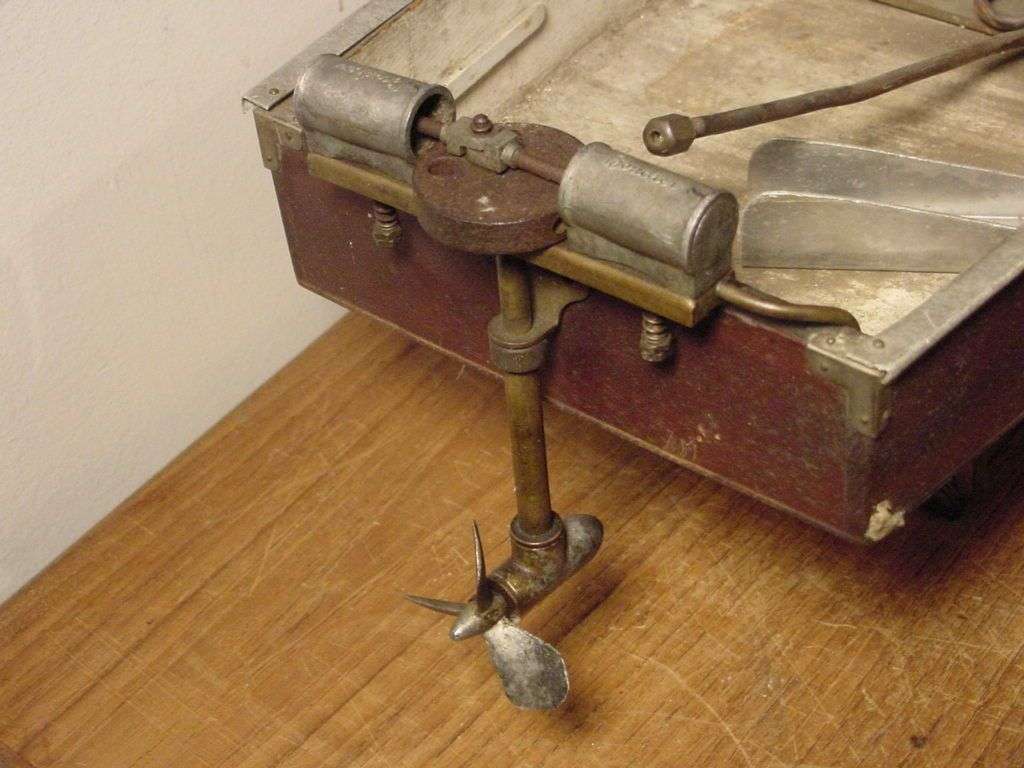

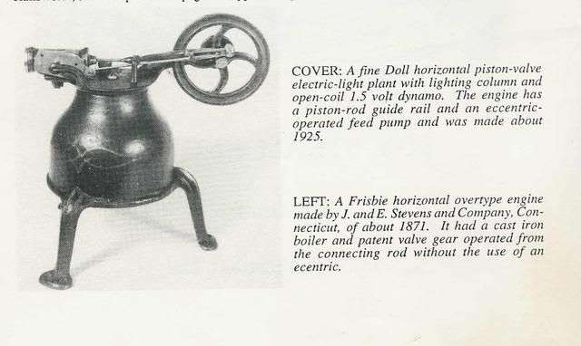

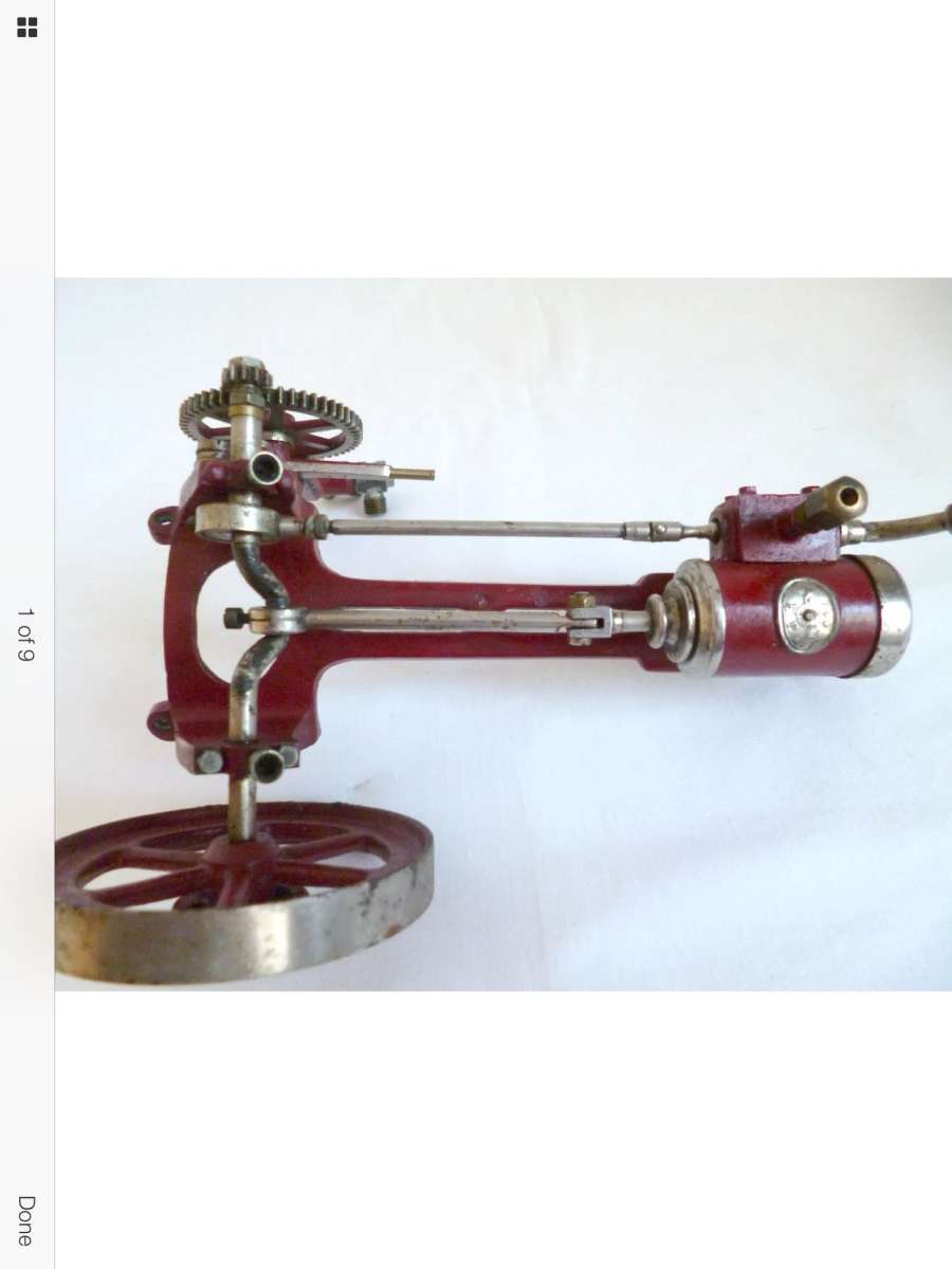

                            Thanks for the comments.
                            The unlimited room of a forum thread does make it easy to add as much text and even more so images to a build description compared to one that may go into the mag where it may appear as packing out to a lot of the readers but is what the smaller number of beginners need.
                            I’m not sure what or when the next build with drawings may appear, The more complex engines would be a lot of work to write up to this sort of detail and there would also be a lot more drawings to produce so I’ll just keep doing those as I do now with some photos and describing the more interesting bits.
                            Luckily I do still enjoy making these smaller engines as something quick between the larger projects, I have a few possibles stored away or like this one something will crop up and I’ll want to get on with it straight away.
                            A few of the smaller ones being considered

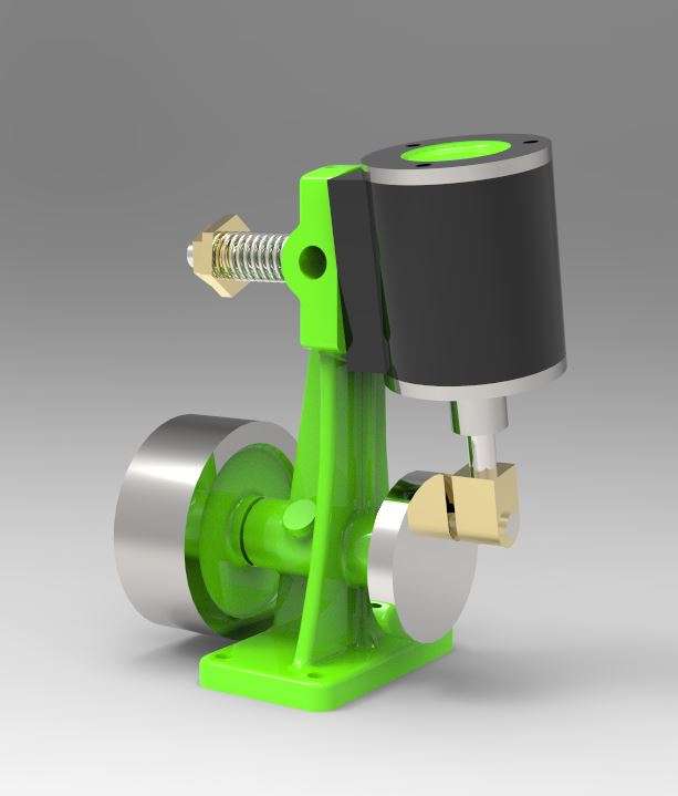

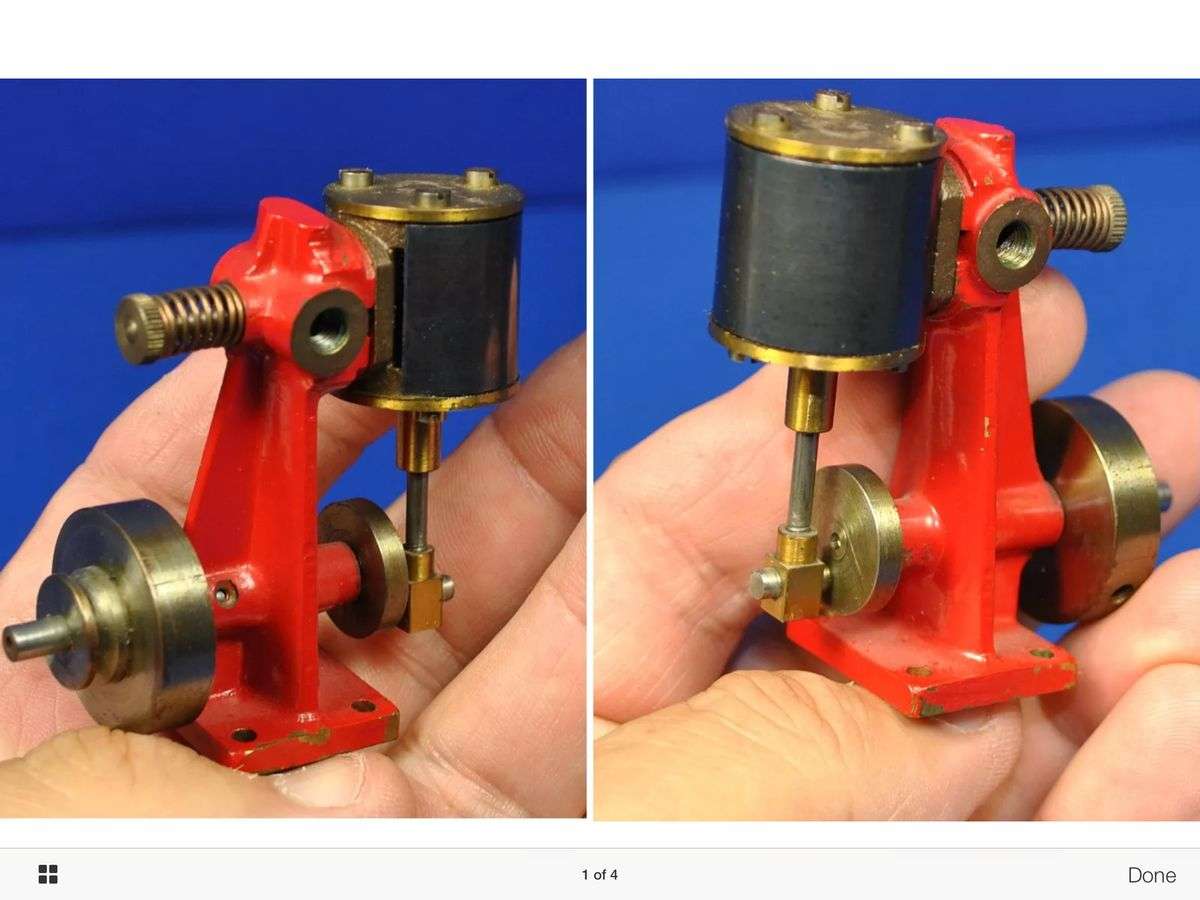

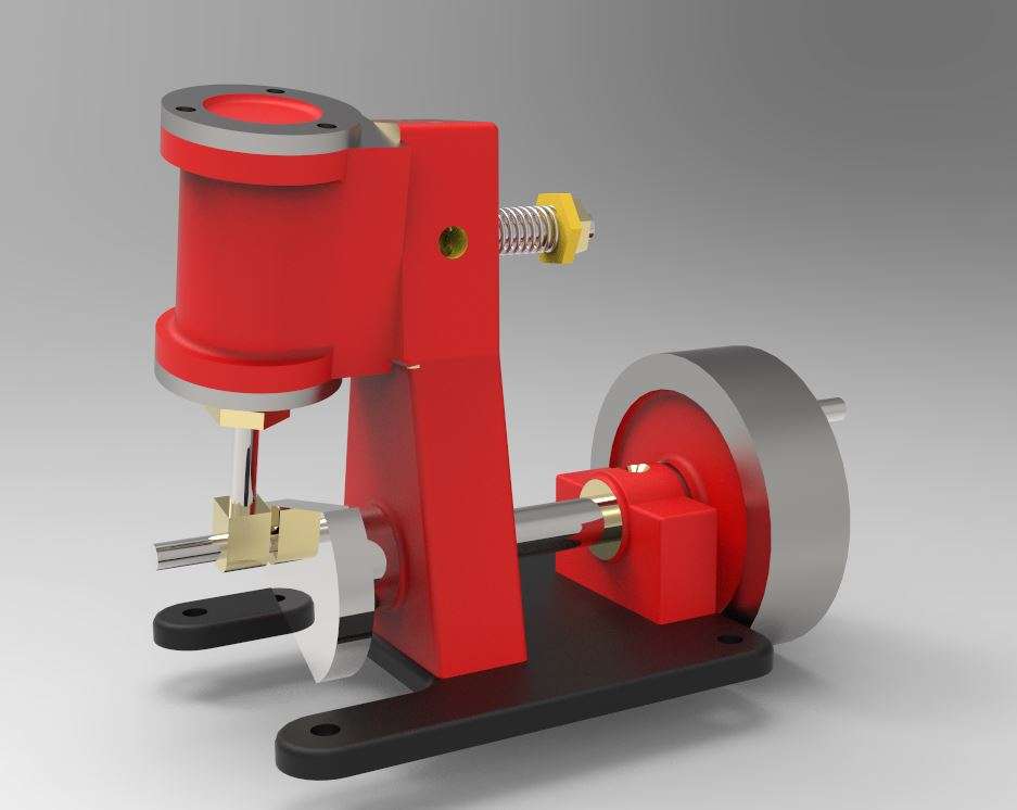

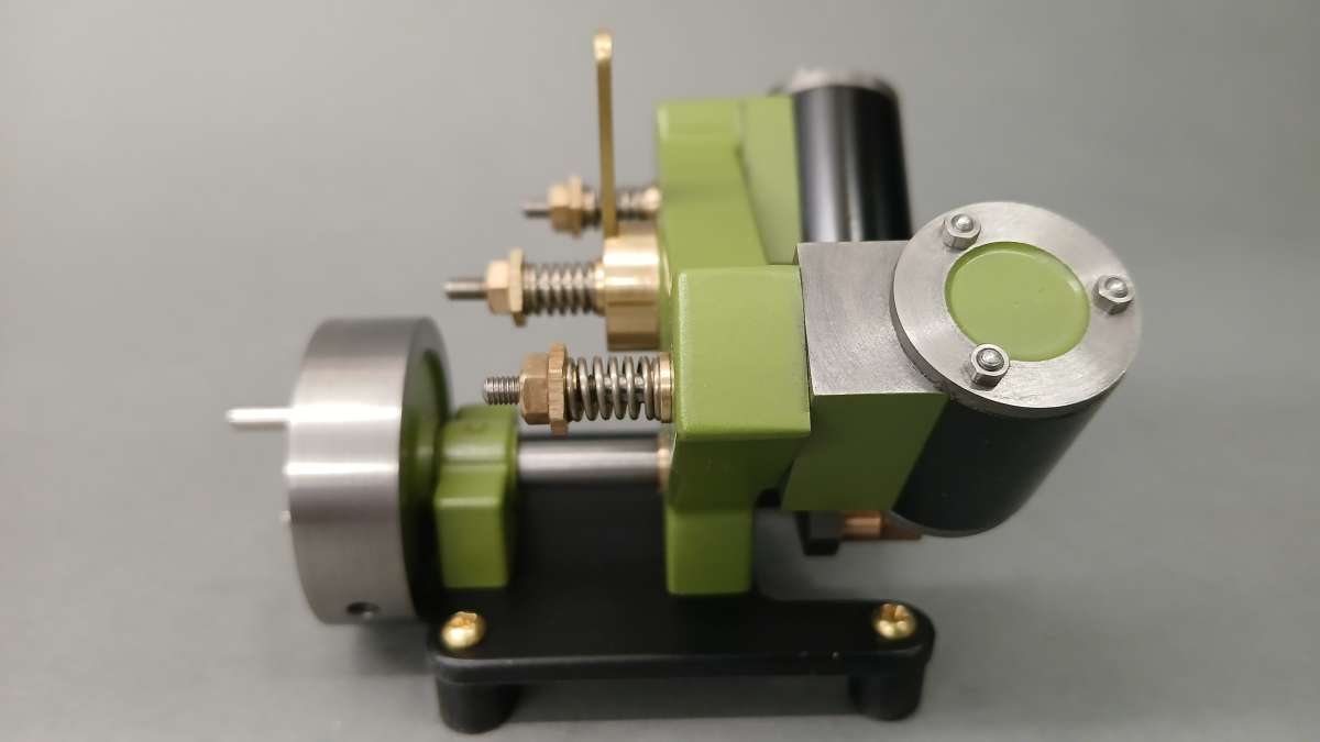

                                  Well it seems Kelsey has another single sister, closely related to the bright red oscillator shown a few posts above. I can see a bit of 3D metal printing in my future.
                                  frog

                                        Order was placed with Craftcloud on Wednesday morning for the 3D prints and due by 1st Jan. Will probably do a new thread for that one but have some proper castings from my own patterns to keep me occupied over Xmas hols.
                                        20251127_122409
                                        20251127_122415

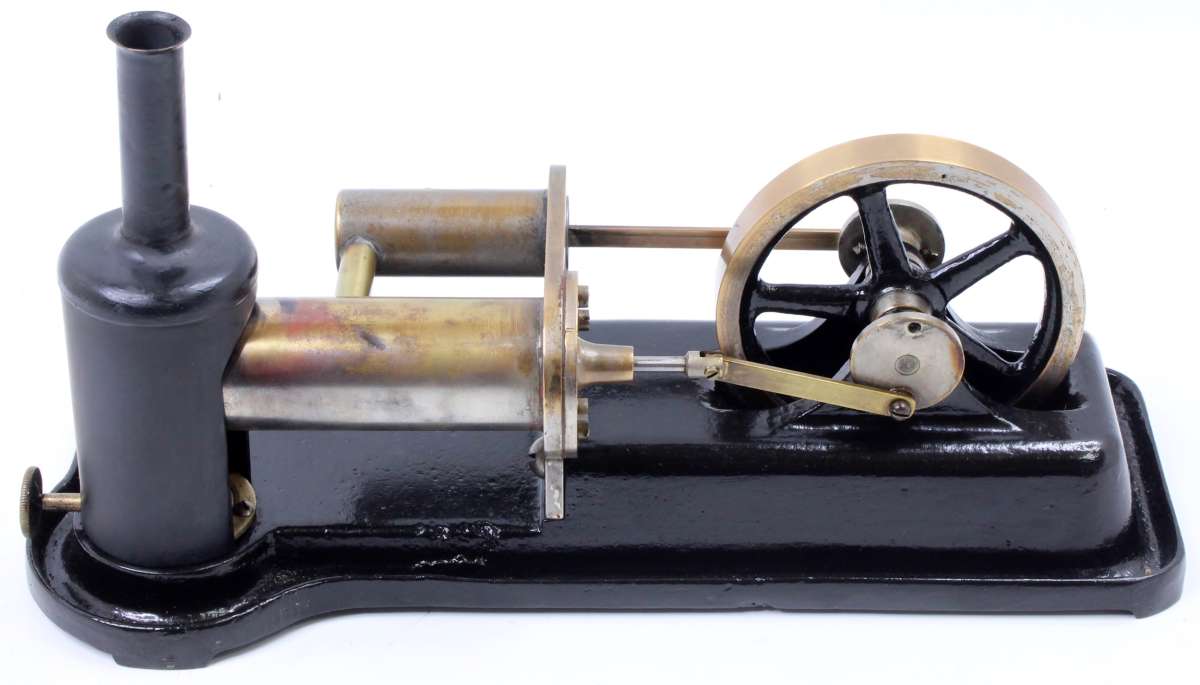

                                        I also managed to find a video of the subject engine as I only had  aphoto to work from previously.

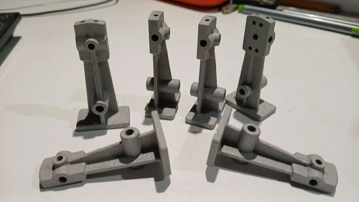

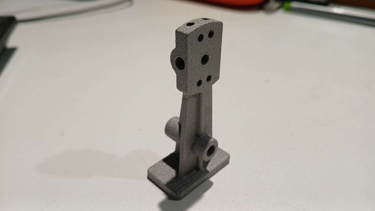

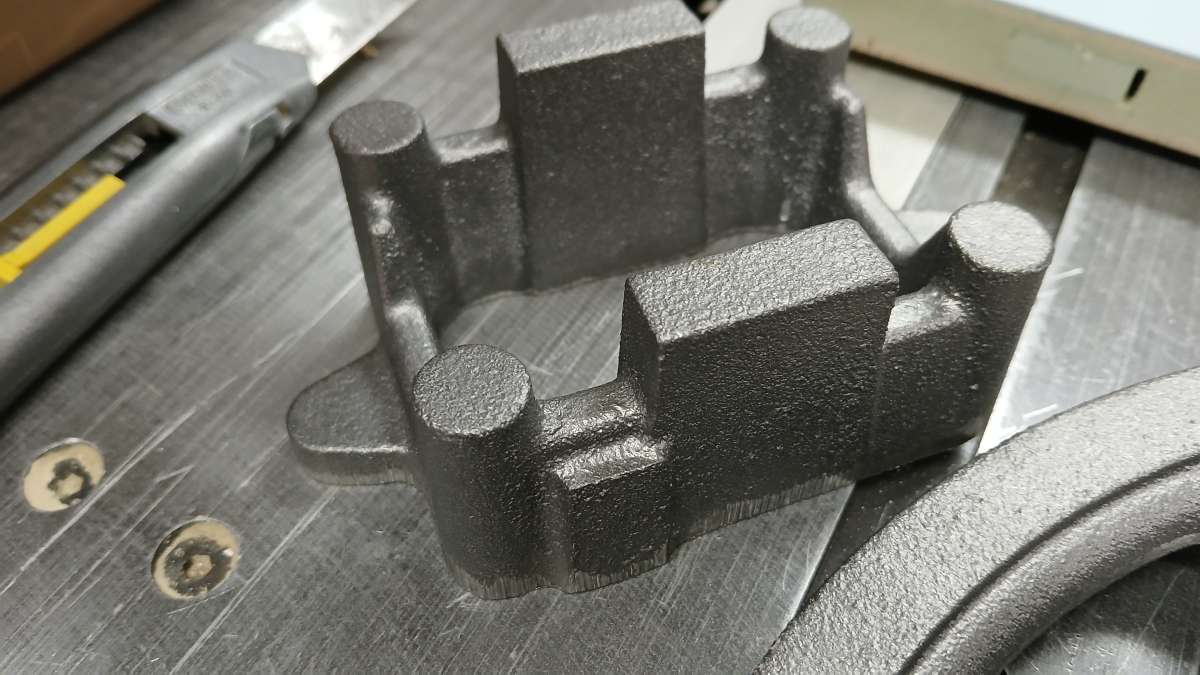

                                              Is there time for another engine before the end of the year? Just arrived, 10 days from sending the file to being delivered.
                                              20251229_093622
                                              Though it will probably just have to be the one engine.
                                              20251229_093607

                                                #830387
                                                  – Well someone has got to do a bit.
                                                  – Craftcloud, Chinese print house via German company.
                                                  – No I did not model the CE logo in Alibre to put on the bottom so just as I wanted. Also no warning that the engine may contain Nuts!
                                                  – Who cares about the Drills, all holes are there but undersize so just need reaming with my reamers from China and Korea
                                                  – Swarf production is underway, you should not need to ask. I hope to have “Willy” the little Wobbler complete before the new year strikes.
                                                  #830431
                                                  Danni Burns
                                                    @danniburns84841
                                                    What material are they? look like cast
                                                    You have an efficient workshop if you can turn one around before NY. Good luck.
                                                    cheers
                                                    #830442
                                                      They are 3D metal printed in Aluminium and I went for the bead blasted finish.
