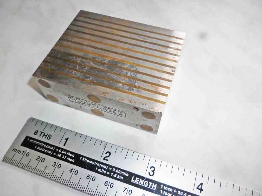

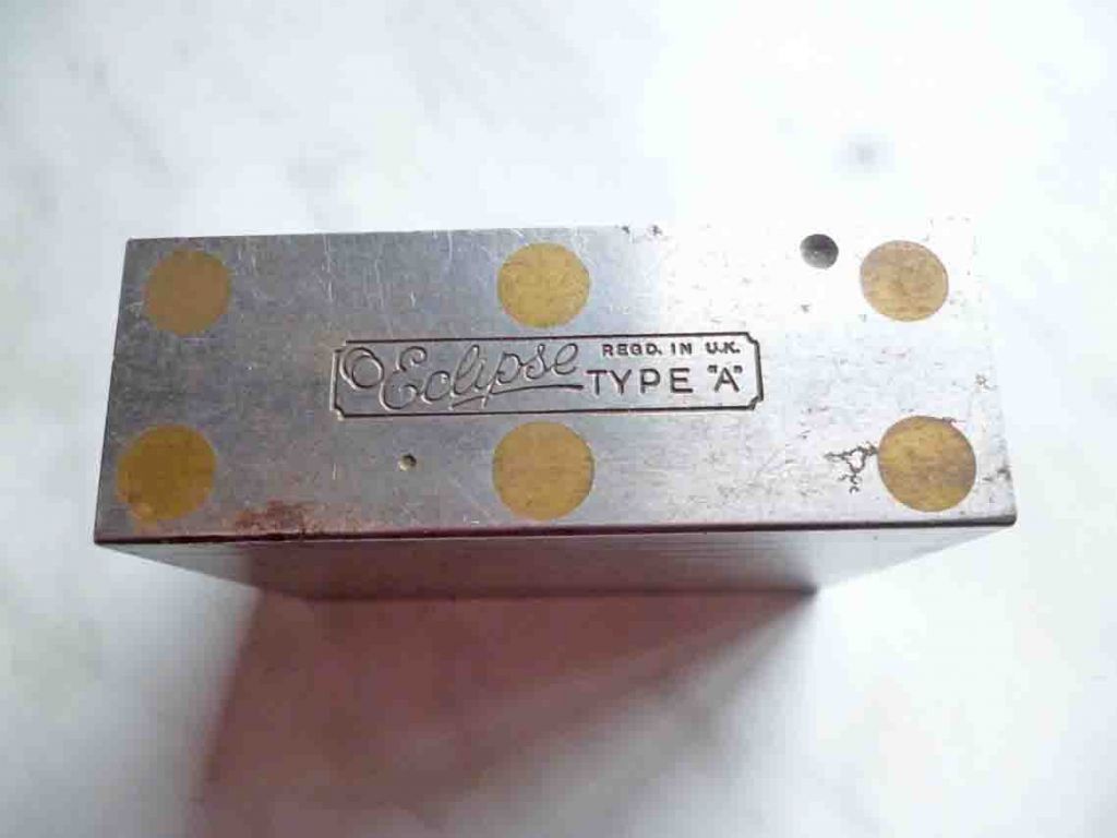

      Hi all,
      Got this today in alot, seems very well made by ECLIPSE.
      What is its purpose please, I first thought it was a magnetic block?
      Cheers,
      Martin

        Steel & Brass ECLIPSE Type A
        #276565
        Mark C
          @markc
          Used on magnetic chuck – usually found on surface grinders for transferring magnetic flux.
          Mark

              @tractorman
              Pretty much just for use on any magnetic chuck. Suppose it could be used for other set ups but it won’t be as resilient as hardened parallels.

                  Yes the idea is to place these on a normal magnetic chuck to get finer gratings for holding finer parts.
                  They often work one way better than the other. You can get various shapes as well up to large section and also available in a vee block format.

                        Martin , Wish I'd got a pound for everyone of these I've assembled and ground up . These Adapter Blocks were normally supplied as matched ground pairs in a polished wooden box to protect them . I started my apprenticeship in August 1965 in Magnet Division of James Neil.
                        If a thin workpiece is placed across the chuck pole piece and the body of the chuck top plate , the throw of the flux is such that it passes straight through the work piece and so in effect only holds it in 2 places per line of flux .The purpose of the adapter block is to shorten the path of the magnetic flux such that all the flux stays within the work piece , and thus holds it much more securely . This shortening is achieved by using alternating laminations of magnetic (steel) and non-magnetic ( brass) materials . Similarly , brass rivets are used so as not to short-circuit the lines of flux .
                        For the block to work effectively it is important that both the chuck top plate and the working surfaces of the adapter block are finely ground and without imperfections . Similarly , as has already been indicated , positioning and orientation over the chuck pole piece and top plate are crucial.
