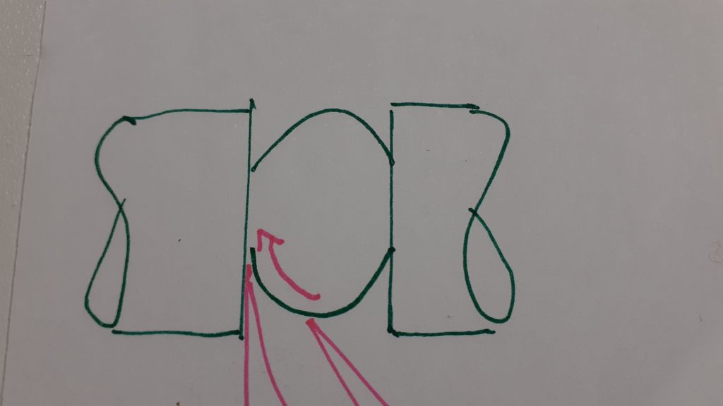

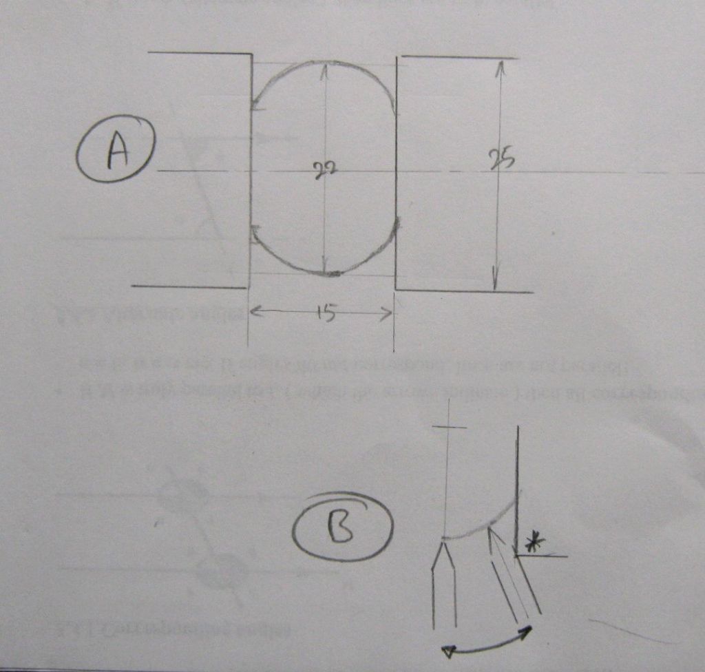

      I'm having a bit of a thick moment as I can't seem to work out how to do the following and could do with prompting!
      I need to turn a partial ball shape between two shoulders.in a piece of brass bar. (A in the diagram) My first thoiught it to improvise a ball turning attachment such as described numerous times in postings in these forums or available commercially. When I looked into the practicality of this there seems to be an issue that they seem fine for turning virtually a complete ball, but in my task, it would seem that the tool would catch the shoulder part way through the arc.(B in the diagram) on bothe sides.
      I just don't want to spend ages fabricating a jig that doesn't do the job. Anyone have any ideas please? Ropey sketch attached.
      Even if I was to grind one side of the tool, I would need both a LH and RH version which would involve problems setting up to achieve a consistent curve, These are decorative only so no great accuracy needed but still need to look right. The original items were probably cast brass. I only need to do 2 of these so I don't want to overdo the time & technology here!
      Any ideas appreciated. Regards Mike

          A form tool is the obvious answer … but with the considerable risk of chatter.
          Removing most of the material with a series of grooves would help !

            As michael says a simple form tool will do it. Drill a hole in some gauge plate and then cut in half and shape the ends to your profile
            Then feed into the work, these were 9/16" dia, I did not take any roughing cuts just fed straight into the brass

              Definitely form tool, as it's brass chatter shouldn't be too much of a problem. If it is slow the RPM down until it stops, also use a centre if the part allows?

                    If you do want to use the ball turner then you need to modify the cutter so it will cut to one shoulder and then reverse the part in the chuck or between ctrs and do the other half of the curve
                    Alternative if it's a one off is to work out a few co-ordinates to rough out teh shape
                    Then blend the steps with a file

                        I suggest you mill the spherical surface. With the milling cutter axis normal to the workpiece's axis, if the workpiece is rotated, a 'hollow' rotating cutter – or a single-point tool – will produce a sperical surface. (This is because any slice through a sphere is a disk.)
                        In this case, the cutter diameter has to be the distance between the shoulders. The cutter's form (in this case) has to be hollow, internally bevelled, with effectively end-cutting teeth. Think of a 'solid of rotation' formed generated by a tool like the one on the left of Jason's sketch, or think of a hole saw, with its teeth tapered so it gets as far into the aforementioned corner as is required; a single-point tool works also, of course. The workpiece is slowly rotated as the cutter is fed radially. Perhaps a good idea to remove the bulk of the material with a more hefty cutter – you can use a single-point cutter in a boring head. Milling spherical surfaces is fun, and a good talking point…

                            I would probably go for the form tool. While chatter is likely to be a problem, you can often clean things up at the last by turning the job very slowly, with a mandrel handle if necessary. You don't try to take a real cut, just keep some scraping pressure on as you slowly turn the job. This will usually clean up the chatter marks.

                              I had initially considered using a form tool of some kind but then thought the chatter could be excessive due to the 'length' of the cutting edge. As several of you seem to give it a thumbs up anyway, I'll give it a test, keeping in mind some of the comments on technique, and see how it goes.
                              I'll also try Roy's idea of using a graver by hand on a test piece just out of interest.
                              For the type of job this is, I don't think it will be worth my time fabricating a proper ball turning jig.

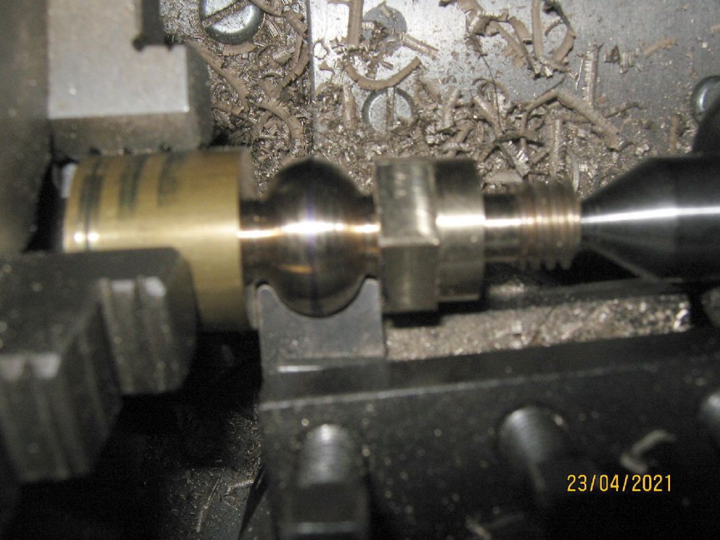

                                The form tool worked a treat! Initially tried untreated gauge plate but even with ordinary brass it soon took the edge off surprisingly. So hardened & tempered best as I could and that was fine afterwards. Step-cut much out with a parting tool and the form tool finished it well. (Note the shape is deliberately not a perfect shere). Again, thanks for the help.
