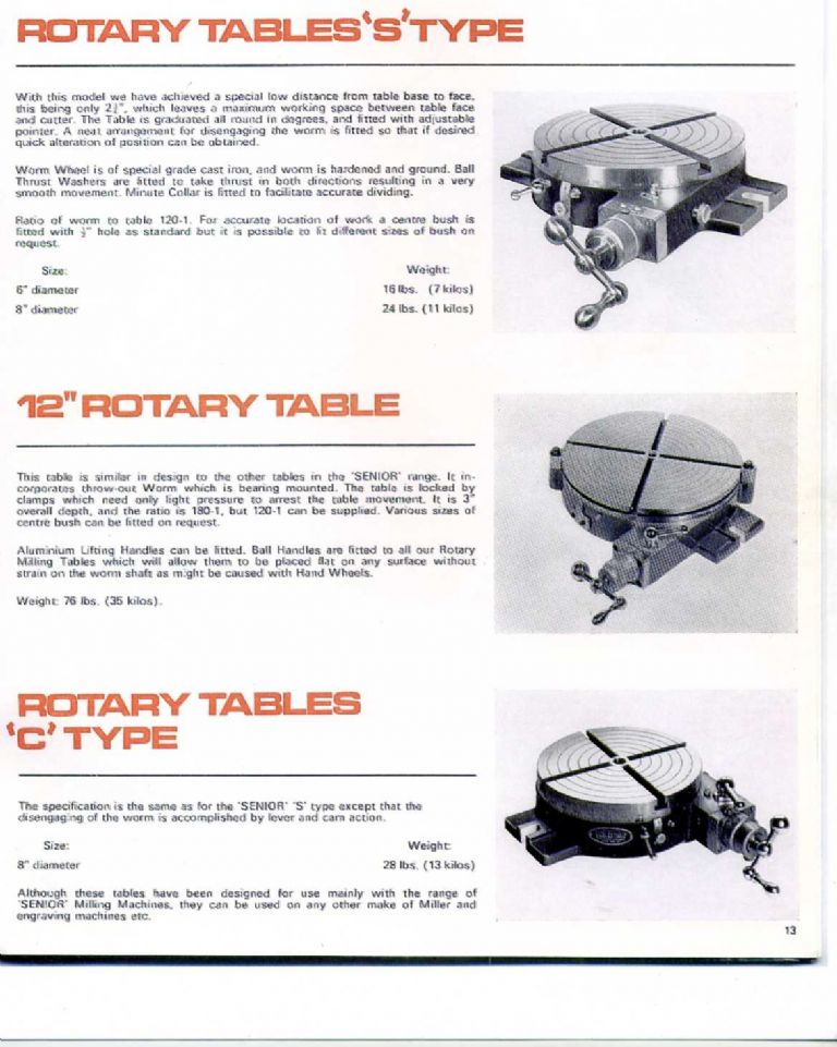

                Hello Mike, I've got a nice unmarked 8" Tom Senior rotary table , just like yours, I use it on an M1 mill.
                Here is a page from the Tom Senior leaflet describing the various rotary tables.
                Richard.

                  Thankyou Gents – I now know that I also own an "S" type.
                  It's a great design because it's so low …. but mine looks a lot rougher than yours, Mile. Still does the business though

                      Thank you Richard !
                      I can see that I have the "S" or screw type engage / disengagement system also. Guess there's no real difference, other than just a matter of convenience for operation in some instances ?
                      As Will says, it is a great design, just 2.25" high, and the quality is outstanding compared to todays imports; don't think I will be having any future issues with this tool.
