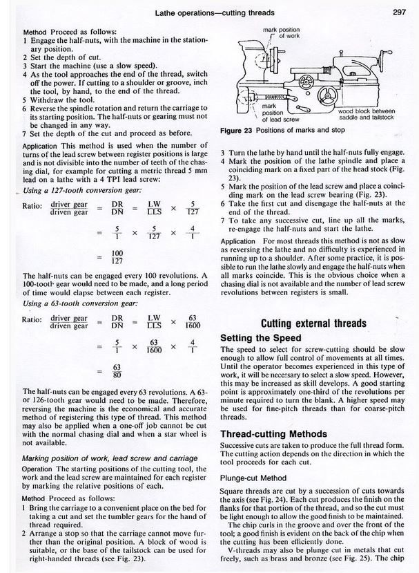

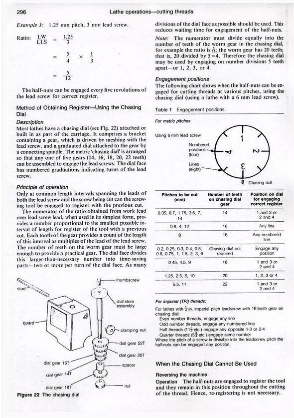

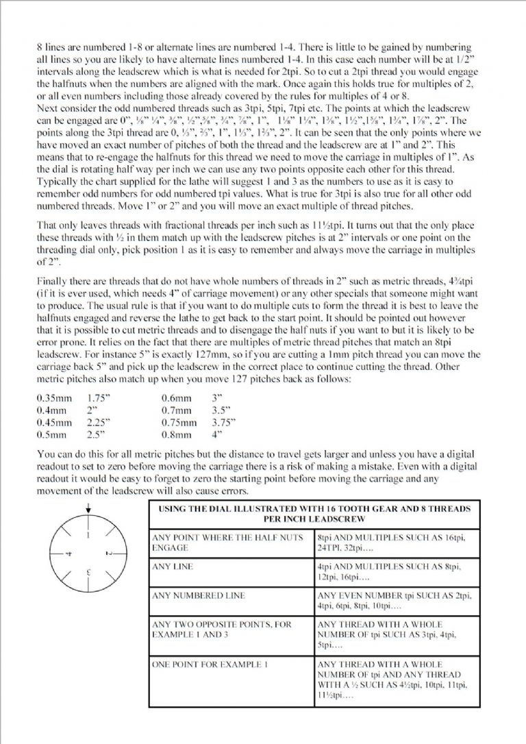

                This may help understand it or may confuse you further:
                #328477
                Martin Connelly
                  @martinconnelly55370
                  I have converted the PDF file mentioned in my earlier post into jpg format. It may help understanding of how to use the dial.

                    Thanks Martin!

                      Have all the info i need now, thanks for your reply s , all is clear smiley now. just need to try it out.
