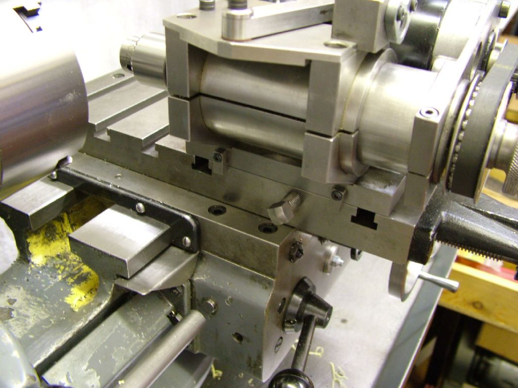

      Thanks both. Ramon – I guess there’s the Related Hobbies section for plastic?
      Jason – Yes, I could do that. If I get time I’ll measure the relative end lengths tonight and see how they compare. I probably also need to make some aluminium pad arrangement for the carrier to tighten against. I think it’s a bit big for this job really. It only just touches the drive spigot too, so I might lengthen that with a sleeve or something.
      Also going to turn a small pad to JB Weld to the saddle for the stop/gauges to seat on; the surface at present is a bit flaky with paint etc, so I guess the depths may change slightly depending on the exact position the gauge blocks on the saddle face. The face might not be parallel to the end stop bolt either I guess.

        I have no idea Doc. I think I posted something on here in the past regarding plastic modelling distraction but it may have been on Model Engine Maker.
        Re a stop button, yes it's a good idea to fit one as A, the surface is a bit hit and miss and B fitting one gives you some room to hold a slip in.
        I managed to drill my saddle and glued in a hardened button – I found the right spot by turning a point on a piece of steel that fitted the stop block and used it as a centre punch.
        Definitely worth doing

          If you’re measuring from a pre-faced face, what’s the best method of determining the face datum with the tool tip? I’ve been feeding the tool – by hand – to touch the (stationary) work, then adding the slip gauges in front of the stop. Not sure it’s accurate though, because I’m getting a few thou difference between the slip gauge thickness and the measured resulting step.

            You may find once you've fitted that button things will improve some.
            With the lathe stopped I touch the tool on the end of the workpiece, set the stop with the required slip(s)s, and lock firmly. Back the tool off slightly with the top slide and then, keeping the saddle up firmly to the stop and slip(s) and holding in place with the handwheel – with the lathe now running – bring the tool back up to just witness touch the face, taking a skim down to the centre if thought necessary.
            That should see you within a thou or so given any tiny slack in the system.
            If your slips are 'worn' as some of mine are and they don't wring that well I make the pile up and just lay a piece of masking tape on to keep them together until the pressure from the hand wheel takes the strain.

              Roughing now complete. The diameters are all within 0.001” to the drawing, and 0.0005” end to end, which I was reasonably happy with, and the lengths within a few thou of each other and the drawing. The mid length is spot on to the drawing.
              I think I can improve on all dimensions using the saddle pad, and Ramon’s datum technique which worked very well. For finishing, if I swap the shaft round for the final diameter cuts without touching the diameter setting, and using the same width settings, in theory I suppose everything should be identical.
              Surface finish is excellent with a 0.002” finish pass, and some light work with fine abrasives/polish. So far so good I think (centre section left un-machined since it’s only 0.004” over-sized on radius):
              The depth stop pad is currently set in place with JB Weld:
