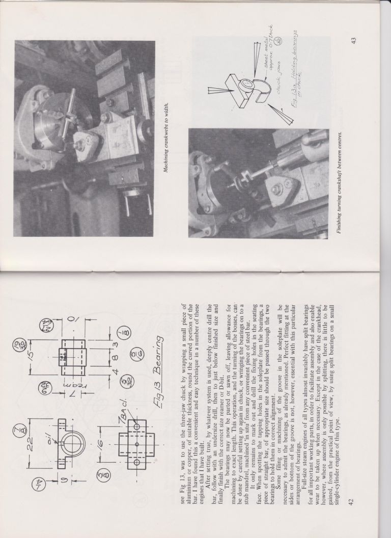

        Thanks Jason – understood about the drawings – they are obviously un-toleranced, so some intuition is needed. It was just that the inner faces of the bosses form the crankshaft thrust bearings, and the brass as supplied gives you half the bearing width; 0.2mm is the drawing face width, but that leaves you with virtually no land around the boss.
        I might turn a spacer to clamp the boss to the mandrel, making it just small enough to get a defined land around the it, and use that as a guide for cutting.

          If my memory serves me correctly (its a long time ago I built mine 40 years) I used a 11mm ballnose cutter and the bearings were a brass extrusion. Andrew Smith in his book suggested using a piece of 16 SWG? sheet wrapped round the curved area and the three jaw chuck. Hope this helps.

            My memory is not what it was, the packing used should be 0.7mm or 1/32. Hope fully I have attached the revalent page from the book.

              Also interesting that the metric drawing gives the diameter either side as 10mm which would be more than enough to compensate for any differences in the now cast part.

                Thanks Paul and Jason,
                I have that book – I wonder why it's missing the 11mm dimension for the 7/16" block width?
                I've seen a couple of online builds where they've assumed the 1/4" dimension is the depth of the bearing axis below the upper surface of the block, and marked it out as such, ie with the as-cast upper surface as a datum. I don't think this is right: If the bosses are to be concentric with the semi-circular lower block, then that 1/4" below the surface will be slightly wrong. I assume it's actually the flat top face of the bearing that should be struck 1/4" up from the axis of the hole (or the lower O/D of the block).
                All pretty irrelevant in practical terms, but it's interesting how people interpret the drawings w.r.t. the parts they're supplied.

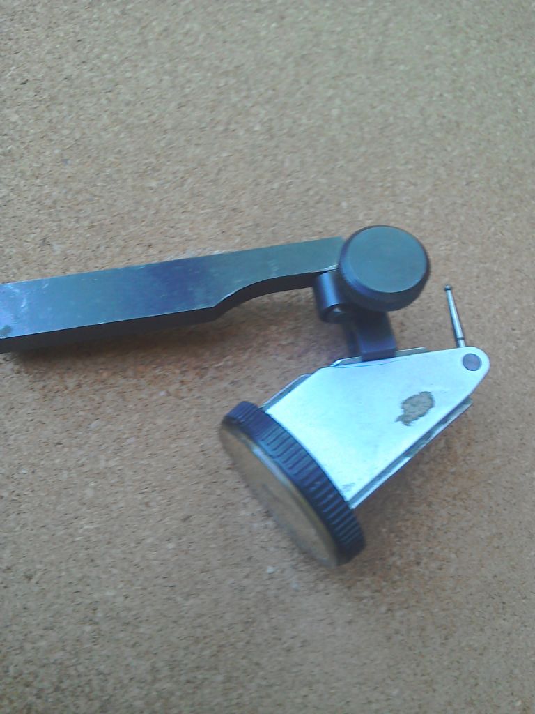

                                    Thanks Martin. If I make a DTI holder, are there any particular design features that are useful? I've got both a finger type and a plunger type. Using a magnetic base is a bit cumbersome, so a holder would be good.
                                    I suppose having gone to the trouble of making an adjustable stop, I should have though more about the obvious way to actually use it – touching the drill edge then spacing back from the stop…Ah well it's all good stuff to learn!

                                      If you have a dti with dovetails and a dovetail mount like a short rod then the simplest holder is a bit of bar with a hole for the dovetail mount and a clamp screw. Just needs a bit of thought to get the lever on the centre line with the face in a readable position.
                                      Martin C

                                              Posted by Martin Connelly on 28/05/2020 10:03:26:
                                              Martin C
                                              Martin, the finger DTI has dovetails and a spigot, so that's easy. The plunger type is much bigger, and only has a mounting lug with a hole in it on the back. I suppose a square bar with a tapped hole in the end would be OK for that?
                                              Is normal practice to mount them with the plunger or finger on the side of the work facing you? I'm using this method, then adjusting the 4-jaw chuck by moving the screws to the plunger position and correcting back to the mid point of deflection….or trying to!
                                              #475553
                                              Martin Connelly
                                                @martinconnelly55370
                                                Yes, finger on the side but it can be front or back of the bar, probably easier at the front for the compound position check.
                                                My setup would be this because that's what I have to hold the dti.
