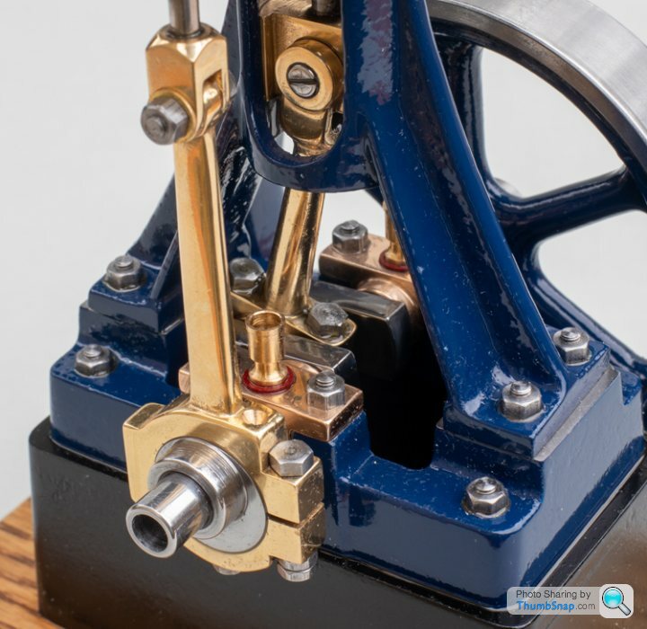

                            Here are some better finished images:
                            Thanks for all the help and advice over the past 5 months everyone; I'll post some videos up in a minute for comments. Cheers!

                              Guys, I ran the engine for the first time last night. It worked first time on a rough valve setting, which I got from this thread and reading the "Building the Stuart 10V" book. It had a tight spot at the bottom of the crank throw, but nothing serious. I did put the gland packing in, but just nipped up. The rods slide freely up and down. The valve timing hasn't been touched, but the tight spot has now eased considerably.
                              You may notice the screw in lace of the upper drain cock. It snapped off on tightening, I probably shouldn't have used PTFE tape. Anyway, minor detail.
                              You have NO IDEA how amazing it was for me (and the family!) to see this engine running for the first time. I know its about as simple as it gets, and it's no big deal for the old hands on here, but I can tell you I'm hooked. I'm already looking forward to my next build.

                                You certainly deserve to be congratulated on such a stunning result for your first attempt at ME yes
                                A superb log throughout and an excellent outcome. A fine runner too – superb tickover
                                Only one minor observational critique – the cheese head mounting screws are out of place to my mind – nuts would be much more in keeping.
                                Well done indeed
                                Looking forwards to what you will do with that Twin Victoria
                                Ramon

                                  Roy also commented about the screws. I have already put the nuts on top, but they are standard nuts, not the ME types on the rest of the engine. I will swap them out when I order the fasteners for the Victoria.
