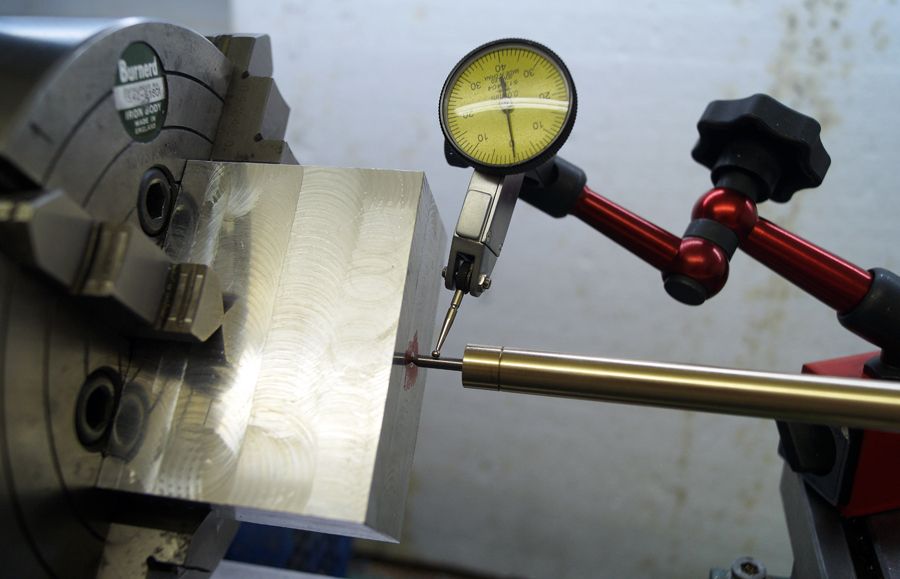

          Back to the basics – one thing I'm pretty sure isn't correct is the way I held the block in the chuck – if you look at the image below:
          Difficult to see, buy in that orientation, none of the flat faces are in contact with either the chuck face or the jaw ends. The square-ish extension at the rear was narrower than the central bore in the chuck. When machining the opposite face, the wide face was in direct contact with the chuck face, so no issue.
          I set it up by temporariy putting parallels between the 'wings' and the ends of the 2 opposed jaws. Once tapped back into contact, I removed the parallels and centered the piece with the centering rod. I then put the DTI on the face next to the existing bore to check it was normal to the rotation axis.
          So in other words, the part wasn't positively located along it's axis apart from friction with the jaws. If I put spacer pieces behind, they woul'd probably have flown out when spun. If I'd have put excess pressure on the tool, the part would probably have moved back, or at least out of true.
          Any advice? Thanks.

                          I'd centre drilled the spigot, so as an experiment, I used my centering rod again:
                          Again, just under 0.002" runout. No way I can get better than that. Even though I'm holding the rod to prevent it turning (if I let it turn it's worse – but no real surprise there), no matter what I do to the chuck, I always get that error; I got the same residual error when I put the point directly into the bush in the block yesterday. It can't be centering technique with the chuck, becasue I can easily zero it using a DTI on a known true cylinder.
                          Any thoughts on what I'm doing wrong here?

                            If the spigot has zero runout then I would suspect the centering bar and where you are measuring on the bar, have you tried measuring  close up against the spigot?
                            Edited By Ron Laden on 29/05/2020 04:43:18

                              Ron – I’m measuring about 1” back along the bar from the part. Since I’m measuring wobble rather that runout of the bar itself (assuming I stop it rotating) I don’t get why I can’t zero it – presumably in theory it doesn’t matter where along the bar I measure, but the biggest reading will be nearest the workpiece?

                                I think your angle on the end of the rod may be the problem. A ctr drilled and even a spot drilled hole will have a very slight flat on the bottom, your ctr punch mark from the other day will leave a wide 90deg cone and again may not have a perfectly flat bottom.
                                Now your very sharp pointed low angled indicator rod will touch the bottom of your mark not and not sit taper to taper.
                                So I would suggest you recut the end taper to 60deg inclusive angle, use a dot (prick) punch which are also ground to 60deg and if drilling to mark the position then use a small BS0 ctr drill and go in all the way with the pilot plus a small amount of the part that cuts the 60deg seat.
                                One other thing to bear in mind when making something like that plug, if your 3 jaw is a bit out it is unlikely the hole is concentric to the OD of the plug. For a job like this where there is an existing hole you would be better off just setting the lever of the dti to run against the inside of the hole, save the rod for when there is no suitable hole.

                                  Thanks Jason, OK I'll re-cut the point again to 60 degrees inclusive. And I'll re-turn a portion of the adjacent shaft too.
                                  Is there a good way of re-profiling one of my centre punches to 60 degrees too?
                                  BTW the punch holes so far are only in the bras bearings – for the spigot yesterday I did centre drill it to make sure the point didn't bottom out. The spigot was turned in a collet, but of course if the center drill wandered it wouldn't be central.
                                  Also, I tried the bar in the existing through hole in the handwheel block, so it was in there to about half the taper depth (and obviously there was no bottom to it). Same story with runout.
                                  Anyway, I'll re-cut it and try again.
