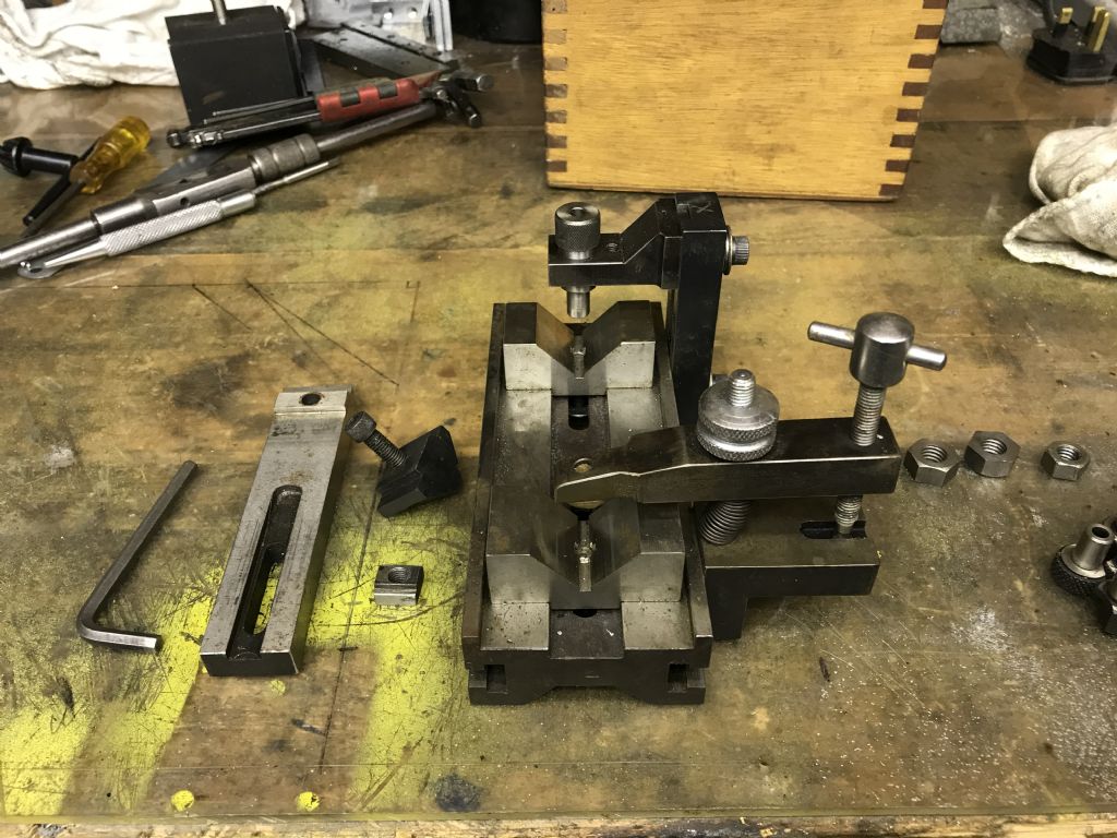

      Hi all,
      looking for help in identifying these clamps I have been given.

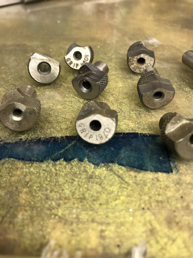

      Here are the what I think are some kind of setting screw note the head
      I have 2 sets of these but have no idea what they are used for

        #413538
        YouraT
          @yourat
          I'll bet the "setting screws" as you call them are hardened and have a range of different sized holes through them.
          This looks very much like a cross-drilling jig – the cut outs on the bushes are for the retaining screw shown in your album.
          Y.
          #413539
          Plasma
            @plasma
            +1 for cross drilling jig. Looks a nice piece of kit, I built the Hemingway finger plate clamp and it has bushings for different sized drills.

            #413540
            Neil A
              @neila
              This looks like a fixture for cross drilling round bar. The items in the second picture are interchangeable drill bushes that fit in the cross bar at the rear of the fixture. There should be a screw in the tapped hole that engages with the cutout on the head of the bush to stop it coming out when the drill is withdrawn. A handy fixture.
              #413541
              HOWARDT
                @howardt
                Looks like a production shaft cross drilling jig. The bushes are Grip drill bushes for guiding the drills. Used to use Grip in the 70's, they used to make the whole range of fixture components in those days in competition with WDS. Not sure when Grip expired, bushes now made by B&T in Nottingham and others.
                #413542
                Trevorh
                  @trevorh
                  Hi Yourat
                  yes that correct the different screws all have different dia holes through them and are hardened
                  So its called a cross drilling jig and so assume that as Neil A says i guess if I need to drill a round bar/shaft then its clamped and use the setting screws (guide bushes) to control the drill
                  Many thanks for this info
                  regards trevor

                    #413550
                    old mart
                      @oldmart
                      Used all the time by toolmakers and jig makers, the drilling bushes are hard and quick detachable by gripping and twisting the knurled top. The jig would also be used on drilling machines for production runs.
                      #413554
                      geoff adams
                        @geoffadams14047
                        drill bushes for drill jigs so you can drill and ream in one op in the same jig using different sizes holes in the bush they drop into a harden guide the shape allows the bush to be turned to lock under a cap screw so the bush does not come out when drilling made many jigs using these

                        #413555
                        Trevorh
                          @trevorh
                          Thanks lads
                          the parts must have been quite small as the largest hole in the guides is only 4mm and goes down to 0.5mm
                          overall length of the base is only 200mm

                          #413563
                          YouraT
                            @yourat
                            A more general purpose version would be something from the Reglus range.
                            I have one of these (not mine, but identical, and the pictures are better!):
                            http://www.nielsmachines.com/en/reglus-universal-drilling-jig.html
                            Don't use it much, but invaluable when needed!
