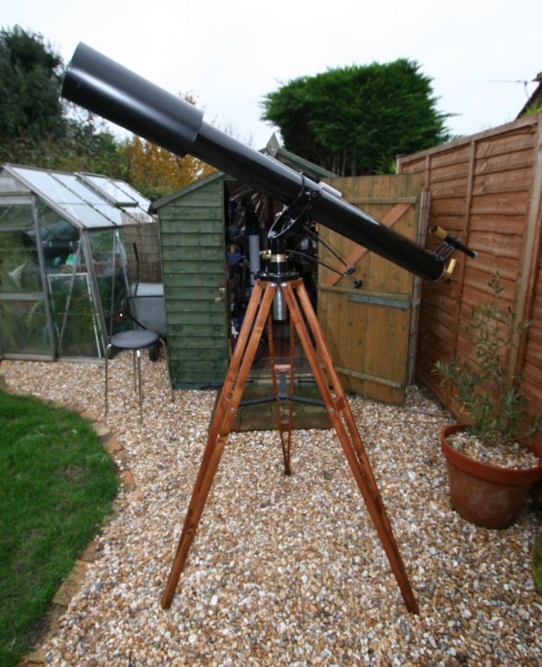

      I'm musing about making replacement stainless steel legs for a tripod.
      I found 1.75" x 3m long by 1.5mm wall seamless stainless steel pipe for £60.
      A new tripod with similarly specced legs is £95 …
      Now I could look at MS tube, but just in case, does anyone know a less costly source of stainless pipe to that size?

                      #188738
                        > the material needed for the knuckles, sleeves and feet etc would probably bring the total near to the cost of a new one.
                        That's my conclusion
                        The aluminium ones struggle to cut the mustard. With the mount and scope mine weighs 28kg and wobbles like a jelly – doesn't help that the scope and counterbalance makes a nice centrally suspended pendulum.
                        The stainless tripods weigh about 7Kg but are much more rigid.
                        The alloy design In photo) has two weak points – the central leg is only clamped at the joint – that's what the bit of studding puts right, the other is twist where the legs join the (cast iron) tripod top. My alternative solution is making alloy clamps to replace the plastic mouldings, or simply fixing an alloy spacer at the top of the legs.

                                    Wood seems to be fairly popular (ash is recommended) but wood is a horrible nasty substance that always comes out tatty and scruffy round here
                                    Think I might see what improvements I can make to the existing tripod for now… there are various other strategies. I have already filled the centre legs with sand (have to work out how to plug the outer ones). Suspending a weight from the head can help and so can hanging a chain from the scope.

                                        The sand needs to be loose to maximise its damping properties.
                                        #188805
                                          Neil,
                                          Unless you are really determined to use stainless … I think this may be the most cost-effective material for fixed-length tripod legs.
                                          P.S. … I wouldn't take the damping properties of loose sand too seriously … by the time it starts to work, the tripod has already flexed too far for astronomical use.
