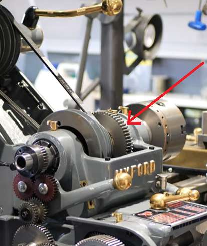

      Hello, I want to make a worm gear for this gear. Could you tell me what pitch I need to set? Thanks, Franco.myford

        The gear specification is given in GHT’s book, in connection with the headstock dividing attachment. See:
        https://www.hemingwaykits.com/HK149X
        If you wish to learn fishing instead of just being thrown a fish finger, you can upskill to answer the question yourself.
        Gears have three specifying parameters: no. of teeth, diametral pitch and pressure angle. You do not need any further skills to identify the first of these. If you read Ivan Law’s excellent book, you will learn how to calculate the second of these.
        Download GearDXF software and print out on paper gears using those two parameters and guessing at the pressure angle. You only have two choices. Offer the print out up to the gear  and see which of the two fits best.

          The gear showed is not intended to mesh with a worm gear, however it can be done although not able to carry power as the meshing is not exactly correct. You need to measure the diameter of the bull gear and count the number of teeth to use an online gear module calculator which will give you the tooth pitch. The worm will have to be tilted to mesh with the straight teeth on the wheel. You will also have to choose the number of starts on the wheel you make.
          We were given an Atlas 12 x 24 lathe which did not have its threading dial which works like a worm wheel on the leadscrew which is simply a straight worm of infinite diameter. I knew the number of teeth that the worm wheel should have and the TPI of the leadscrew and bought a gear that meshed correctly. The axis of the gear had to be tilted to match the leadscrew thread and the housing made to suit. The threading indicator works perfectly since it does not transmit more power than needed to turn it.
          #866406
            Circumference of a 1″ circle is 1 x pi = 3.142″
            Divide 3.142″ by the DP of the gear which I think is 20DP on a Myford
            3.142/20 = 0.1571″ pitch
            If you want tpi then 1/0.1571 = 6.365tpi
            But may be easier to select 4mm pitch as that is very close

              The bull gear on a Myford   is 16 DP   ,well it is on mine  checked against  16 DP hob   fits
              perfect ,  Ivan law’s  book list the pitch as.1963 inch    5 mm = .1968 inch  so that would
              do .Depth of cut =.135 inch.
              20 deg  PA.
              #866423

                Presumably this for a dividing-attachment.
                Note that a worm meshed with a spur-wheel is fine for such purposes as it’s not transmitting any power, but in any case it will need its axis angled sideways at the helix angle, not perpendicularly to the axis of the lathe spindle.

                            Franco, see John F’s post after mine, I was not sure of the DP but John says it is 16DP not the 20DP I thought so you need 0.1963″ pitch which is approx 5mm not 4mm
                            Depending what change gears you have it should be possible to get very close. You may have to drive the leadscrew by hand and let the gear train drive the spindle rather than use the motor.

                                    Where are all the Myford users, surely someone can help with a suitable gear setup for a gearbox machine. I’m thinking it needs the 24T replacing with a 38 but that is not a perfect pitch at .198″, probably do better playing with gears on the metric conversion set.
                                    The slightly coarser 0.198″ pitch would probably work on a dividing attachment as it will just not lower down quite as far as the bull gears pitch circle and as we all know the distance between contact points increases as you move away from the pitch circle.

                                      In the book, GHT says that the worm is 0.19707 pitch. The pitch is greater than for a normal 16DP because the worm is skewed at 4.9° to mesh with the bull-wheel. That is for a worm 0.855″ OD. For a different diameter worm, the helix angle would be different too.
                                      He suggests 60 – 55 / 65 – idler – 45 as close enough at 0.19697. But that would be for a change-wheel machine. I don’t know about one with a gearbox. Mine is without.

                                          In Ivan Law’s book on page 96 is a list of gear trains
                                          for DP sizes from 6 DP to 40 DP ,this is for
                                          changewheel machines .125 inch lead screw ,
                                          Myford, for 16 DP only 2 gears and an idler are needed
                                          driving 55 T , idle, driven on leadscrew 35 T.
                                          Found this useful info Myfords g box
                                          https://stevenson-engineers.co.uk/files/s7gbox.pdf
                                          on page 4 at the top set up for cutting 16 DP
                                          looks as if some extra gears are needed.
