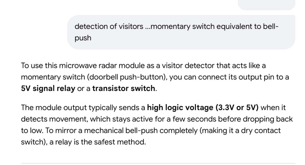

          Curiously, enough, John … I have ben investigating a broadly similar requirement
          Here is a snip from recent discussion with Google:
          IMG_2078
          I have sourced some apparently suitable boards very cheaply, and am awaiting delivery
          If you pursue a similar line of questioning, you should find either a pre-built unit, or  all the instructions you need.
          The concept is very simple.
