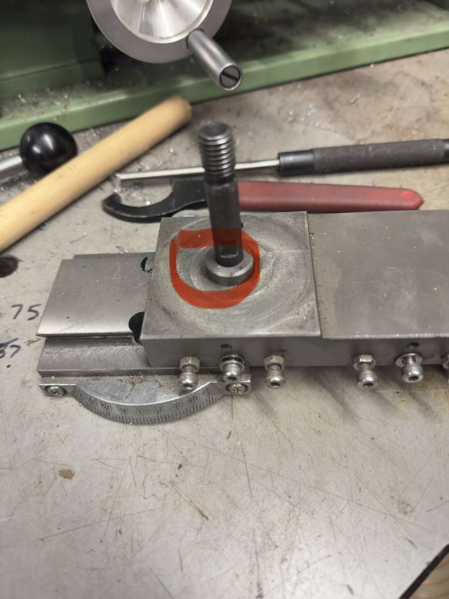

      Evening all,
      Id like to make my wm180 a little more rigid, I know a lot of people remove the compound slide when adding a qctp for extra rigidity. I never use the CS so haven’t got a  problem with removing it, I would however like to keep the original 4 way tool post. I’ve got a lump of cast I could utilise to replace the CS but the spigot on top of the CS which the 4way sits on it is posing a problem, I’m struggling to find a way of incorporating it into the cast block? Any suggestions?
      thank you.
      #866294
        I would have thought you could hold the block in the 4-jaw and turn a spigot on the end. At the same time drill the end for a suitable stud to take the toolposts nut.
        Alternative would be to put a bigger hole into the top of the block and incorporate the spigot as a larger diameter section of the stud
        A picture would help.

          Both Jason’s suggestions would work on the WM180. I would suggest going for the separate spigot idea since the fixed one is a nuisance if you did want to use a quick change toolpost at some stage.
            A picture would help.IMG_2835

                    #866323
                      Having seen the picture both my previous suggestions still stand as it is how I thought it would be.
                      There is a third option which is to have a flat topped block so anything can be attached at a later date, plain shank to the stud and simply make a close fitting thick “washer” to slip over the plain shank of the stud and locates the recess in the toolpost so it can be spun round without sideways or front back movement. I think I would go with this option.
                        Thanks Jason,
                        Yes I like the sound of your third option.
