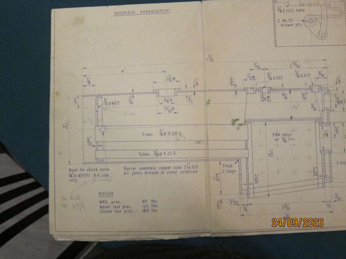

      Hi – I have just carried out a hydraulic boiler test on my Rob Roy 3.5”G locomotive and to my chagrin have discovered a small leak inside the smokebox from one of the boiler tubes which unless anyone can suggest otherwise indicates some major surgery is required and the removal of the boiler from the chassis. Can anyone suggest the general procedure for the removal of the boiler from a Rob Roy as it has been years since the build was completed and I have totally forgotten the order of assembly?

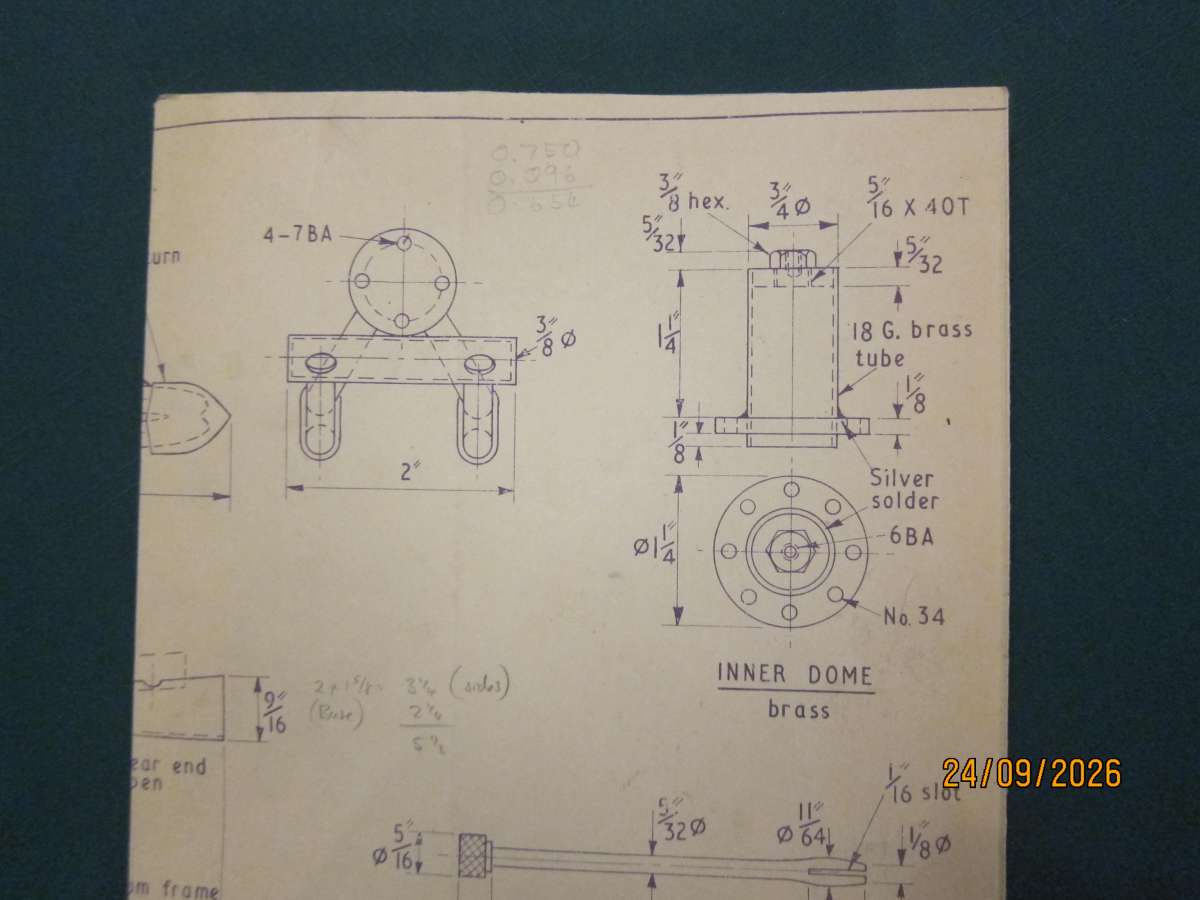

      Another source of leak was found to be around the dome cover and its bush. The dome is held down by 8, 6BA PB Hex somewhat short 6BA PB screws tapped into blind holes, the thread of one of these now stripped.  What I would like to do is to re-drill out and tap all 8 holes in the bush and replace them with stainless steel hex headed bolts drilled and tapped all the way though to the inside of the boiler to maximise the thread engagement.
      Am I right in saying that it would be perfectly acceptable to drill and tap the dome bush right through to the inside of the boiler in order to get a longer length of screw engagement given that something like Red Hylomar should take care of any steam leakage up passed the threads ?

              Many thanks for the very useful information being provided and exactly the help I am looking for. Close inspection of the drawing for the dome bush reveals that drilling through into the steam space would involve drilling through the boiler shell as well as the bush, something I think from what has been said should be avoided.  Much food for thought.

                  I rather fancy trying the 5BA/6BA stud approach as it avoids making any changes to either the dome flange or the boiler bush but in the past I have found the making and fitting of studs using the double nut method of screwing into place a tricky affair. The nominal length of the stud would be 1/8” (5BA section)+1/4”(6BA section) +1/16” extra = 13/16” to be cut from PB of GM. Any advice on making and fitting of studs would be much appreciated.

                      Having seem the drawings I’ve spotted something to look out for. If the stripped thread is along the boiler centre line and you drill through you might create a leak between the shell and the underside of the dome bush unless you are certain there is a blob of silver solder sealing it off. Hopefully it is away from the CL, in which case leave the ones on the CL alone, screw in a bottoming tap and use studs, then you know you’ve go full engagement. If it is on the CL, then I’d flood the area with Comsol before drilling through, but discuss it with your boiler inspector, some are a bit sniffy about using anything other than silver solder even for a non strength joint.
                      Another issue I’ve just noticed, the diameter of the bush where it fits in the boiler is 15/16″, and the holes appear to be on 1″ PCD (although this isn’t shown on drawing). This means that it’s only 1/32″ from the edge of the bush to the centre of the hole  as it breaks through, which might cause trouble
