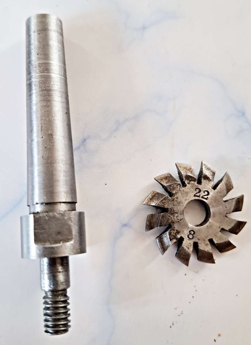

      Looking for 22 Dp number 8 involute cutter, seems they are hard to find, bore is 1/4″ and fits my MT1 drilling spindle.
      cutter
      #866478
      DC31k
        @dc31k
        Please say what pressure angle you require.
        I think you will struggle to find one with that small bore.
        RDG and eBay have 14.5 PA with 1″ bore.
        #866484
        Huub
          @huub
          If it is for a single gear, try making a gear cutter (fly cutter). For this you only need a milling machine.  There are more examples on YouTube.
          A number 8 cutter is intended for 12..13 tooth gear, quit small.
          22 DP is about module 1.155, a non standard value.
          Check the dimensions of the gear to be sure it is 22 DP.
          Besides the DP you also need to know the pressure angle of the gear. Looking at the cutter it probably is 20°. Another standard value could be 14.5°
          Use a CAD system (FreeCAD) and draw such a gear. Print it out and check if it matches the gear you want to make.
          These type of gear cutters can be resharpened. Just grind the flat cutting edge a bit and they perform as new.
          edit:
          That number 8 gear cutter could also be for a 135 tooth gear, depending on the table you use.

            If its an older cutter its more likely to be 14.5 deg, single tooth (fly cutter) is probably the way to go deppending on howmany you need to make.

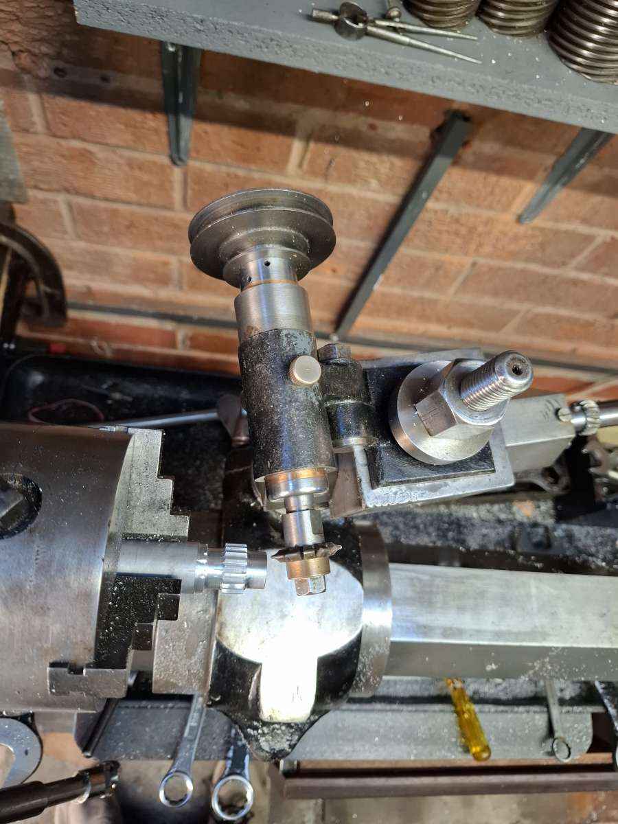

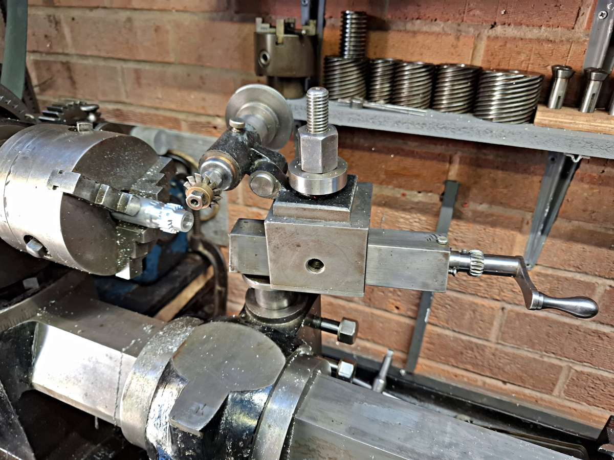

                Thanks for the replies, I am just making a copies of a small gear on my vintage lathe as a project having not tried cutting gears before.
                I have cut two in Aluminium that work perfectly. the gear connects to a worm to power the cross-slide. However I wanted to make one in steel as is the original but the cutter is now worn although it cuts aluminium with ease. The lathe has a dividing attachment so it’s all self contained
                cutterpair

                  May I offer an observation?
                  If you count the visible teeth in the photograph and extrapolate to the full perimeter, it seems to total more than 13.
                  Clearly, the only person to give a definitive answer to the required tooth count is the OP, but it may be that a number 8 cutter is not the correct one.
                  #866526

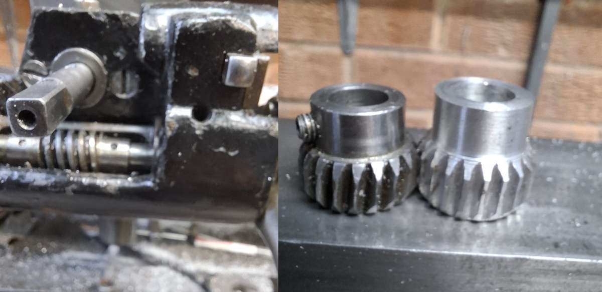

                    I’m also thinking the setup is wrong for a worm wheel.
                    The steel one has angled teeth and I would also hazard a guess they are cut with a hobbing action. Running a straight cut steel gear against your old worm may not do it a lot off good
                    Looks like the cutter spindle may be set at an angle but is being fed along the bed as I can’t see any sign of a compound slide. May even be why it is not cutting steel as the cutter is being fed slightly sideways.
                    #866539
                    Dave Halford
                      @davehalford22513
                      According to “Lathes” Pittler was 14.5 deg PA and most of the worms are multi start as seen on your shelf.
                      If the cutter is set straight along the bed it should cut steel, feeding just hard enough to produce chips and produce a straight cut spur gear for mating to other straight cut gears. Don’t mix these with the ones from your lathe.

                        On JasonB Said:
                        Looks like the cutter spindle may be set at an angle but is being fed along the bed…
                        I do not know how sophisticated the Pittler is, but if the carriage feed were via the leadscrew AND the leadscrew is appropriately geared to the spindle*, the proper realtive motion necessary for a helical gear could be possible.
                        * in terms of screwcutting, it would be a super coarse pitch, with a tiny amount of spindle rotation producing a huge amount of longitudinal movement, hence why the leadscrew needs to be the driver (c.f. cutting the thread on a Quorn column).

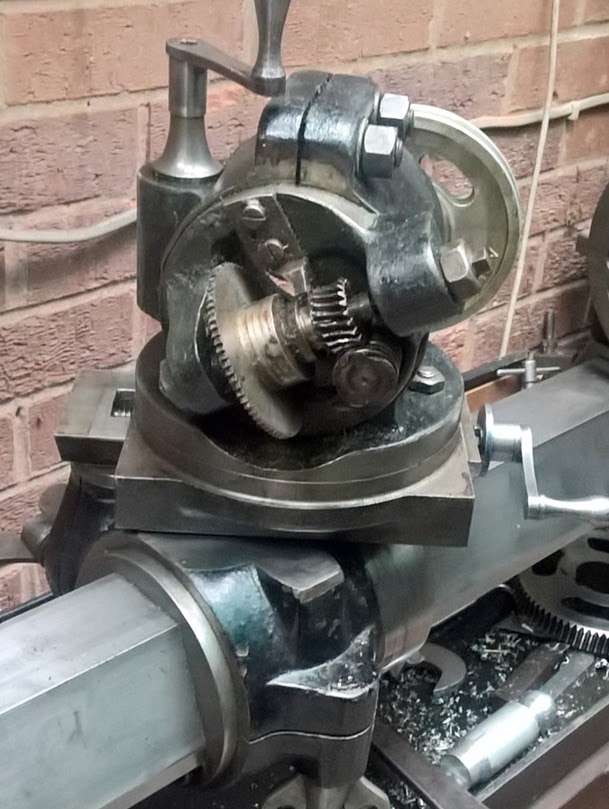

                          The machine is capable of a multitude of different tasks, over 200 in fact even though it’s dated to 1894. I am simply trying out gear cutting methods and in this photo with the spindle on top the angle can be adjusted and advanced by the cross slide. See the catalogue image of what this machine is capable of
                          I have an original equipment heavy drum  type cutter attachment I featured in another post this can swivel the cutter at any angle from horizontal to vertical and has it’s own slide for advancement
                          However I only have a number of plain cutters/ slitting saws etc and not prepared to spend £25 upwards for a cutter just to play around with.
                          I know I asked where I might find a cutter to fit the small drill spindle but will persevere with the cutter I have and make another one in aluminium.crossside

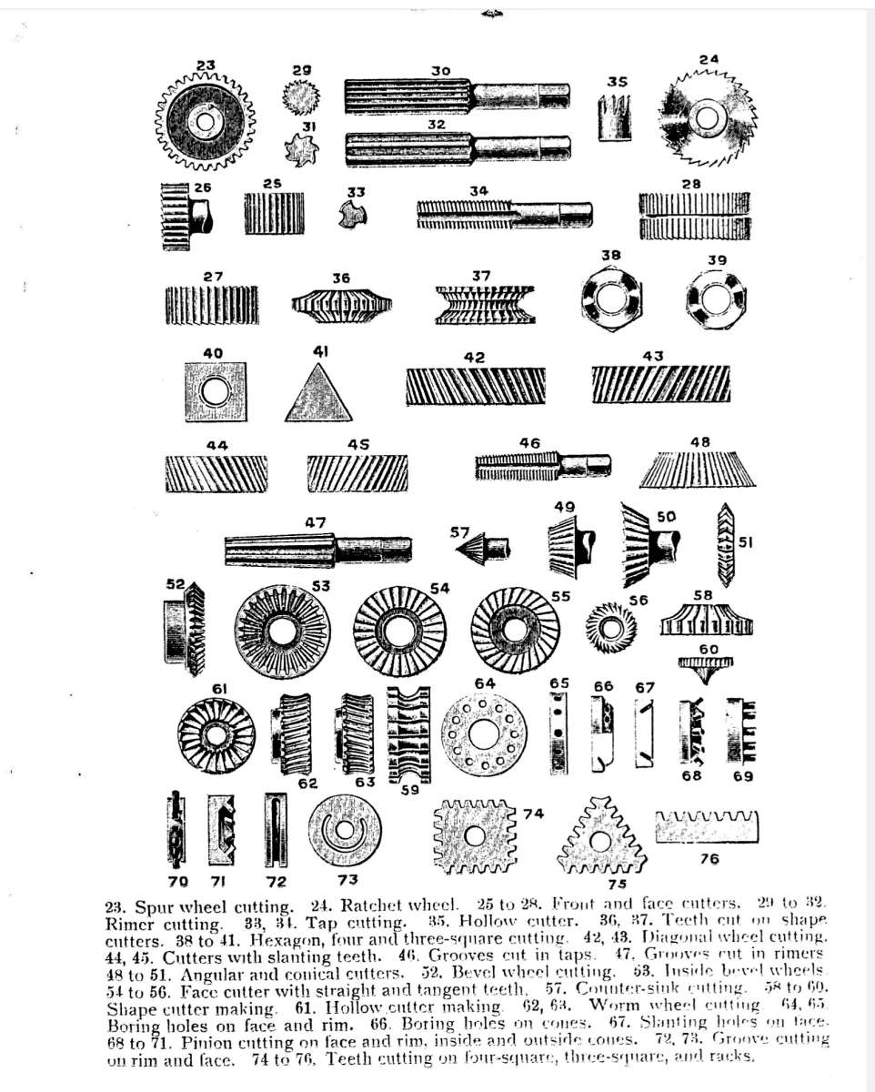

                            As a point of interest this machine is able to cut any of the examples in this catalogue image, with the correct cutters of course
                            examples

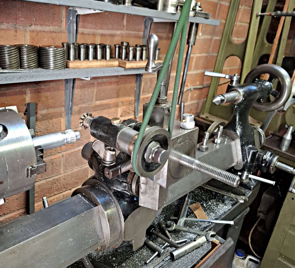

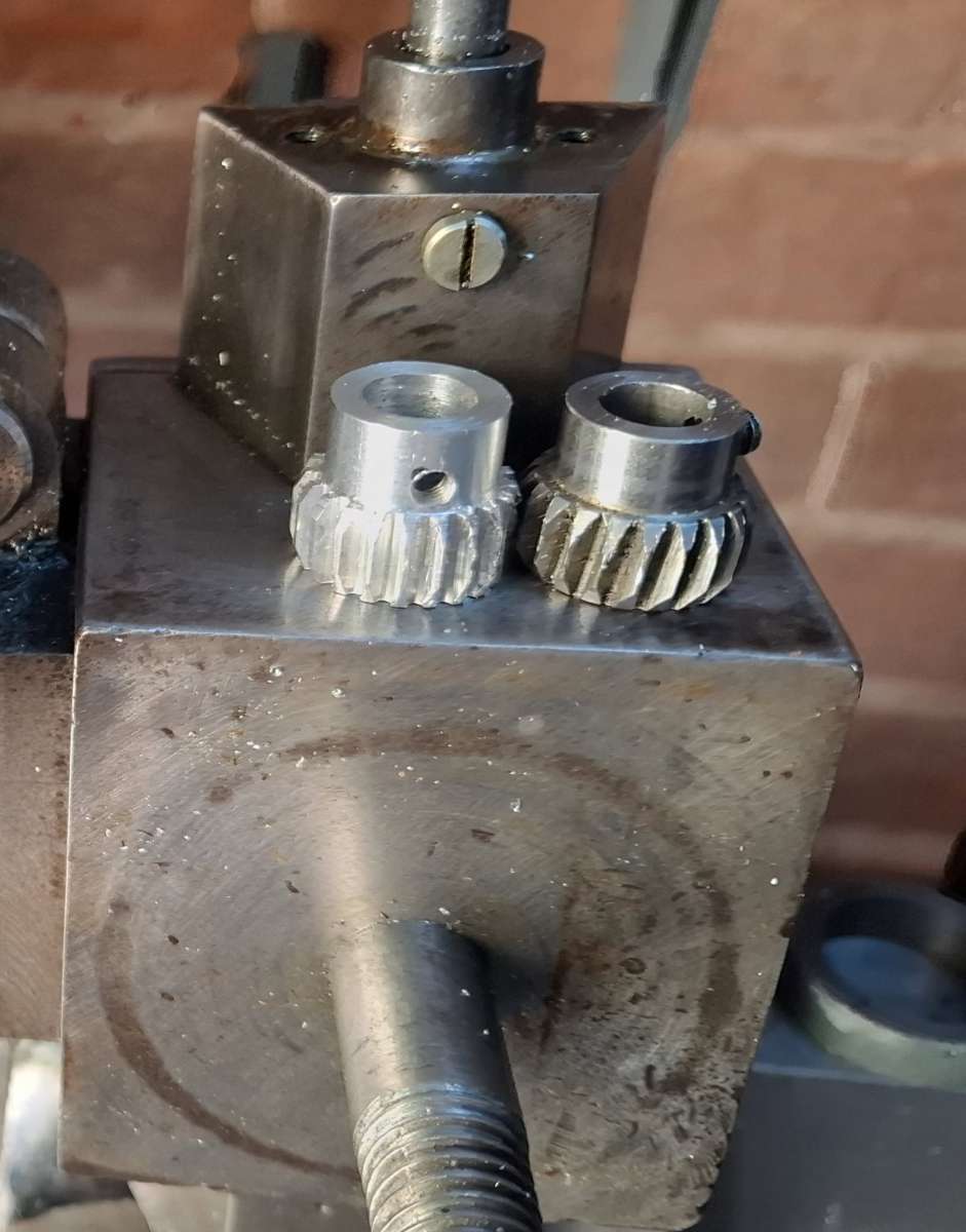

                                I’ve done another one which is better than the original and it works perfectly.  I repositioned the spindle and set it on the top of the cross slide and advanced the tool via it’s handle, the slide being slightly askew from the main lathe bed
                                The previous owner made the little gear as the original was lost but had nothing to copy, I note that the teeth are quite narrow at the tip although the worm is coarse. I made a very short video of me testing it using a drill.
                                Normally it works off a universal joint but as I have the lathe set up for indexing the headstock drive belt is slackened off.
                                I am now going to try making one in Bronze as I still think steel is going to struggle. The only problem with Aluminium is the grub screw on such a short thread, the gear itself has 20 teeth although I am told the cutter is  for 12-13 tpi but nevertheless it works like a dream
                                  Make the shaft thicker or use a smaller grub screw having a finer pitch.
                                  Seem to work OK.

                                    Barely enough room to make it thicker though as it’s level with the bottom of the teeth. l think l will make one in Bronze as it will be easier on the cutter than steel and l have a suitable piece to use
