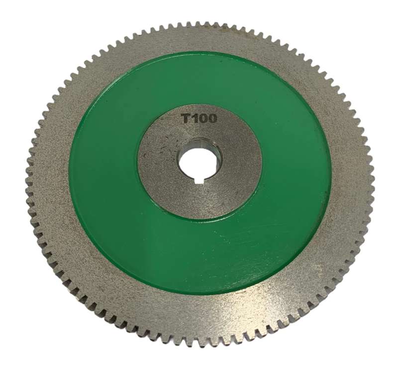

      I have several gears like the one shown in the photo. The only difference is that they have a 31.75 mm center bore. I believe they came from a Myford lathe, but I haven’t been able to figure out which model. Could you point me in the right direction?
      Thanks, Franco

        OD and No of teeth would help

          If they have 1.25″ (31.75mm) centre they won’t fit a Myford

            The teeth have the same pitch as the MyFord Super 7.

              A gear with a plain bore has limited use unless it only has to rotate on the shaft on which it is mounted.
              Does the 1 1/4″ bore look OEM or could they be Myford items that have been modified?
              What is the tooth count of the selection you have? Your answer above is incomplete.
              If they are the same specification as Myford ones, they could be bushed down to fit a Myford, so the comment above about “won’t fit” is only partially true.

                Change-wheels always carry the tooth-count, as that does, but often also the lathe-maker’s name.
                They may have been used on a Myford lathe, somehow, but I am afraid “believe they came from a Myford lathe” is not proof they are proper Myford fittings.
                The bore is too large for a start, but even if the DP, a standard value, is correct for Myford the pressure-angle might be wrong so mixing them with correct ones will damage one, or both, of each meshed pair.

                          We’ve no seen a photo of the gears in question, the one in this thread has been lifted from some Myford site.
                          Some lathe change-wheels do have plain bores, and are keyed together with a pin.

                              Myford changewheels are Imperial, 5/8″ bore (15.95mm) and 20 DP, so a 100T gear would be 5.1″ OD (129.54 mm)
                              Wheels for 7 Series Myfords have a keyway, so that they can be compounded.
                              Wheels for ML 1,2,3 or 4 are dimensionally the same, but do not have a key way, using a 3/32″ pin to compound the gears or to a driving collar.
                              Since the gear shown has an oversize bore for a Myford, but if it meshes satisfactorily with  Myford gears, this one will be 20 DP, but intended for a different machine.
