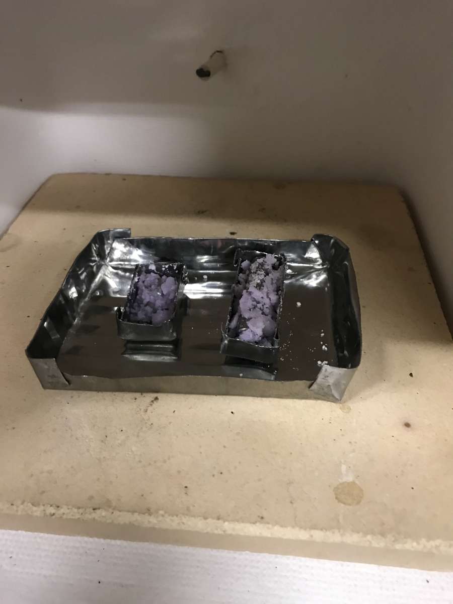

                    If by “filing against” you are wanting to make filng buttons then I just use mild steel and no risk of blunting your files on the soft unhardened material.
                    #828958
                    Dave S
                      @daves59043
                      for avoiding scale heating the part covered in Borax works for me.
                      I usually put the part into a metal ‘tray’, then cover with a paste made from borax and meths.
                      IMG_0134
                      I have a small enamelling kiln that I use for heat treating, but just heat and quench as usual.
                      The borax doesn’t seem to affect the hardening, and the glassy residue scrapes off fairly easily afterwards.
                        IMG_0134
                        I have seen this method used by various people where did you get the foil from to make those trays(I use the word foil in a loose manner)

                            Dave S
                              @daves59043
                              IIRC it’s from the side of a microwave oven we used to have. It died, but I salvaged the stainless cover…
                              Any thinish metal sheet that will stand the temp will do, doesn’t have to be stainless. The trays are reusable to an extent, but I considerer them disposable – as in when they look dodgy Ill just make some new ones.
                              The corners are just folded up and round – so the net is a simple rectangle.
