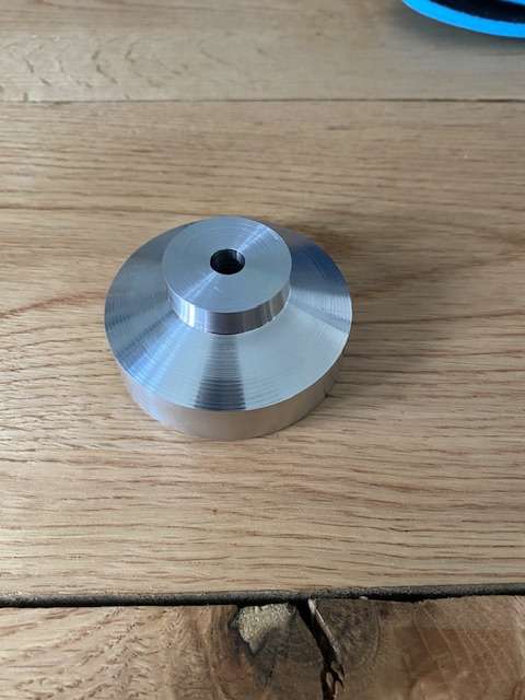

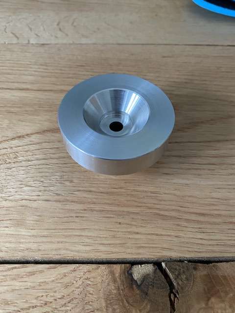

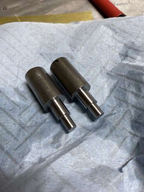

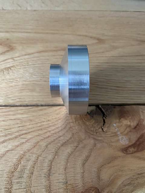

              Well it’s working lovely, the angular contact bearings are giving a nice surface finish and the lathe is working beautifully! Very happy.
              Couple bits I made up
              IMG_0987IMG_0904IMG_0906IMG_0905
