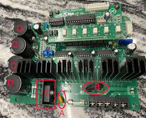

                Hi Dave,
                right so:
                1) both cables to the motor disconnected = trips the garage RCBO as soon as I press the green power on the kill switch….
                2) the motor and controller disconnected. I press the green power button and nothing trips. The green power light comes on so long as I hold down the green button, but the button doesn’t latch which I assume correct.
                which to me does initially point to the board, Atleast as a start….
                so this is an Axminster SC2, the manual has a wiring diagram but very basic, just has the whole board as an empty box with no detail sadly.

                      On andy198712 Said:
                      On SillyOldDuffer Said:
                      Making progress, but I’m getting confused.
                      To alleviate my confusion, what happens when the lathe is powered on when:
                      1. Everything is connected apart from the motor?
                      2. Everything is connected apart from the motor AND the control board?
                      Hi Dave,
                      right so:
                      Yes, it’s the board that needs to be debugged next.
                      It’s possible the motor failed first, and in doing so took out the controller board.   Don’t worry about that yet – the controller can be tested by connecting it to a 60W mains filament light bulb.   When the board is working properly, turning the speed control will make the lamp brighten and dim.   Then you can test the motor to see if Sod’s Law has got you!
                      Robert’s advice is a good place to start, and you said of that ‘Okay so I’m getting 385 on the 2000ohm setting and on the 200 setting it quickly raises to 1. Which is out of limits if I recall ? If I’m correct? On each of the 6 heat sinked fets.
                      and they all seem the same, I’m hoping to find one grossly differnat but it hasn’t happened yet?!
                      The meter reading 1 on the 200Ω scale means ‘out of range’, i.e more than 200Ω.   The 2000Ω range measurement of 385Ω is probably correct, meaning the FETs are OK.    Bad news in a way, ideally one or more of them would have been short, and they’re not difficult to replace.   As is, we’re still looking.
                      My next move would be:
                      • test the suppressor capacitor(s) by unsoldering them.
                      • check the rectifier block for shorts
                      • check the big 200V capacitors for shorts AND look to see if the tops have domed.  (Electrolytic capacitors can fail short circuit and in doing so boil the electrolyte causing a modest smelly bang, and maybe spraying the innards about.  Messy.  The size of the bang is usually reduced by weakening the top of the capacitor, which expand and open gently if the internal pressure rises.   Any sign of swelling in an electrolytic capacitor usually means it’s going or gone.
                      Good for others to confirm the approach and identifications, so I’ve labelled my suspects below:
                      s2board
                      Pretty sure ‘A’ is a suppressor capacitor.   Maybe ‘B’ too – does it have any markings?
                      ‘C’ is probably a bridge rectifier.
                      ‘D’ are the electrolytes.
                      All have to be checked because of the possibility components overloaded in a chain.  Worst case: motor shorts blowing the FETs, so blast the capacitors, and one or more of the bridge diodes fail short.  Plus consequential damage elsewhere on the board.   Don’t panic yet!  There’s still a reasonable chance it’s something simple like the rectifier.
                      #758428
                      Ian P
                        @ianp
                        Motor appears to be 3 phase and the PCB pictures (now that I have looked at them more closely) show that it is most likely a custom VFD. I doubt connecting a 60W bulb (or three of them) will be of much diagnostic use. The motor is likely undamaged but a multimeter can check for shorts to ground and determine that all three windings are the same resistance value.
                        Follow SODs suggestion to check the mains input circuits components, you might be lucky and find that its not the mosfets.
                        Ian P
                        #758457
                        Robert Atkinson 2
                          @robertatkinson2
                          Hmm 385 ohms is indeterminate unfortunatly.
                          It does appear to be a 3 phase driver so motor could be a brushless DC or a 3ph induction. So not the simple PWM type used with 100 odd volt universal oor permanent magnet DC motors. What does your meter read across the mins input terminals (L & N) on the PCB (with intact fuse of course)?
                          It is however most likely that at least one and probably more MOSFETs have failed.
                          Without a circuit diagram options are limited regarding repair. A failed MOSFET may have taken out the drive circuit as well. That is probably the 3 14 pin DIL ICs between the MOSFETS and plug-in controller board.
                          What is the part number on those 3 IC’s ?
                          At least the controller appears to be optically isolated so should have survived.
                          WARNING, just to be clear, this board has exposed conductors with voltages that CAN KILL. DO NOT WORK ON THIS “LIVE” unless you have had training and experience.
                          My next step in diagnosing this would be to remove all 6 MOSFETs (make sure there is no solder bridging tracks or pads), and then re-connect the controller, without motor, power up and see if it still blows the fuse / trip’s the breaker.
                          If it does not then I’d replace all 6 MOSFETS and consider replacing the gate drivers (3 ICs) if unable to test them or if they are low cost just replace. Also check any resistors etc beteween MOSFETs and ICs
                          Robert.

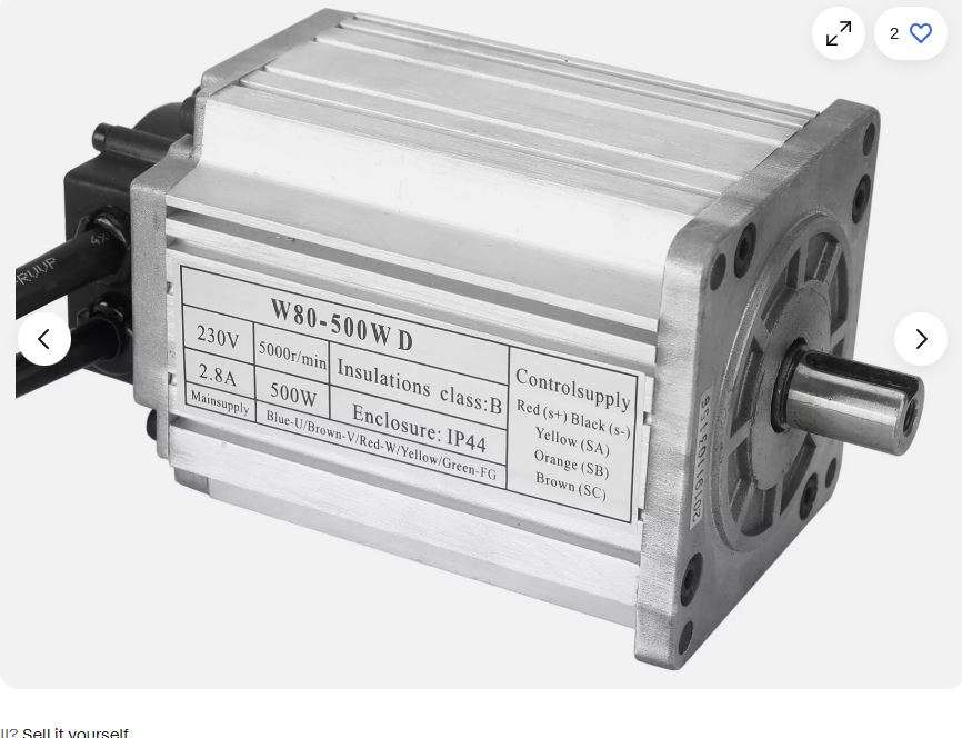

                              #758487
                                On Ian P Said:
                                Motor appears to be 3 phase and the PCB pictures (now that I have looked at them more closely) show that it is most likely a custom VFD. I doubt connecting a 60W bulb (or three of them) will be of much diagnostic use…
                                I agree, the light bulb trick is for brushed motors, not 3-phase or brushless.
                                Important to identify what the motor is.   The SC2 has been around for donkeys years.   The originals had DC brushed motors, the new ones are brushless.
                                Can we have a photo of the motor please?  My examples are from http://www.minilathe.com, first brushless (modern)
                                Or brushed (classic)

                                  Thanks Dave.
                                  so I’ll unsolder and check A (after I google a check) annoyingly the writing is hidden till un soldered.
                                  B is a thermistor and checked out okay, its says 2.5 which is at 20* apparently and it changed as I warmed it with my hand slightly.
                                  C yep your right a bridge rectifier and I just done this check https://www.youtube.com/watch?v=K-oNaQvMQco and it was okay.
                                  Which leave me with desoldering the D’s I guess after I try the other on board checks.
                                    Did I mention I hate diagnosing broken electronics!
                                    Its a brushless motor, 500W I’m 100% sure, will get a picture later but certain of it.
                                    yes me too! unless there’s something obious my brain starts to do loops, I’m a mechanical engineer….

                                    Robert Atkinson 2
                                      @robertatkinson2
                                      The GP7NC60HD is a IGBT (insulated gate bipolar transistor) not a MOSFET. Availale and fairly low cost so a en-mass replacement is a viable option.
                                      http://www.digikey.co.uk/en/products/detail/stmicroelectronics/STGP7NC60HD/1039408
                                      Take the old ones out and make sure the controller does not blow the fuse without them (motor disconnected) to check if they are potentially at fault. This looks likely but could be two turned on at once by the driver or controller.
                                      Check what the 3 14 pin DIL driver IC’s are and consider changing those at the same time. Probably £20 or less in bits and a resonable chance of success.
                                      Robert.

                                                SC2 motor with 5 control and 4 power wires, same on many Sieg machines.
                                                The C2 and C3 have been around for a long time and were the brushed ones. SC2 and SC3 not so old and are the brushed version
                                                sc2 motor
                                                As Ketan says talk to someone who knows the machine like Ian

                                                andy198712
                                                  @andy198712
                                                  Robert.
                                                  Thanks Robert!
                                                  so,
                                                  would it need to be all plugged in to check the L&N pins? There’s no continuity between them
                                                  when I check resistance with the red on the L and the black on the N I get out of limits on all settings
                                                  when I flip them to red on the N and black on the L I get values of 436ohms (but they change slights as I got up the 20k,200k,2000k values at 6.34,34.9,242 respectively) always takes me a while to get my head around that as maths was never a strong point of mine!
                                                  your right there drivers IR2110 which are NLA but digi key has a equivalent that’s only a few quid
                                                  yeah understood, I’ve been very careful about having it unplugged before going near and being aware the caps may store voltage also, I appreciate the warning though.
                                                  okay so next step is remove the 6 heat sinked items (I see you’ve identified them as IGBT’s, thanks again)

                                                    I wondered if there were other connections to the motor Andy, apart from the three ‘phase’ wires (which would indicate that it might be a type of servo motor) but having just read the review on the mini-lathe.com website it states that it is brushless DC motor (the rotor having permanent magnets) rather than an induction motor. The controller board is then not a cut down VFD although it looks to have more circuitry and components than would be required for just a variable speed BLDC motor.
                                                    I note that the user is warned about reversing the motor whilst is is running as it will blow the fuse, a ‘feature’ which I think smacks of poor design.
                                                    Ian P
                                                    Yes there is two bundles of wires coming from the motor, I belive it has a sensing feature also to hold a speed under load
                                                    one lot of 3 from the screw terminals and one small plug of 5 from the board also.
