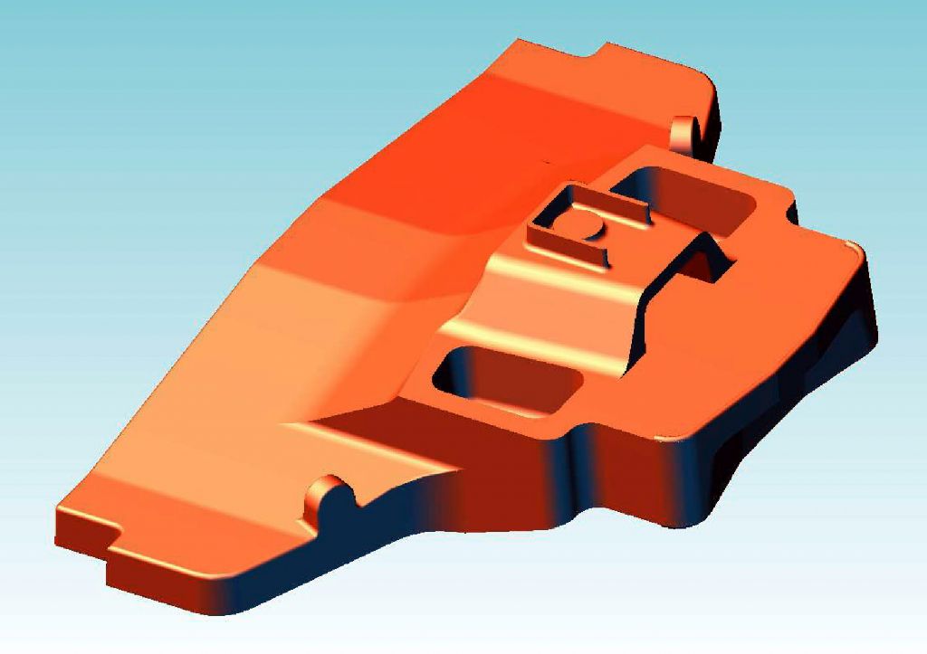

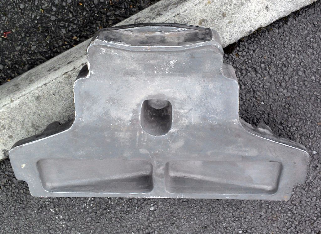

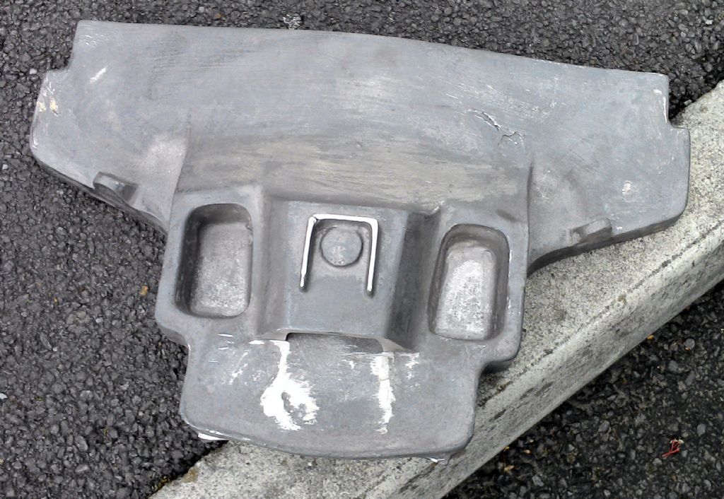

      Jim Nolan (www.northernsteam.com) is building a 7 1/4 version of this magnificent locomotive produced in the UK during the 1950's.
      I have been designing patterns and facilitating the production of castings fr Jim's project.3472 at bethal.jpg

              Wow!
              That is going to be one heck of a beast.
              Hope he has a low-loader in his driveway
              Those castings look nice, but hope that the 'white' where the've been foetrled is just reflection.
              You are lucky to find a foundry prepared to do 'small' one offs.
              Are you using SAR drawings?
              Do please post photos as this project progresses.
              If I was younger, I'd be twisting someone's arm for a set of castings!
              Wish you both well with this build.

                                Yes the white bits are the results of fettling the witnesses from the cores.
                                We are working from the original drawings which are still available. The drawings appear to have been done in the USA but the engines were built by the North British Locomotive Company in Glasgow.
                                This particular component is the front part (sill) of the tender.
                                I am fortunate in having a good small foundry in my locality, so if you are ever stuck for a casting give me a bell.

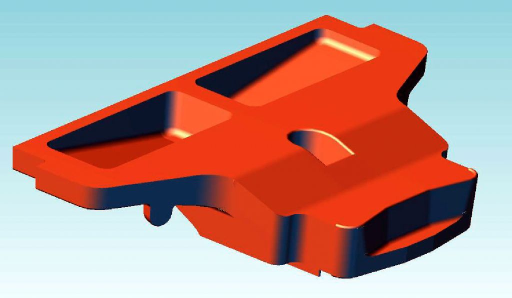

                                          #126015
                                          Ennech
                                            @ennech

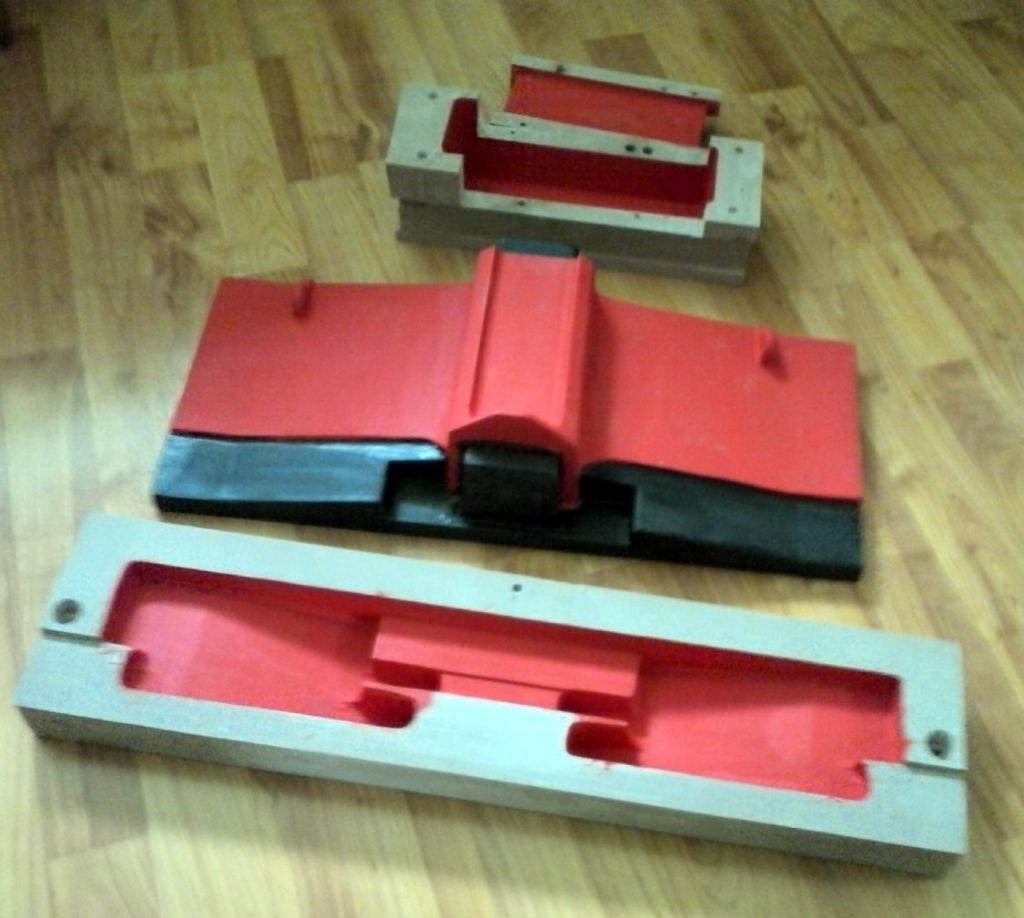

                                            Tender Hind End Pattern and core boxes
                                            #126017
                                            Ennech
                                              @ennech

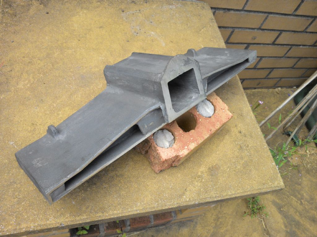

                                              Tender Hind End Casting 13.5kg

                                                  #147676
                                                  Ennech
                                                    @ennech

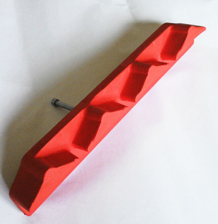

                                                    This is the pattern to cast the brake blocks. It has been designed to cater for the future use of wheels to suit the 7.5" gauge. All the machining operations for 4 blocks can be completed before the blocks are separated.
                                                    **LINK**
