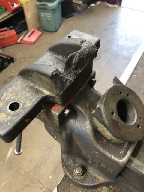

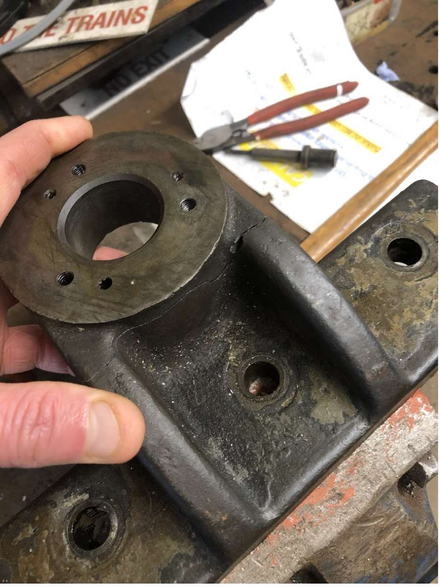

      Good morning all. Due to my own ineptitude, I am looking to find somewhere I can get a cast iron casting repaired. It is the bracket for the leadscrew/handwheel which hangs down from the side of the table of the milling machine at my model engineering club – which is now in two pieces rather than one…
      I’ve already found Slinden Services (https://www.castironweldingrepairs.co.uk/) via some initial Googling, but am in Colchester, Essex – so anywhere more local would be a benefit.
      A couple of photos showing the extent of the problem…
      IMG_4494[1]
      IMG_4495[1]

            Given the geometry and relatively low loading of this casting compared to the accuracy requirement I’d suggest a cold repair. Any kind of hot repair may distort the casting.
            I’d make a jig to clamp it together, drill (and possibly ream) through the webs into the boss for dowel pins. Dis-assemble, clean / degrease then assemble back in the jig with slow setting unfilled epoxy resin (Araldite classic), insert the dowels and allow to set in a warm place.

                Hi jps1982, no extra pinning is needed for that Metalock system, and they only use those shown in the photos. I saw an example or two by that company at an Industrial Welding exhibition in Harrogate, back in the late 60’s / early 70’s, during my City & Guilds, and I have seen the odd one or two repairs that had been done since then. Regards Nick.

                  I would clamp it up, drill and counterbore down those two side webs and into the broken off section at tapping size, then re-drill the webs for clearance holes, tap the threads and simply bolt it up.

                    Think Roberts suggestion of a cold repair is optimistic.
                    That is a pretty substantial casting clearly designed to be capable of handling significant loads. Whether by design needs when in operation or for what we in the MoD research community called “squaddy proofing” ie resistance against damage by careless use or, hopefully inadvertent, abuse. If it needs the dynamic strength no adhesive style repair will predictably hold. I have, in the past, done an adhesive assisted sort of equivalent to the Metalock type repairs by gluing up after though cleaning and carefully drilling and tapping across the break for threaded studs inserted with loctite. Pretty effective but monumentally tedious. Finding positions for enough studs could be hard. Usually used 1/8″ of 3/16″ Whitworth because I had significant quantities of long, fully threaded, steel screws in those sizes that were never going to get used otherwise. In practice a pretty good size choice. Getting in to cut the heads and excess screw of could be tricky in pre-Dremel days.
                    The issue with adhesive repairs is peel strength. The geometry of levering away from one end concentrates the forces at the tip of any crack that can be opened so the joint fails. I’ve done decent adhesive repairs to the sort of thing that”just sits there” but they have always been vulnerable to knock or drop generating peel forces. irritating when the  thing you fixed cos it broke when dropped comes back two years later “But I only knocked it over”.

                      Ouch!  While the bracket “doesn’t do much” it does do something, ie it transfers the effort of the lead screw into moving the table.  Depending on the size of the cutter / depth of cut although the forces are relatively low there is load on it and potentially a cyclic load.  That is why the original has the webs.
                      I have had metalock cold repairs done on a number of castings over the years from gear box casings to large diesel engine crankcases but I think this particular repair would be challenging for that method, you will only get reasonable strength on the sides of the fracture.
                      I have also had repairs done to large diesel cylinder heads by welding, with mixed results.  Another company you can try are Cast Iron Welding Services (also up north!). They have carried out repairs on old castings from full size steam engines.  As mentioned by others I think it is extremely unlikely this could be welded with zero distortion or impact on the alignment.  It looks like the original casting is doweled to the end of the table to ensure proper alignment of the lead screw?
                      Both the repair options are likely to be costly.  Jason’s suggestion is probably going to be the most long lived and cost effective.  You could either fabricate through welding lumps of steel plate and bar a bare “casting” and the machine it or if you could find a suitable lump of plate, hog it out of solid.  If you put pilot holes for the dowel(s) in the new piece you can align to the machine, drill oversize and fit oversize dowels.

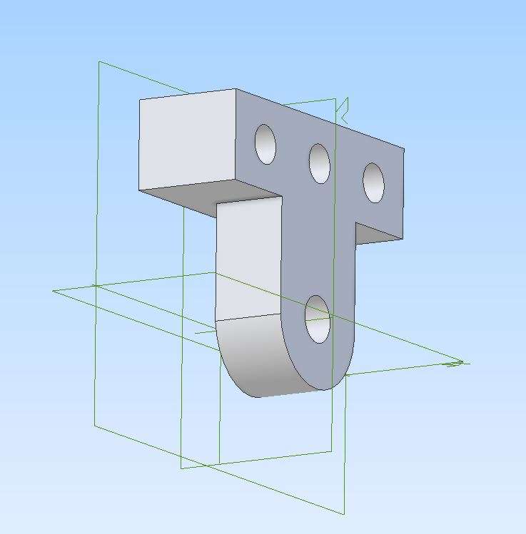

                              It could be made from two pieces of bright mild steel flat screwed together with some decent size cap head screws which would minimise the milling. Even with one axis out of action the holes could be done on the damaged mill by manually moving the X axis to the required position using a plunger type dti or digital calliper to set the position and then lock the axis. Though most could be done using just the Y axis. About £25  for the darker bar @ 250 x 30 x 50 and Around £50 for the vertical piece at 76 x 100 x 150 plus 4No M12 cap heads
                              mill 2

                                                Looking at it again I think a more correct to original look replica could quite easily be made from four parts glued and screwed together.
                                                A cylinder with cut away sides for the bearing, a flat plate to provide the fixing points and two suitably shaped plates replicating the webs to join the bearing barrel to the mounting. Shallow slots in the mounting plate for basic alignment of the webs and stability when glueing. Three or four countersunk head screws tapped right through into the webs will make it solid against shock blows. Make the bearing barrel and shave down the sides ton be nice fit between the webs. Glue together and add a suitable number of screws fixing into holes tapped into the bearing barrel after glueing together.
                                                Tapping for support screws after glue ensures alignment is maintained and the smaller sizes of material may be less costly. Cutting a basic barrel from suitable sized round stock is probably the easiest way of creating a good bearing hole for folk not particuarily experienced with boring heads.
                                                More parts and bit more work overall than the T shaped fabrications proposed by Jason but I think each step may be easier and all in all a bit easier to tweak things so it comes together right if a measurement error has been made. I’ve seen things similar to the bolt up T in Jasons second post come out just enough wrong not to work due to small measurement errors building up.
                                                If following Jasons second suggestion it would seem advisable to cut an alignment groove in the cross bar. Essential i’d think if doing things as a co-ordinate drilling exercise for two mating parts on typical Home Shop machines
                                                For a similar sort of structure, designed not repaired, I screwed the other way with countersunk head socket screws running from the inside face of the equivalent part to the cross bar.
                                                Fitting the bearing hole after the basic T has been made minimises the chances of error. Bolt the mounting face to the machine table to avoid tilt.

                                                      Going back to a cold repair I’ve looked at the photos of the part more closely. Epoxy the two parts together (unfilled, the rough surface of broken CI gives a large surface area and close fit).  When set machine (or file if no other mill available.) the sides of the boss and webs to give a flat surface and possibly a small flat at 90 degrees. Then fit a flat steel plate either side fastened with multiple screws.
