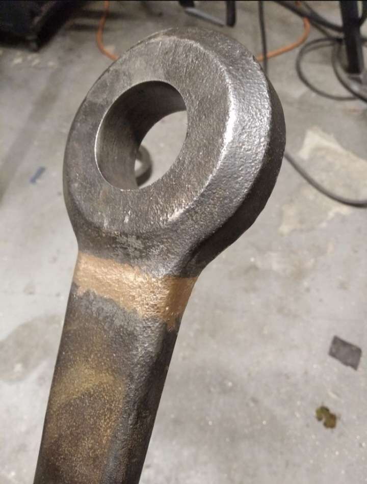

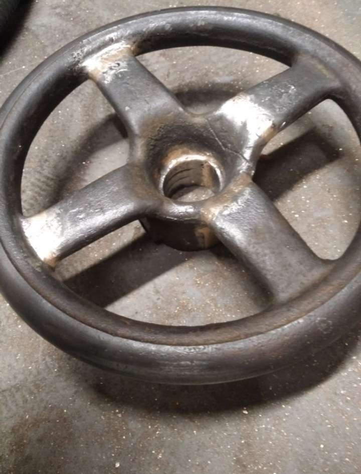

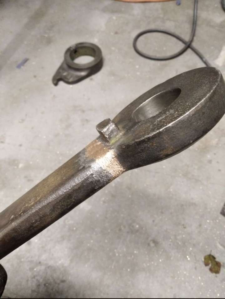

            #830011
            Pete.
              @pete-2
              Just Mig bronze braze it, a small roll of bronze wire if I remember rightly was about £30, you’d probably repair that for about a fivers worth of wire.
              No preheating required,  no cracking from welding, quicker, cheaper than fabricating a new part, a few parts I repaired a while back below.

              #830016
              renardiere7
                @renardiere7
                You would need to get straight Argon if you want to MIG braze but it is a good option.
                #830062
                Fulmen
                  @fulmen
                  Very nice work there Pete. Didn’t even know you could get bronze mig wire, learn something new every day.

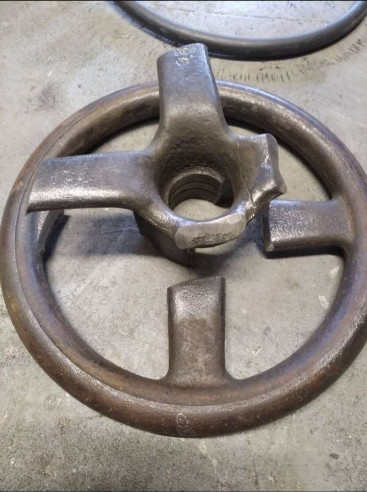

                    #830192
                    jps1982
                      @jps1982
                      Thanks everyone for the suggestions and recommendations. The work on that wheel looks very reassuring as to what is possible!
                      #830221
                      Robert Atkinson 2
                        @robertatkinson2
                        The handwheel is much thinner and lighter than the bracket. I wonder much penetration you will get with a MIG welder on the bracket.
