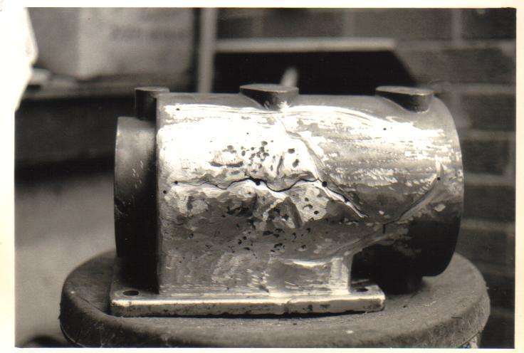

                This is the full size original cylinder of an engine I’m currently working on at 1/3rd scale. Original is just over 12″ long and you can see how the frost cracks have been deeply ground out in preperation for repair, somewhat bigger than the gap you nee dfor silver solder(braze) but the filler material will get right to the bottom of the cracks as they have been ground out to allow for that.
                ha crack

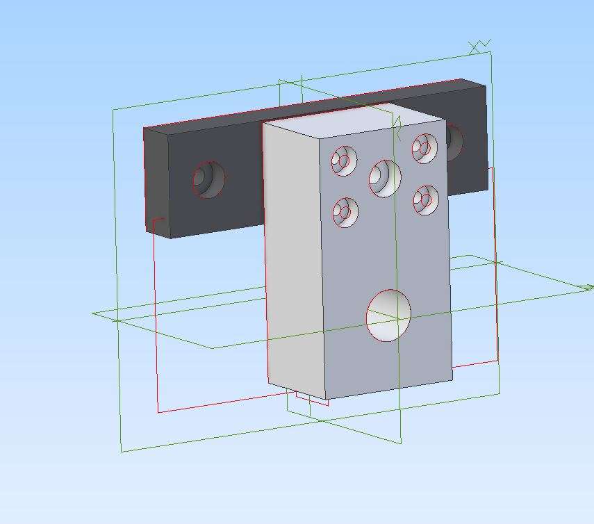

                                        On JasonB Said:
                                        It could be made from two pieces of bright mild steel flat screwed together
                                        mill 2
                                        The repair is still work in progress but the more regular club attendees put their heads together and have decided to do something similar to JasonB’s suggestions.
                                        The two sections of the original part with mounting faces are going to be retained (I.e. the top of the bracket that clamps to the table and the round boss, which the wheel is mounted to) and a thick plate of mild steel will be used to attach the two, with suitable machining to retain the original dimension between the faces. Assuming it all goes well I’ll add some photos once it’s all back together!
