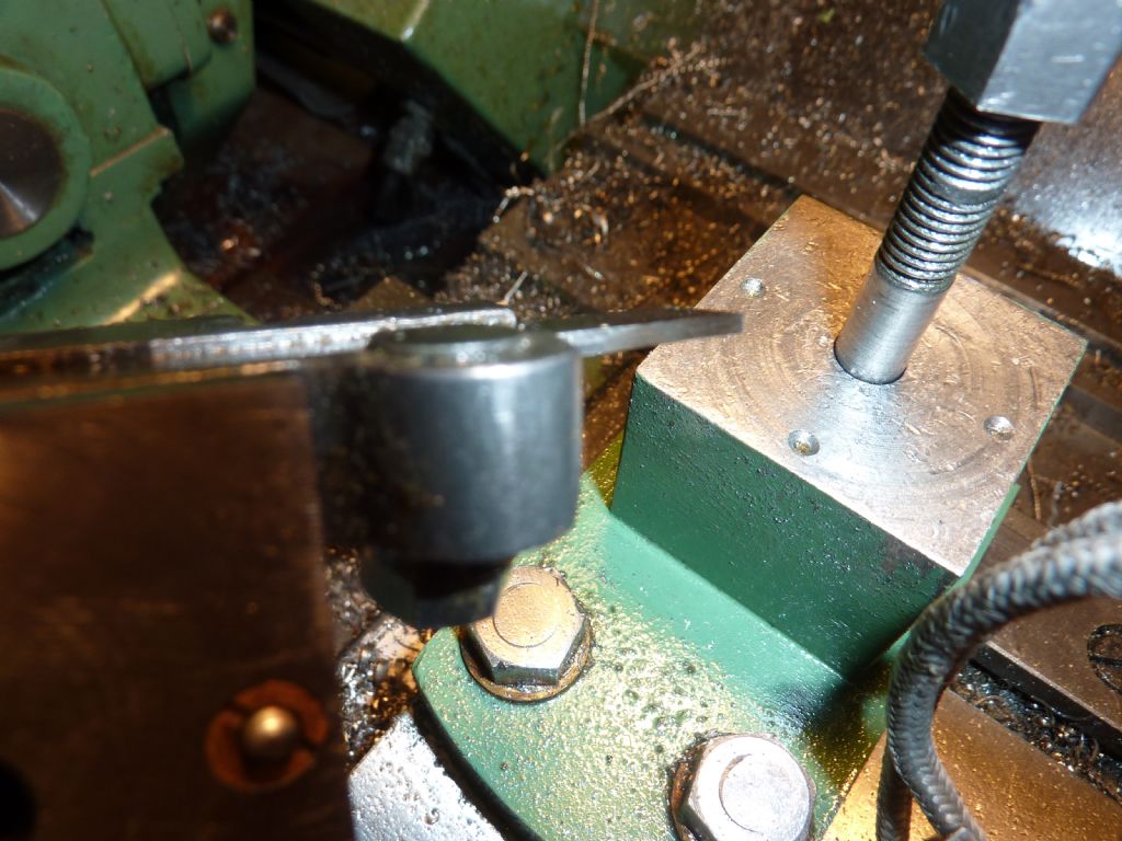

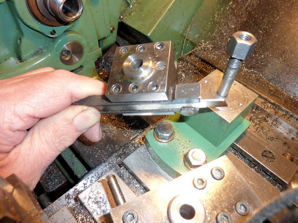

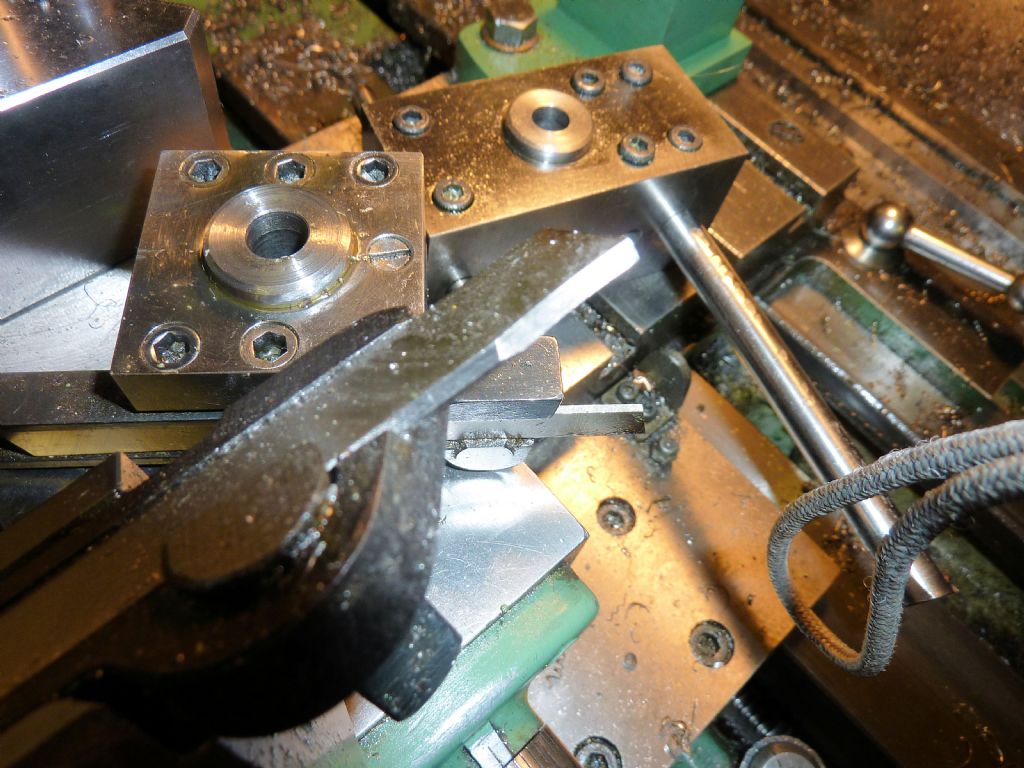

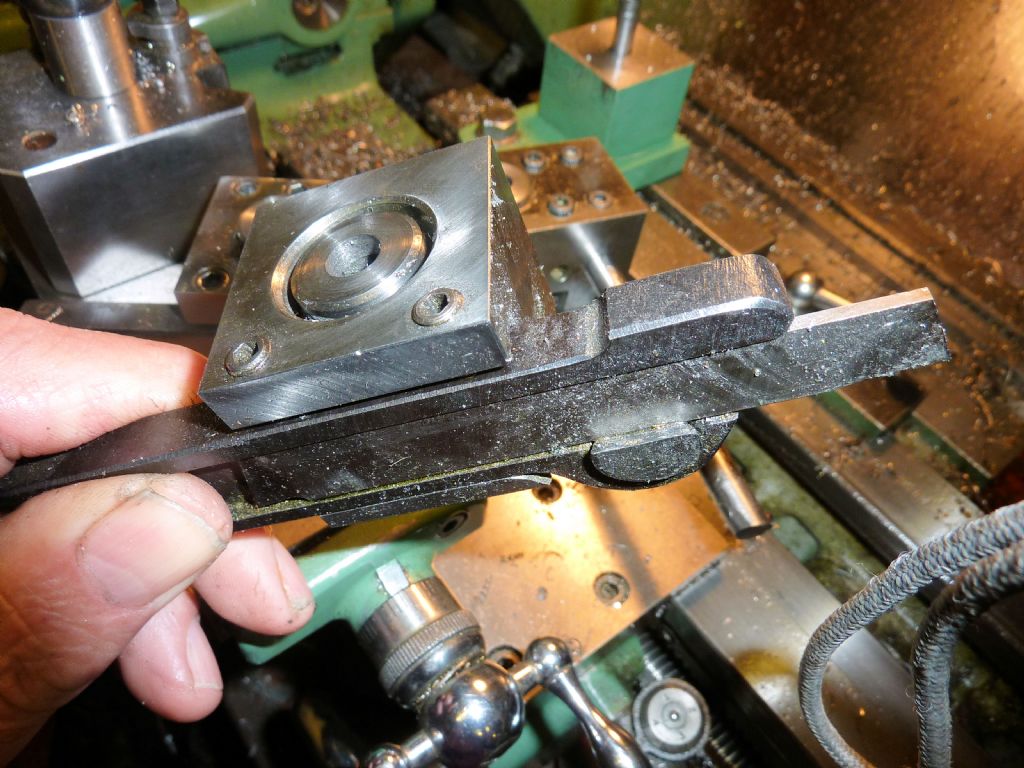

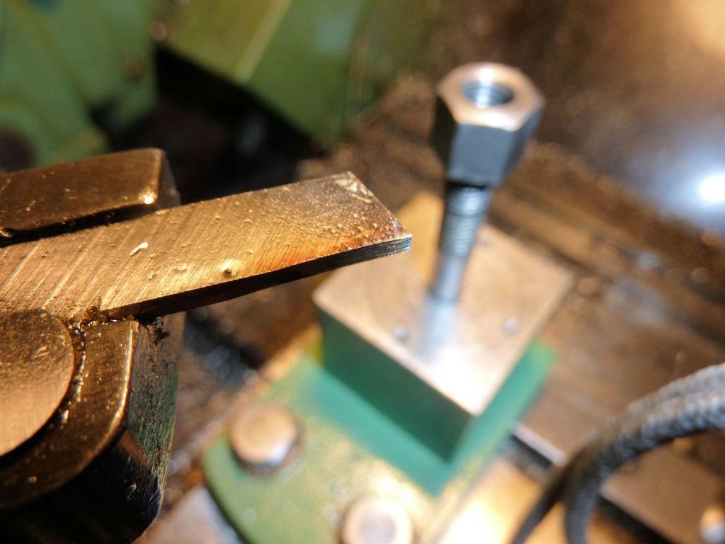

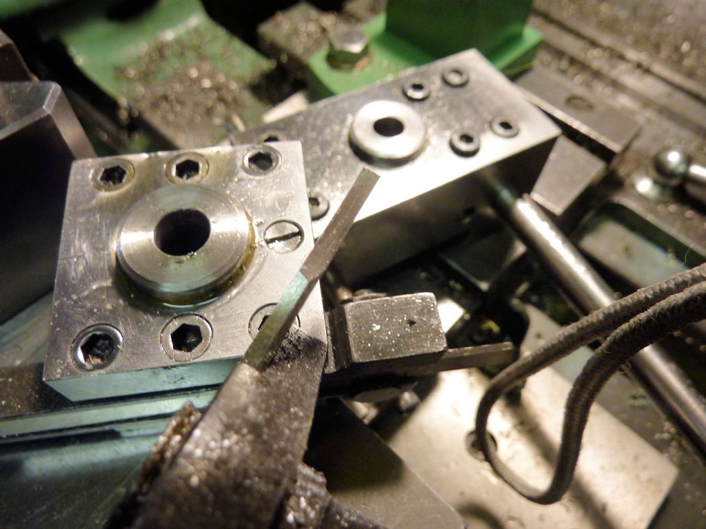

                        Chris Heapy
                          @chrisheapy71135

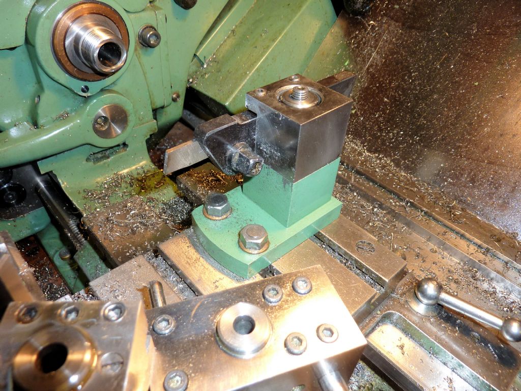

                          To the OP, I took some photos by way of a better reply.
                          This is my rear tool post, which I made many years ago:

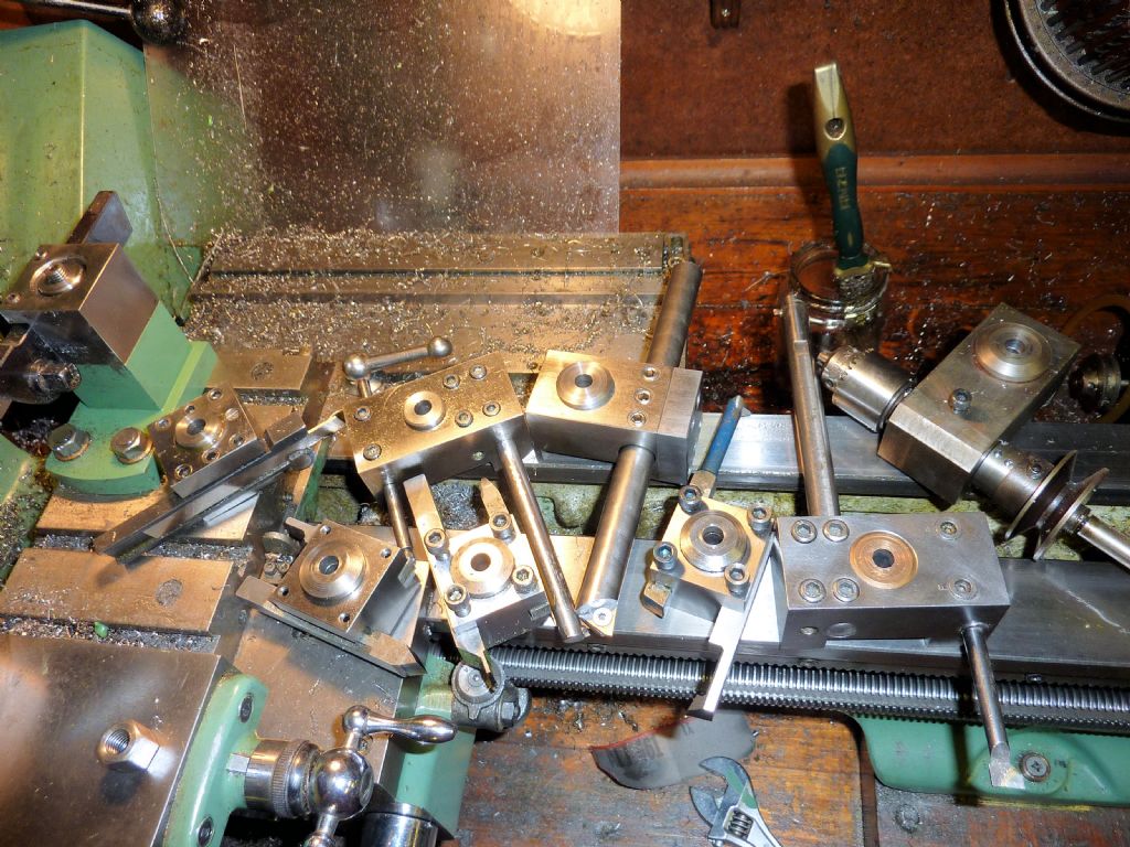

                          …and some of the tooling made to fit it:
                          This is the Eclipse 1/16" bade parting tool:
                          Difficult to photograph, but this is the cutting edge of the 1/16" blade:
                          This is my 3/32" blade parting tool – like yours I think:
                          …and more attempts to image the cutting edge of the 3/32" blade
                          I am not saying the cutting edge shape is either 'correct' or recommended – only that this is what I find works for me with these particular tools on my S7B.
