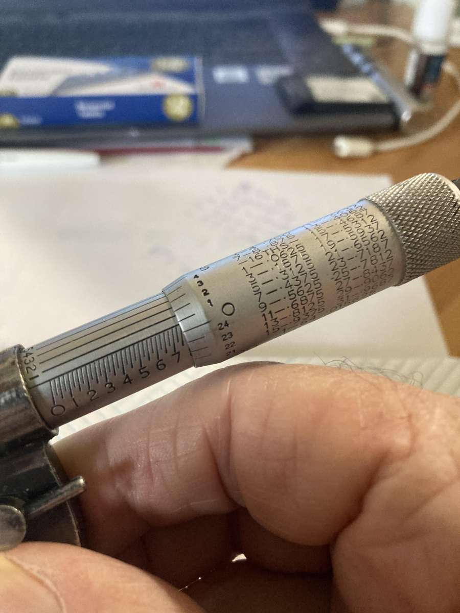

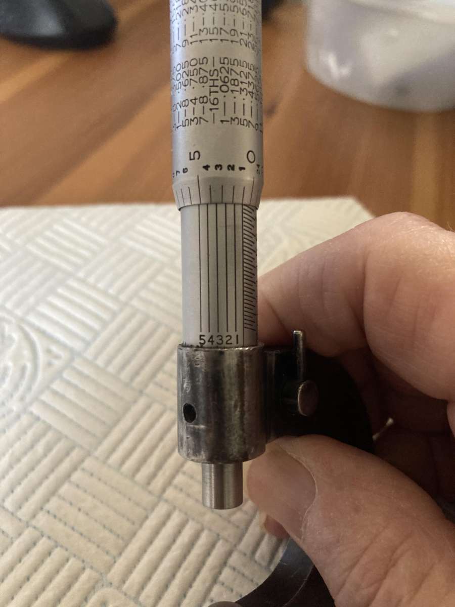

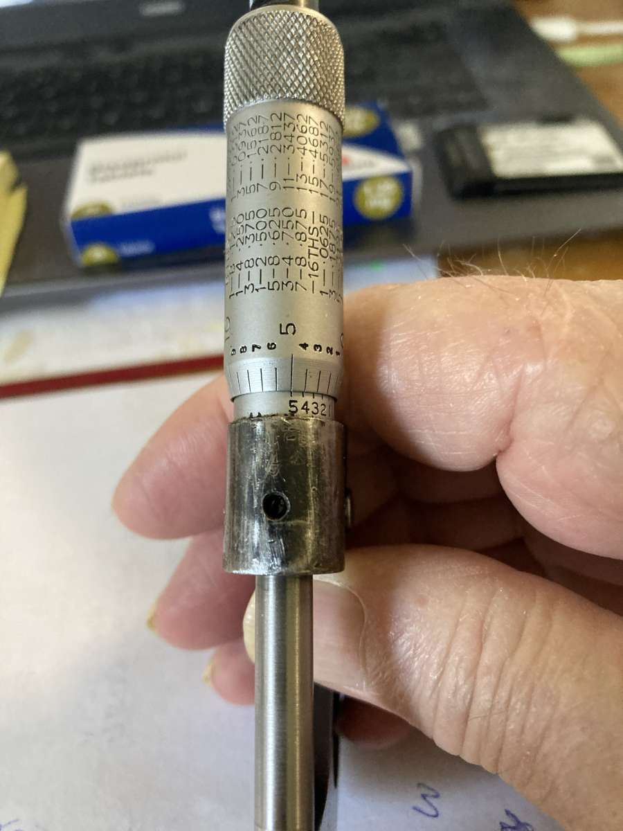

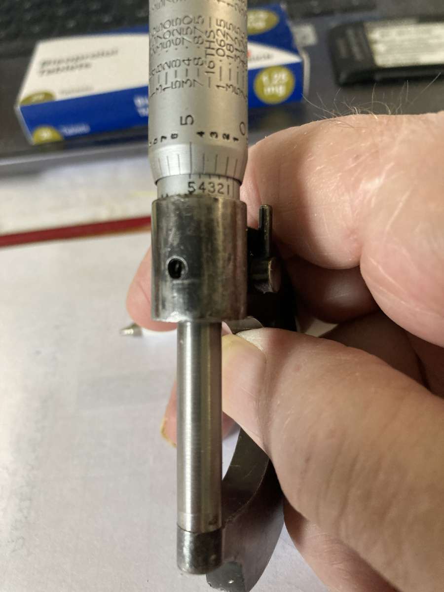

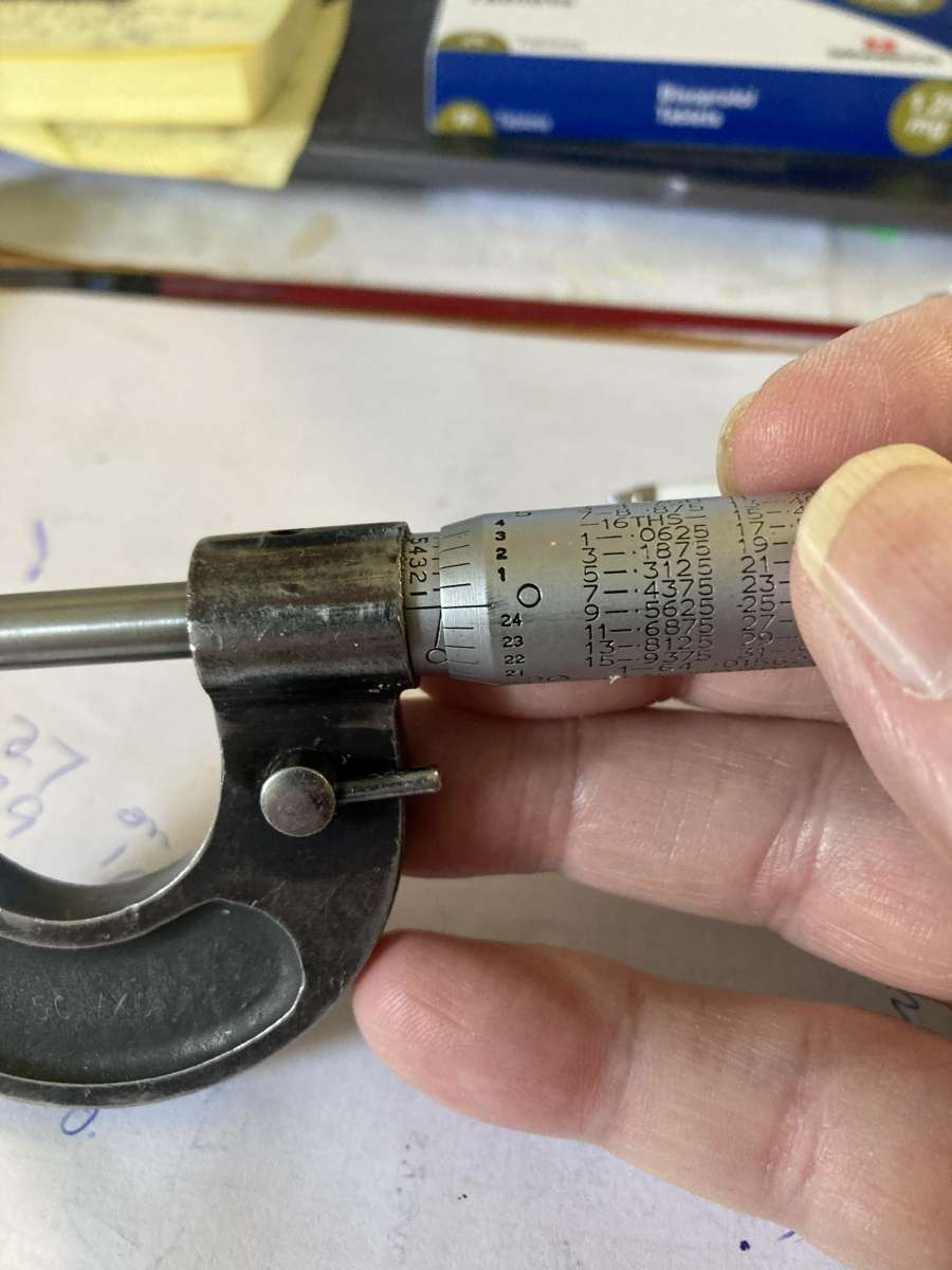

          thanks for reply Jason, here are some photos, hope they are in correct order. You need to start from the bottom. Wrong order. 1 = 0, 2 = 0.5, 3 = reads 5, 4 = 0.7, 5= nothing lines up, something is missing. IMG_3937IMG_3936 IMG_3935 IMG_3934

            the mic is a Shardlow 0VX6, very nice. 1952 ish?

              there are 5 vernier divisions, each one is 1/10th, move it 5 divisions and you have 1/2 thou, where’s the other  1/2 thou measured? I haven’t got 10 divisions! Graeme.

                Are you sure that the graduations on the Thimble don’t constitute a vernier scale?
                In which case, you would read off against where the lines on Barrel and Thimble align, just like any other vernier, rather thasn directly. Thimble numbreading 0.001 +, with one of Barrel graduations aligning perfectly with one on the Thimble (Say 3) in which case 0.001 + 0.0003 = 0.0013)
                Should be obvious, as with both Zeroes aligned the intermediate graduations will not align precisely (Possibly 5th  graduation on the Vernier scale will align with a 4th or 6th on the barrel, but with the others very slightly out of line.

                  Once you get to 0.0005, the next thou division up wll start to align, so you then take the next thou upand knock off n tenths.  Hence you are not five lines short of a micrometer.

                    Move it to a .0005 position by eye on the course division on the thimble and confirm you are reading that correctly. Then move it on a tiny bit to .0006 and see whether something aligns with the “1” again.
                    My M&W has 9+0 vernier marks but I can’t really see if they are any different spacing from yours.

                      thanks Howard. i can assure you it’s a vernier scale. Nothing can align again until the vernier reaches it top zero, go past 5 and theres nothing to align to.

                            Perhaps the barrel should be fitted further to the right, and currently covers some more markings?

                              Please could you show a picture or two showing the barrel and vernier for readings greater than say, 0.215 so my thoughts can be confirmed or disproved?
                              Go past 5 on the vernier and your measurement is greater than X+ 0.0005. The next alignment will be with 24 on the thimble and 1 on the vernier. That’s 1/10 of a thou greater than the 5/10 thou you have just past, so X + 6/10 thou and so on.

                                Just been out to the workshop, briefly as it’s freezing out there, so not tried to set up for photographs.
                                I have several Shardlow tenths mics, but my only one with 5 vernier divisions is an internal one; the rest all have 10.
                                All those with 0-10 on the vernier have that scale going further around the barrel as one would expect.
                                The 0-10 vernier scale equates to 0-9 thou on the thimble, again as one might expect.
                                That internal Shardlow mic, and a couple of non tenths external mics, have intermediate ½ thou divisions on the thimble;  The 0-5 vernier scale measures 0-4½ on the thimble, so one would need to use a half division for the other part of the scale.
                                I wonder if your thimble may have been swapped under a previous owner?
                                In a way, for the internal mic, it makes sense just to have 0-5 as, if being used to measure a bored hole on a lathe, the second half of the vernier from 6-10 wouldn’t easily be visible as the workpiece would obstruct the view.
                                This is particularly the case, since on the Sharlow 0-10 mic(s), the vernier doesn’t start until +3 thou round the thimble.
                                Moore & Wright, Etalon, Mitutoyo, Chesterman, and others have their 0-10 vernier divisions starting along the main zero line on the body, whereas on my own Shardlow, Starrett, and Smart & Brown, the 0-10 vernier scale only commences at 3 thou round on the thimble.
                                On the 0-5 Shardlow vernier, it does commence on the zero as per Graeme’s photos.
                                Since Sharlow were one of the initial Sheffield makers, I wonder if they followed a US practice initially commencing the 1-10 marking a bit further round the body. Some of their first mics were base on a Slocomb design.
                                M&W, Shardlow, & Chesterman, were the three initial mic manufacturers in Sheffield, M&W took over Shardlow (Shardlow/GKN) and obviously continued to make mics, whereas Chesterman later specialised in linear devices like vernier callipers & height gauges.
                                M&W dropped quite a few of the more interesting Shardlow designs after the takeover, such as the direct reading “Speedread” copy of the Slocomb, and the really oddball AngloMetric.
                                The latter uses a 50tpi thread, so 20 thou per thimble revolution; metric readings are taken using a second curved red line around the body. 14:16ish on the video below; having got a couple, I can see why they didn’t catch on.
                                Far easier to use are the Mitutoyo counting/direct-reading ones, which are available as all imperial, all metric, or counting metric with imperial vernier, and vice versa.
                                The Shardlow Speedread direct reading mic has numbers of thou (or mm) in little windows; the  vernier scale around the body is 0-10 but the thimble is not enumerated at all, you just read the tenths off the body vernier.
                                Personally I do like the ones with the sloping main lines as per the above photos.

                                  If that barrel is original, I recon the mic was designed to measure in 0.0002″ not tenths. I do have mics in tenths and also in microns, but if the mic is adjusted exactly it is easy to just read them as well without bothering with the vernier scale.

                                    Hi , he barrel is in its correct position. Photos of others of this ilk verify this. Graeme.

                                        Hello peak4, thanks for your informative reply and interesting video. I’ve got a notion that I shall take up the commentators offer of a guided tour of the museum metrology dept. I’m only 20 miles from Sheffield.
                                        My mic is a model 1V and has the original thimble and angled lines sloping to the right with numbers below the datum line. There are models with lines sloping to the left with numbers above. This mic  has the zero below to enable room for the vernier engravings to be administered, if the zero was above or in line with the datum line, there would be no room for the engravings to start. This is the reason for your mic starting its vernier travel from 3 thou. The datum line is the set point for zero, vernier scales can start anywhere on the circumference of the barrel as long as the zero aligns with a whole number line on the thimble at zero [ not a half thou etc], yours starts at 3 purely for convenience for vision of the scale. If your vernier has 10 lines etc you can see any amount of 10ths you have reached, not so with the 5 increments that I have. Which model is yours? I can look out for one for my collection. If you have a mic with 5 vernier increments, measure a slip gauge of 0.1003 and read off the result, try a 0.1007 and  you wont see a result [only a guess], but there is a result there somewhere and its staring right at you, but where? Graeme [thanks for spelling my name correctly]

                                          Hi old mart, thanks for your reply. I see your reasoning about 2 tenths, but this mic has 1 tenths, move it 5 increments and it shows 1/2 thou. Is not using a vernier scale not guesswork??? You will be close but never as perfect as the inscribed lines etc. Yes, the Anglometric mic is very slow to use, but a wonderful micrometer. Thanks, Graeme.

                                              If the divisions were meant to represent 2/10 I would have expected them to be numbered 2, 4, 6, 8, 0 rather than 1,2,3,4,5
                                              I’ll have to play with my 10 division mic to see what line sup if you are a 10th or two undersize. But does seem a bit odd if you are expected to take a reading that is 2 divs under and subtract that from the full thou to get say 0.0008
                                              Maybe that is why it is a rare one, the 5 divs did not catch on?
                                              Any chance of a photo showing the markings along teh body when it is opene dup a bit.

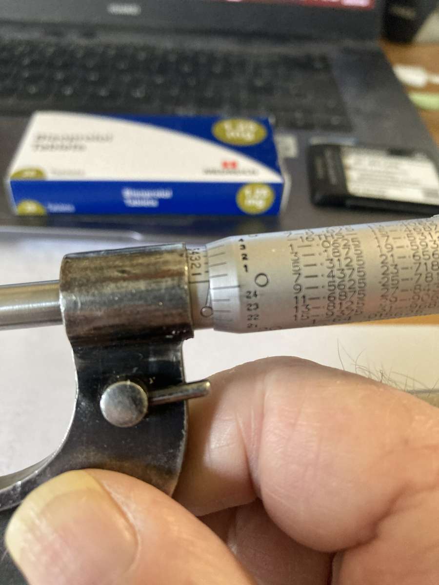

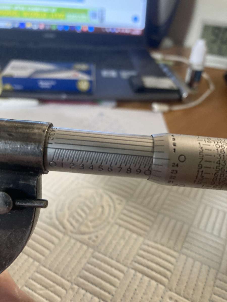

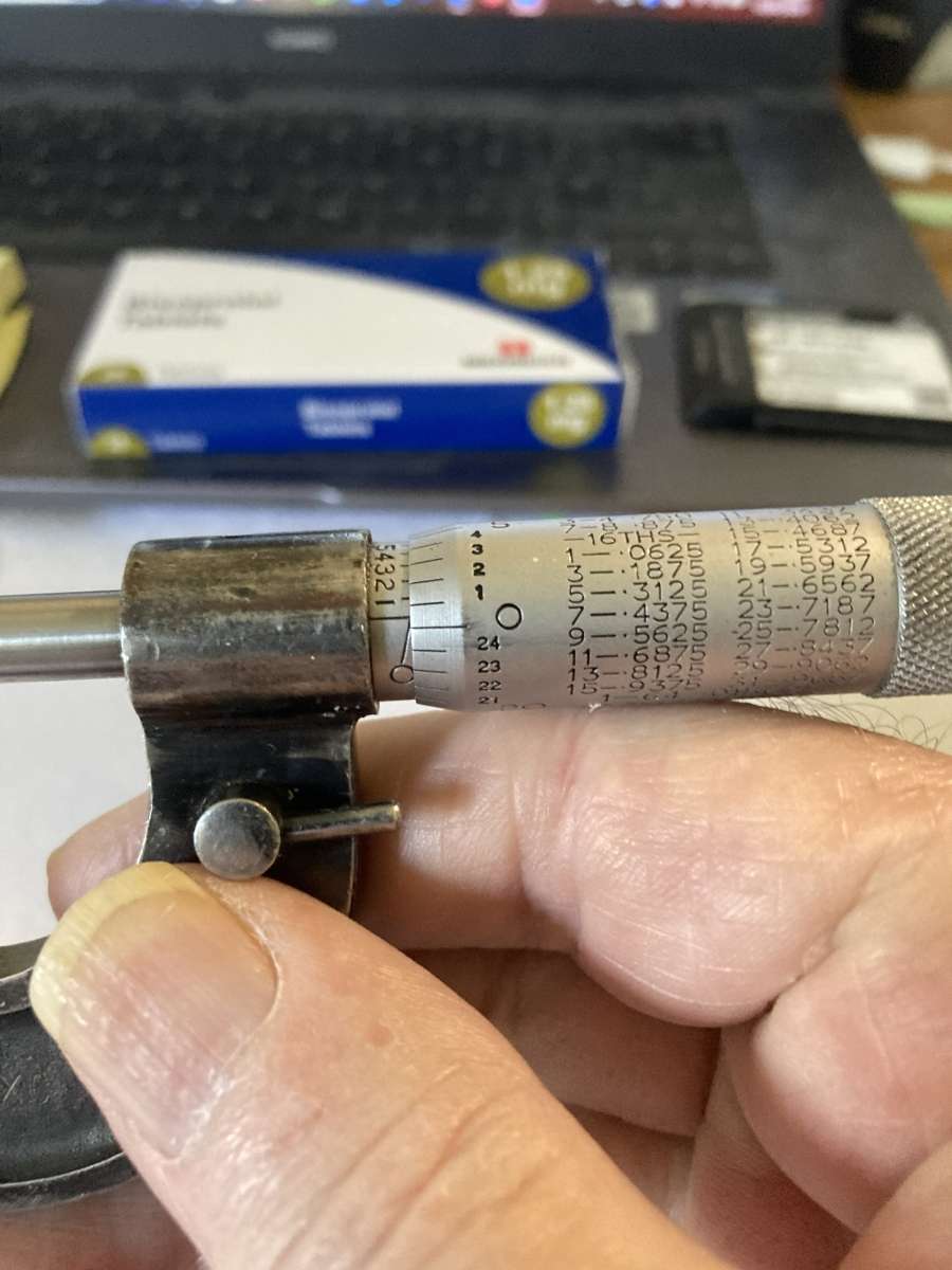

                                                  Hi Jason, yes, correct 1/2 thou is 5 divisions. I’m measuring in whole thous and little bits and have discovered the secret of the missing 5.
                                                  The answer is the positioning of the numbers on the right. They are not attributed to lines but to spaces. The rule of thumb with this type of mic is, left to right for alignment of lines up to 5, then right to left for alignment of centre of a gap to the vernier line, read the 10ths on the left side. Here’s an example of 0.0008. the photo shows over the half of the thou, so you have 0.5 thou+****. Next find the 0.0003 using what I’ve described about. Find any line that in the centre of any gap and read off on the left Add this to your 1/2 thou. Hey Presto.

                                                    Have you got any slip gauges that you could use to prove your findings ?
                                                    I must say I have my doubts about a micrometer designed to guess the gaps between the lines.

                                                      Seems fair enough. This dates from the days before arithmetic became math, and when a semi-skilled machine operator could confidently do the necessary sums his work entailed on a proper sheet of foolscap.
