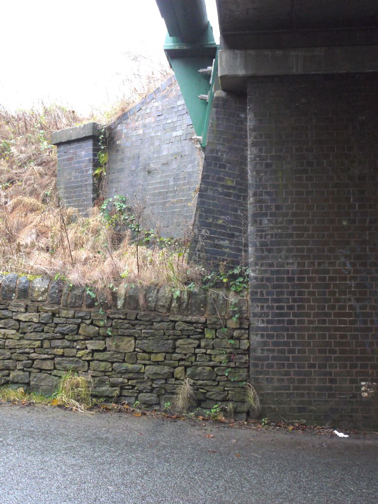

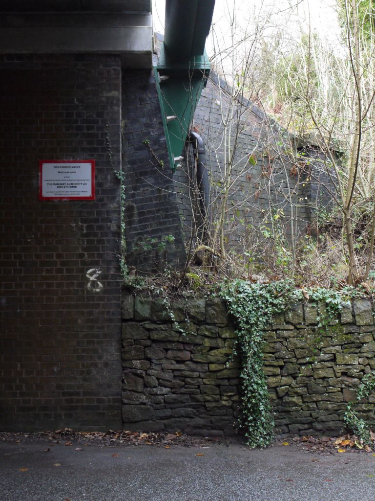

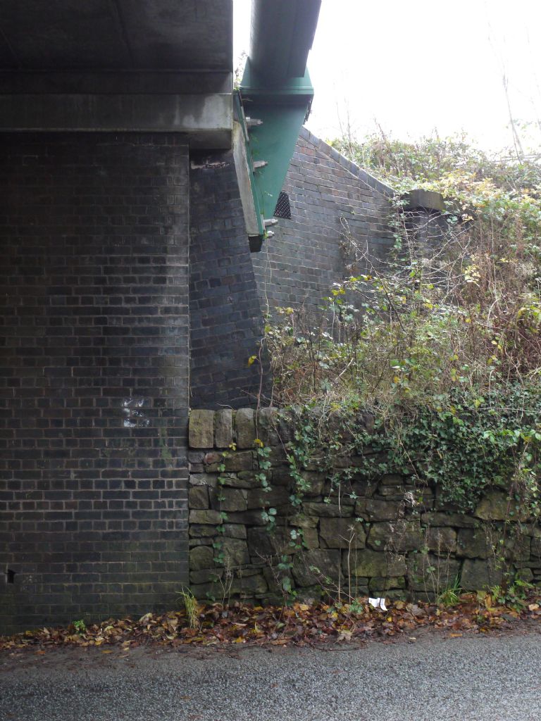

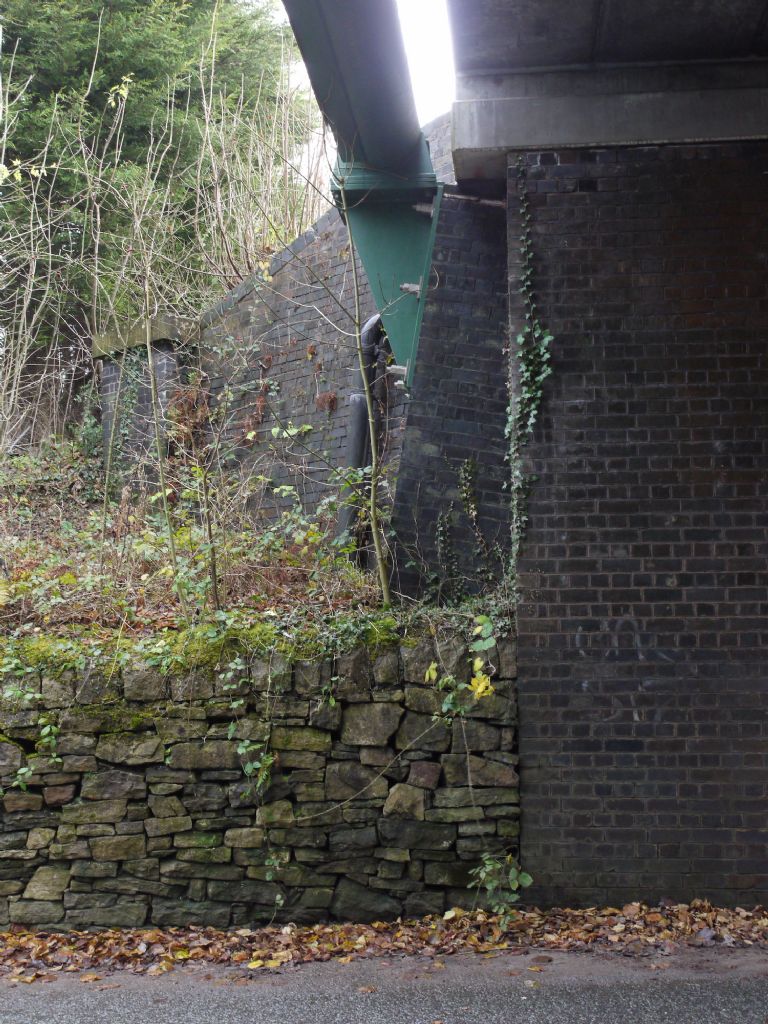

                The dentist was not a lot of help [he's better with canals] … so I took a few more photos
                Here are the four corners:
                Observant viewers will note that the upper 'studs' are horizontal at the high end of the bridge, but all the others are perpendicular to the buttresses.

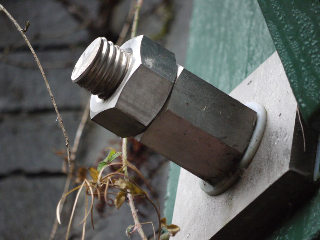

                #440560
                  And here's the 'product shot' of the nuts:

                    #440571
                    Tim Stevens
                      @timstevens64731
                      It is possible, I suppose, that the deep 'nuts' are in fact spacers , or nuts with the thread bored out. This would allow for a longer section of the bolt to be involved, allowing for greater elasticity, and better fatigue resistance. But I expect that this is just 'how grandad did it' in modern terms, even though grandad never went to college.

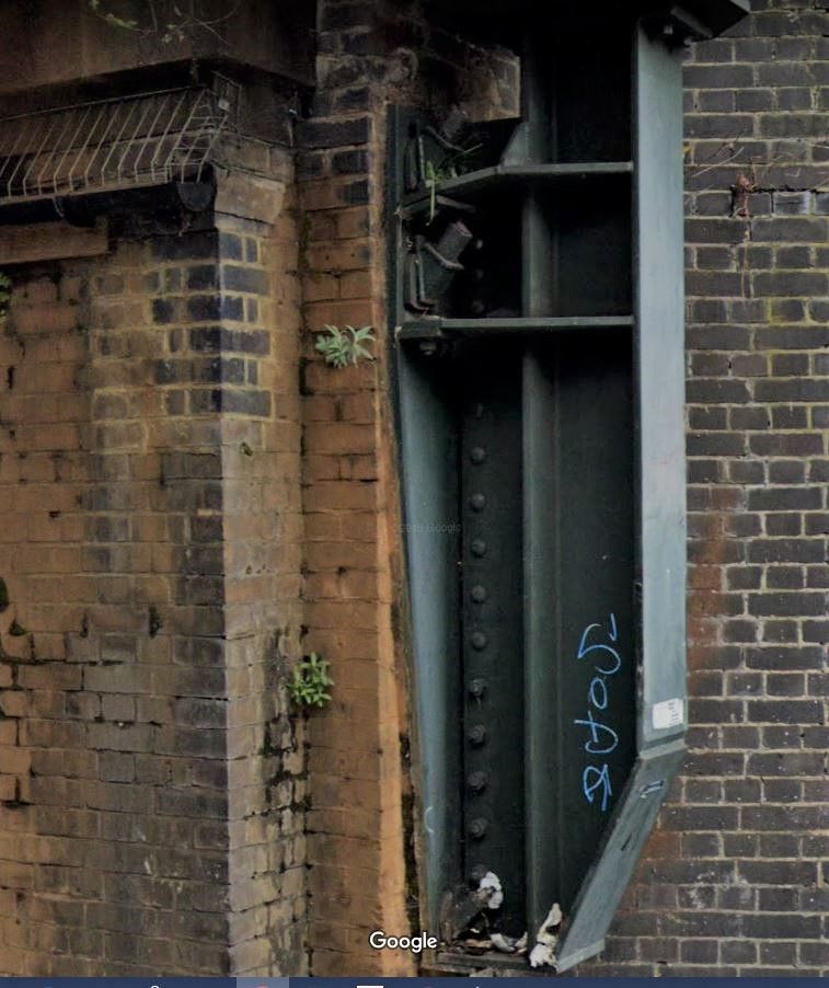

                        #440641

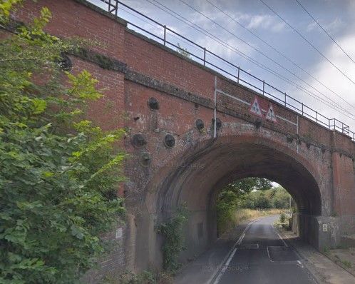

                        John MC
                          @johnmc39344
                          Theres been some mention of bolts passing through the width of the bridge. The large "washers" on this bridge are fitted to through bolts to repair and strengthen the structure. The bridge is on the London/Bristol main line. I remember it well, this bridge was on my daily commute and the road closure and traffic lights caused chaos. I felt very smug as it made little or no difference to me as I cruised by the long, long queue of traffic on my bicycle!

                          #440692
                          old mart
                            @oldmart
                            Now the side view puts things into perspective, it is obvious that the bolts do not pass through. I did notice that the bolts into the concrete are not the same from side to side. I expect the threads were lubricated, as they look like stainless steel rather than galvanised.
