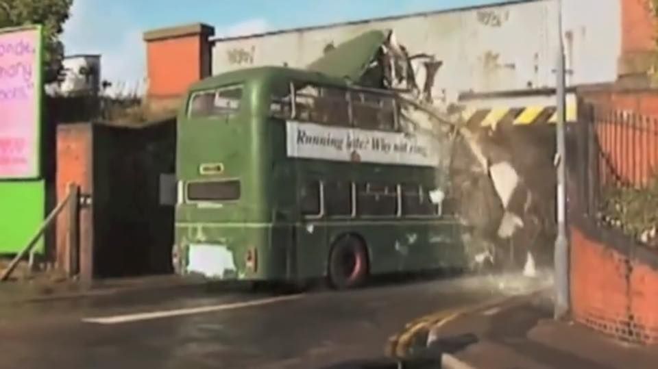

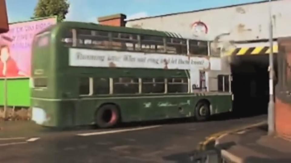

                                    Bridge strike!
                                    This was a test carried out in 1996 at the Whitehouse road bridges, Swindon. These bridges, a group of 4 I think were at one time the most hit bridges in the country.
                                    I wonder who volunteered to drive the bus?
