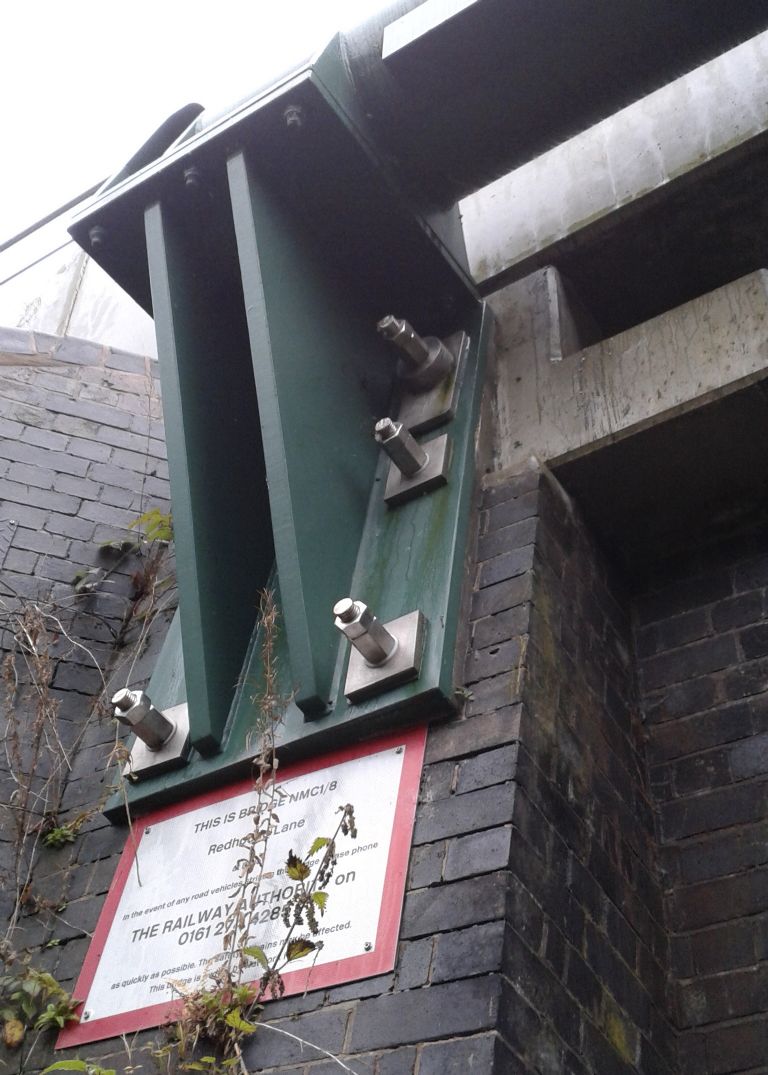

      With the festive season fast-approaching, I thought it time to revive an old Chestnut: Here is an example of modern work
      Seems pretty unambiguous … but feel free to discuss.

        Mike Poole
          @mikepoole82104
          Theoretically incorrect but seems to work.
          Mike
          #440116
          DMB
            @dmb
            Weird looking. Why the huge tubular spacers?
            #440118
              Posted by DMB on 03/12/2019 23:11:31:
              I think they are long nuts … suggesting, perhaps, that they are done-up very tight.
              #440119
              Henry Brown
                @henrybrown95529
                I wonder if the longer hex parts are attached to the spreader plates, the hex is used to stop the spreaders turning as the nuts are tightened?
                #440121
                peak4
                  @peak4
                  I wonder if they are counter-bored, but with a "Normal" or "Heavy Nut" thread length.
                  i.e. the studs have a parallel section sticking out beyond the fish-plates before the thread starts.
                  Hence the top one with the circular spacer, as the stud was even longer.
                  It might allow them to be torqued up correctly whilst ensuring the shear load is on the parallel section of the stud, rather than the reduced area of the root of the thread.
                  Bill
                  Edited By peak4 on 03/12/2019 23:57:52

                  Mark Rand
                    @markrand96270
                    Seems perfectly correct to me. The lock nut is of a smaller thickness and on top of the main nut.

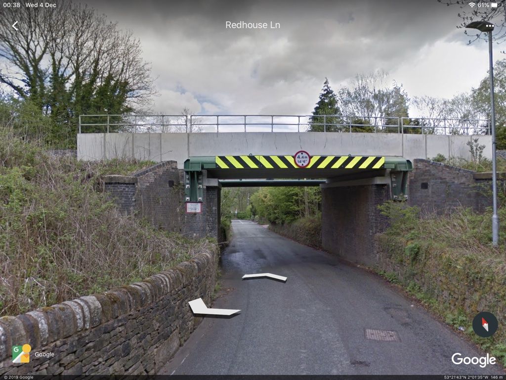

                      I should mention that the green brackets support a substantial tubular ‘bull-bar’ to protect the concrete bridge from impacts by high vehicles.
                      Credit Google Earth

                        I wonder how far the anchor bolts went into the bridge ? Did the top bolts hit an impenetrable object that required an extra spacer under the nut? Looks like a good installation to me. Enough to take the top off a double decker bus!
                        #440133
                          Top one being into concrete may have hit some rebar so did not get drilled so deep hence the packer., I would expect them to be resin anchors rather than sleeve or expanding type. The middle one is not placed that well being in or close to the junction between brick and concrete.
                          As to the nuts that's simple the guy could not be bothered to shorten the threads so just popped some jointing nuts on first as he knew a model engineer would soon be along and not be impressed if he had too many turns of thread showing above the top nutwink

                          Ian P
                            @ianp
                            If the bridge in the Google Earth picture is the same one as the one in Michael photograph then the bracket looks to have been modified or altered at some stage.
                            In Michael's picture there are 6 fixings to the masonry but there appears to be 8 in the second image.
                            Just curious.
                            Ian P
                            #440135
                              Ian, I think you are seeing 6 fixings but the top ones into the concrete have a rectangular "washer" not square like the lower 4

                              Mick B1
                                @mickb1
                                If it'd been me, I'd've found it hard to walk away leaving that bottom right square washer – if that's what it is – visibly on the skew.

                                John MC
                                  @johnmc39344
                                  Posted by Mike Poole on 03/12/2019 23:05:53:
                                  Mike
                                  Why?
                                  #440138
                                  Brian H
                                    @brianh50089
                                    I suspect that is because the thin nut should go on first.
                                    It looks as though the end of the thread has been hammered over to prevent removal.
                                    Brian
                                    Edited By Brian H on 04/12/2019 08:25:03
                                    #440139
                                    Hopper
                                      @hopper
                                      OMG but the bridge men have put the thin locknuts on second, following the practice of engineers and fitters throughout the 19th and 20th centuries on applications such as big-end bolts on large marine diesels and before that steam engines, instead of adhering to the 21st Century ISO standard ( section 5 of ISO 898-2: 2012 Mechanical Properties of Fasteners made of Carbon Steel)  of putting the thin nut on first then the thick one. The science of which is outlined here **LINK**
                                      Science deniers, that's what them bridge men are. Next thing they'll be telling us climate change is a hoax to institute a one-world government. Somebody alert the authorities at once, before the bridge collapses and kills Santa Claus.
