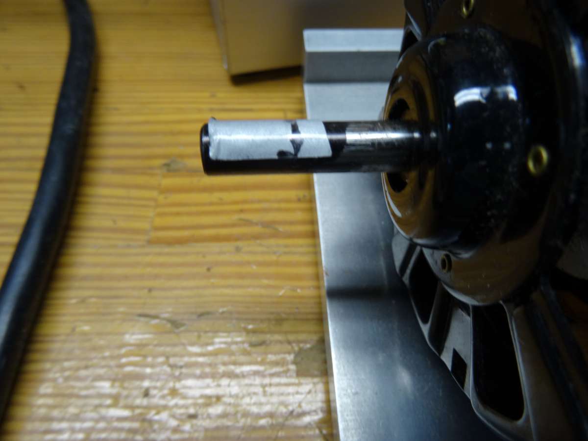

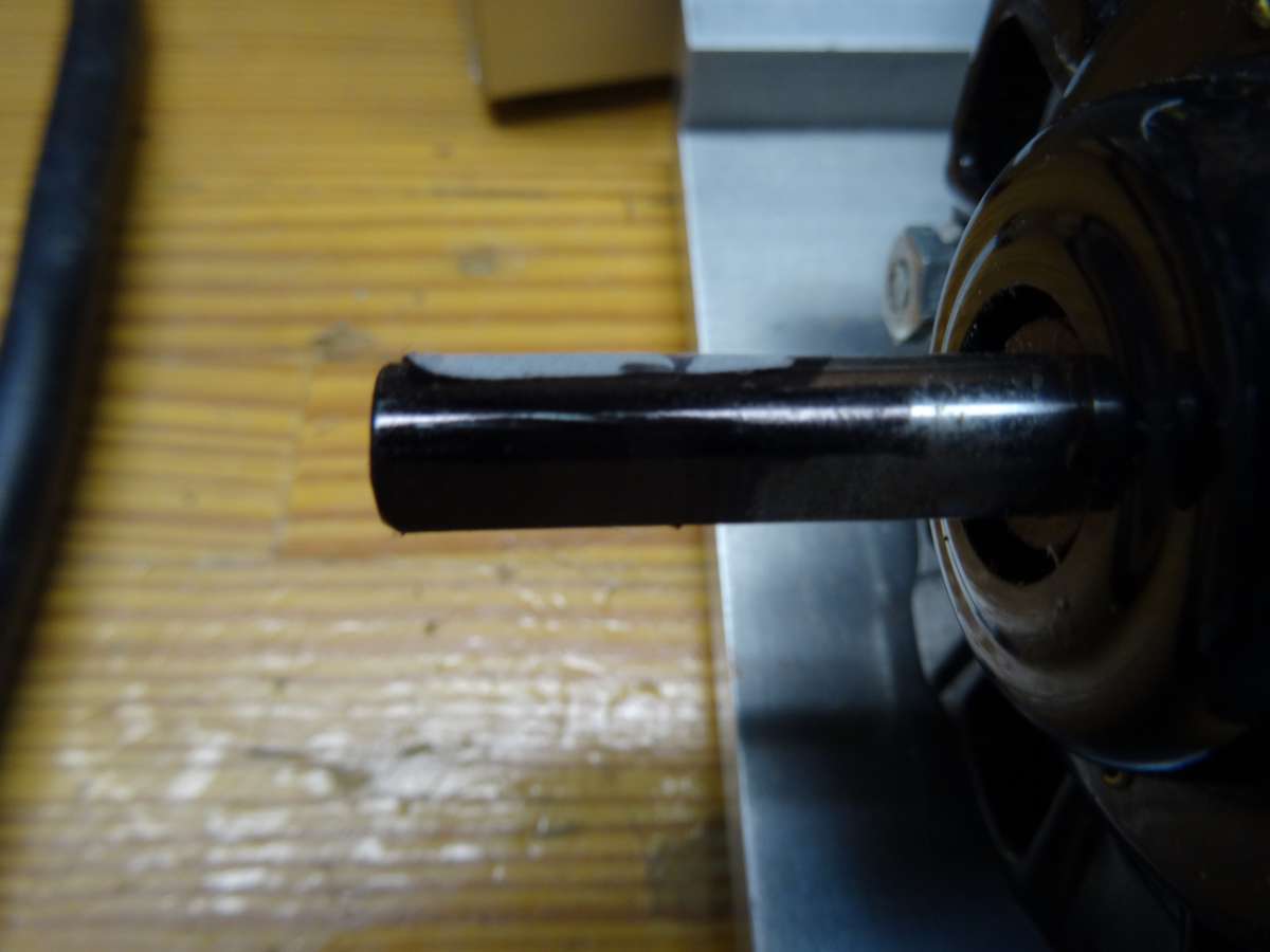

      I just got a non contact digital tachometer and tested it with a 900RPM ac motor with a 5/16 dia. spindle. I blackened the spindle with a magic marker and put a piece of the reflective tape, that came with the meter, on the spindle. I ran the motor at about 300 RPMs and got crazy results, just rounded, of 1000 to 3,000 RPMs. I thought maybe the black marker might a bit shiny and caused the bad results. So, I wrapped the spindle with black electrical tape…totally dull black, and got the same results. Has anyone tried this meter and what were the results?

          Try a much thinner piece of the reflective tape, say 3mm width, stuck on the end of the shaft as a radial spoke. I’ve found that works reliably.

              On small diameter targets strange results can be had due to multiple reflections. A small spot or stripe of white pain can work. Good luck. Noel.

                  I put a 1 1/4″ dia. chuck on the spindle and readings were still at least four times the spindle RPM. I even varied the sizes of the refective tape and no difference

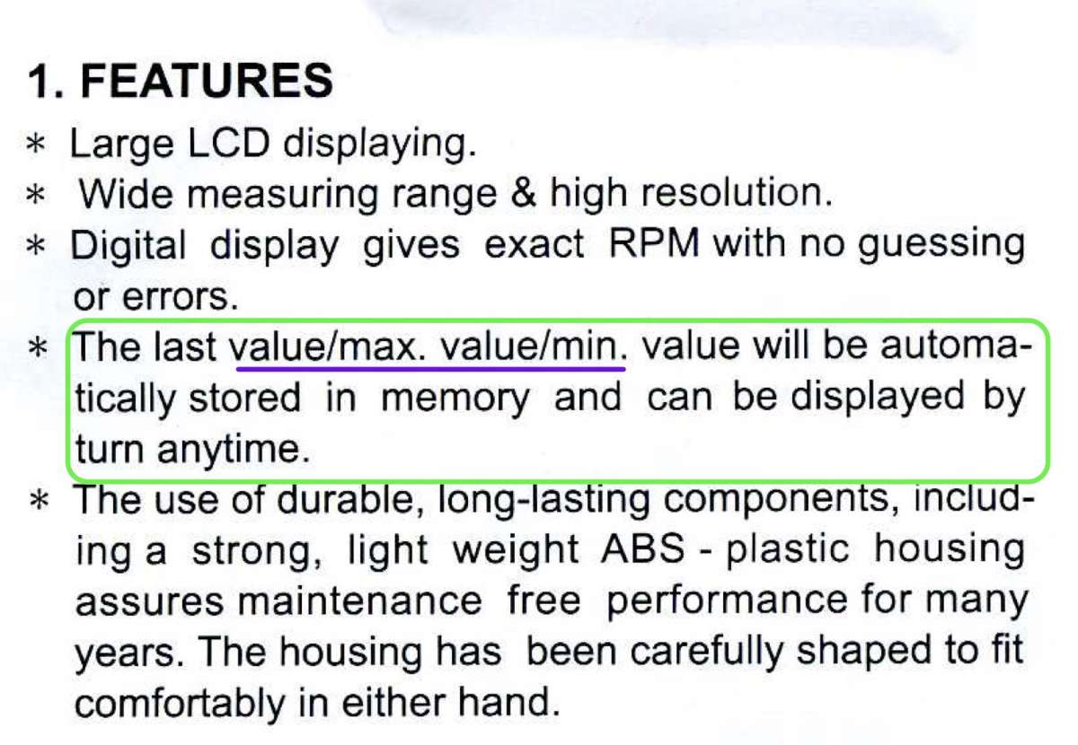

                            Just to confirm Paul’s point
                            IMG_1399
                            The displayed abbreviation might be ambiguous to western eyes

                              My experience suggests that the ‘memory’ feature might not work very well. Although the instruction leaflet supplied is badly translated and difficult to make sense of.

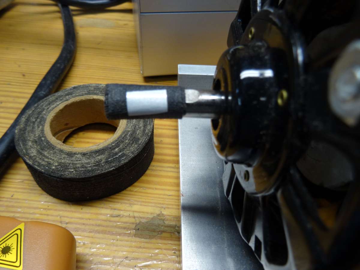

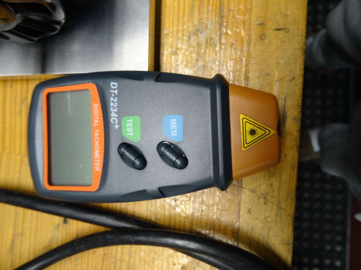

                                Here you go, no problem. 5/16″ drill shank, piece of tape about 4mm wide and it matches what teh lathe says give or take a rev or two.

                                  You got good results and didn’t even blacken the spindle. So I put a 3/16″ dia. dowel in my lathe chuck with a small piece of the reflective tape and with the lathe set at 2,400 the result was 2,600, but I had to rest the meter against the cross slide. The results varied holding it by hand. The problem measuring the motor maybe that the spindle has a flat and only about 1/4″, with no flat, sticks out of the housing face. So, even thought the spindle is blackened the edges of the flat edges may be causing the problem. So I wrapped the spindle with black tape….no edges, and the results are still way off for this 900 RPM motor.

                                      I have such a meter and to get good and repeatable results the spot (mine has a spot, not a line) has to be smaller than the width of the reflective tape. Than it gives plausible results. I mainly use it to check once in a while the RPM of my dremel engraver, CNC router (ER11 collet) or the lathe spindle.
