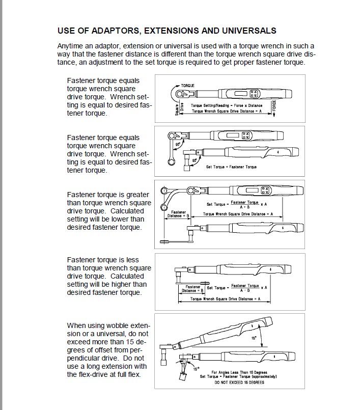

      Gents,
      After trying the Chinese cheap nasty collets I have ordered a set of Rego-Fix ER25 collets. Beans on toast for a month at least. In order to make them last for as long as possible I would like to use the c correct torque. I didn’t even know there was a torque spec bit there you go.
      I was looking at this spanner thingy. Will it work? Seems to my amateur newbie mind to measure torque aroind the wrond axis. I need it measured around the green axis but coupled with a conventional torque wrench it would measure around the red axis wouldn’t it?
      Will this work?
      Thanks, Mark

          It would depend on the position of the lever you use with it.
          Torque is force x radius, so if the lever were at 90° to the C spanner it wont be far off.
          Phil

              Mark, two things. One, you would have to allow for the additional moment arm because of the extra offset, and make sure you always inserted the square ended wrench in the same relative orientation.
              Second, somewhere on here, I think it was Joseph Noci reported that tightening the collet nut with a single wrench can make the collet run slightly out of true, what you really need is a way to provide a balanced couple. I've provided myself with a socket that fits an ER16 collet so I can do this, but I'm not sure if sockets are available to fit the funny notched nut arrangment you show.

                    People like Norbar tell you the formula to use for their torque wrenches (it varies from tool to tool) when using an offset tool like this. It is necessary because you can buy spigot connections for welding your own fitting onto. I have had flat ring wrenches heated and bent then cut off and welded onto spigot connectors and set using a torque meter so that they can be used around obstacles. A suitable torque meter and connection is the easiest way to set a torque with an extended tool.

                          Looking at the Norbar site they now have an app for calculating the result of extending the torque wrench.

                                    Formula can't be that hard? As torque=force x distance, surely it's just:
                                    actual torque = indicated torque * (distance from handle to pivot point)/(distance from handle to drive square)

                                        The second drawing is the clue here as Phil P said in the second posting. Thanks, that's a handy diagram to have.
