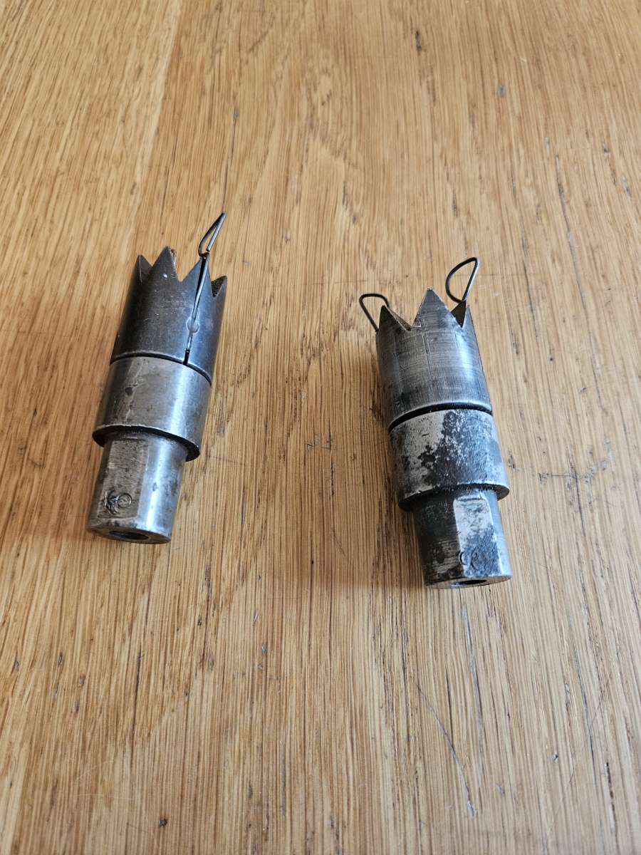

      Quite a long time since I’ve posted on here but hoping someone could shed knowledge on this pair of tools I picked up with some others in a box?
      20250924_10072420250924_10071620250924_100734
      I think they are some sort of revolving tailstock centre for woodworking as the tops spin on what seems very smooth bearings. They have the flats on the fixed end which have had a retaining screw wound down on them.
      Would be interested if any one here has ever seen anything like them.
      Thank in advance for any info
      Damian

          @hollowpoint
          Yes for woodworking. Rose or drive prong I think.

            #817222
            Nicholas Farr
              @nicholasfarr14254
              Hi damian, I guess those prongs will dig into the wood to a certain extent, depending on how hard the wood is, and the springs would help release the wood from them, without undue damage.

                #817233
                Bazyle
                  @bazyle
                  The springs would hold small dowels or squares used for pen making or lace bobbins while the work is being tightened.
                  #817239
                  Vic
                    @vic
                    I’ve been wood turning for some years and I’ve not seen anything quite like these before. Superficially they look somewhat similar to a Crown Centre but with the addition of those strange wires. Quite dangerous for any turning work I would have thought?
                    #817251
                    Dalboy
                      @dalboy
                      Like Vic I have been wood turning for years and have never seen anything like these, I also make pens and again not used in that part of wood turning.
                      At first, I thought they were for putting a chamfer an end of a rod and the wire springs to help centralise the rod, but there was not any sign of cutting edges.

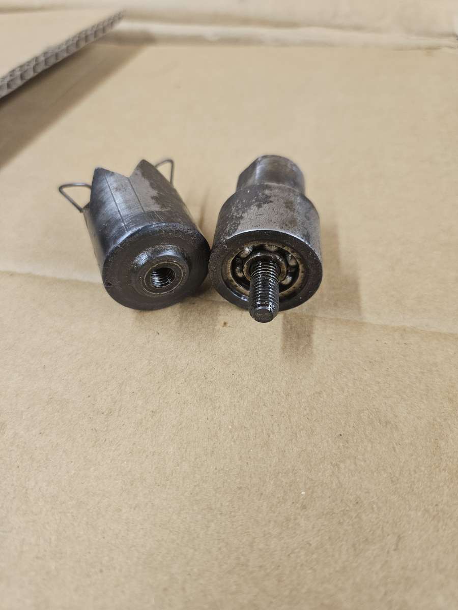

                          @damiannoble34800
                          Out of interest I unscrewed the top to expose tge bearing. If it was for chamfering it would be solid all the way through.

                          bernard towers
                            @bernardtowers37738
                            Similar to clockmakers chamfering tools except for the spring

                                  #817307
                                  Diogenes
                                    @diogenes
                                    I think the shell is spun and the die drops over on a hinge – it has to persuade the upper 1/2D edge of the case to ‘fall over’ – so it has to be free to rotate with the shell…

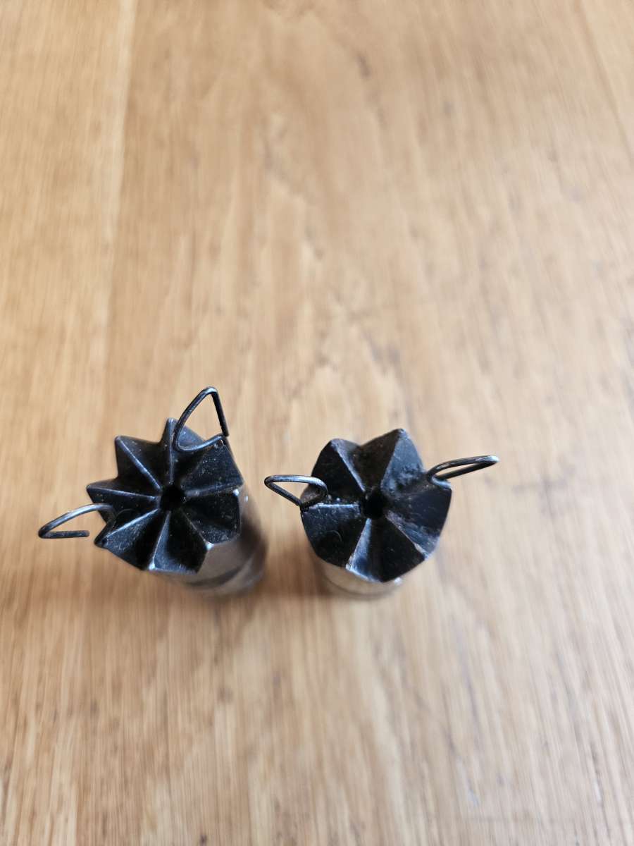

                                              #817372
                                                Fascinating, I presume for star crimping as on the right in this photo ?
                                                starcrimper
                                                Just a thought, but maybe the bearing means they’re from a cartridge manufacturing machine, not a simplified home hand-loader.  The machine spits an endless supply of crimped cartridges out automatically, and the spring wires are part of it’s feed/ejection mechanism.
